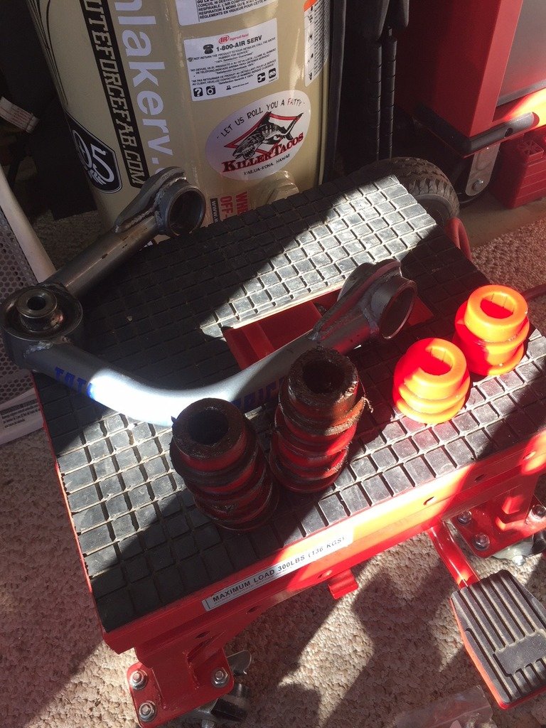

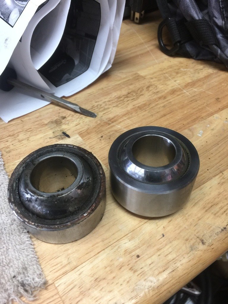

    Just rebuilt mine, like brand new nice and quiet smooth UCA!! Love it!
    8C3D2211-AFD7-4A3E-B0E0-44EA45F790A5_zps_f5c659da9d408f92b6f9bbca2ace41e220403cde.jpg
    mcharfauros and stronghammer like this.

    replace the uniballs....i had same issue. All good now for me, see pics above
    JKU3000 and stronghammer[QUOTED] like this.
