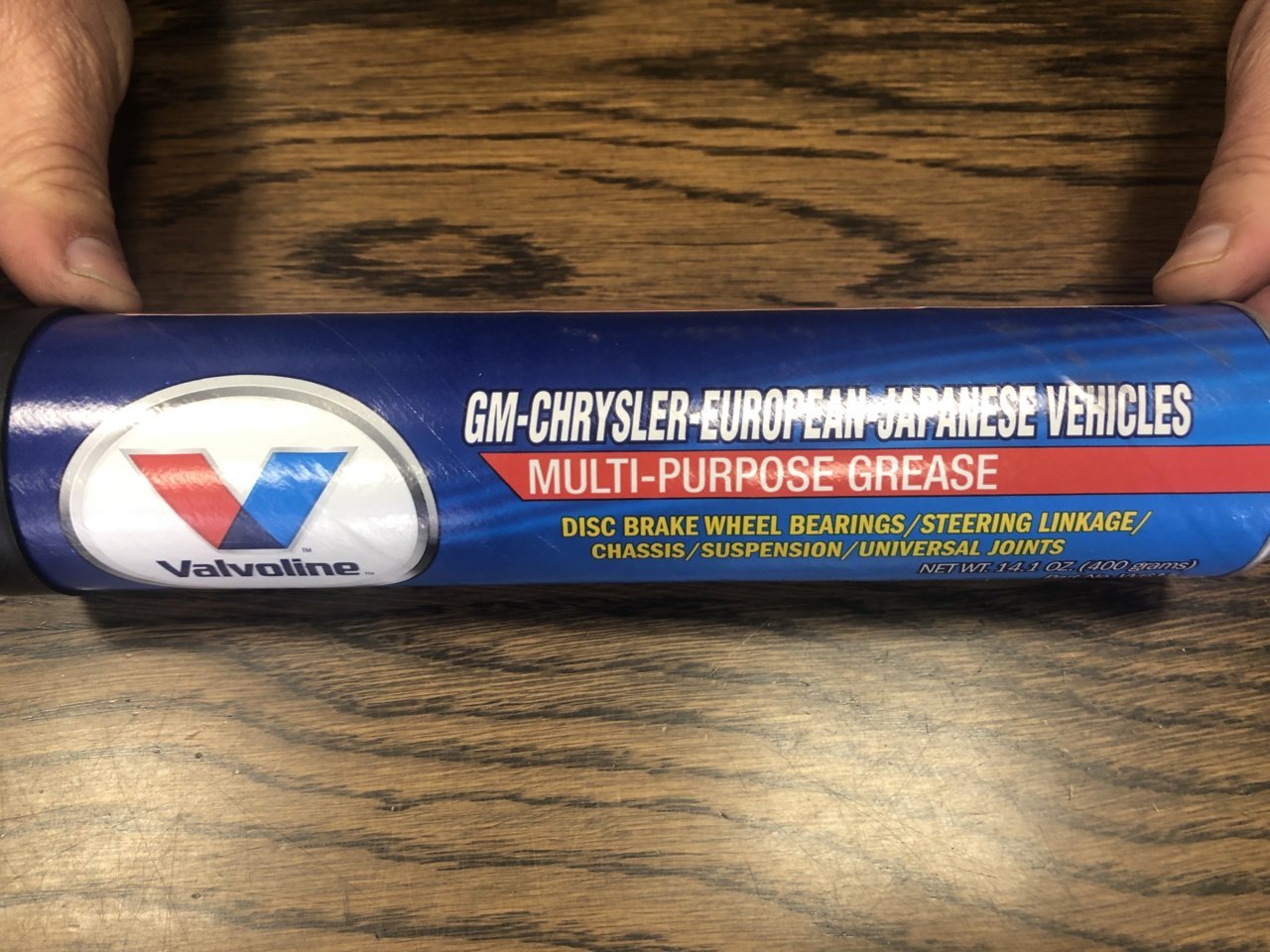

    We don't have experience with this grease but it looks like it could work. A little googling shows others using this on Urethane Bushings

  15. Jun 10, 2019 at 9:50 PM
    #55
    BOMBS
    BOMBS Well-Known Member
    Jun 22, 2018
    #257154
    1,418
    2017 Black Tacoma TRD Off Road
    Just used that grease to lube up my UCA for the first time yesterday.

    1/4-28 for our zerk fittings
    A few customers have reported good luck with the valvoline suspension grease.
