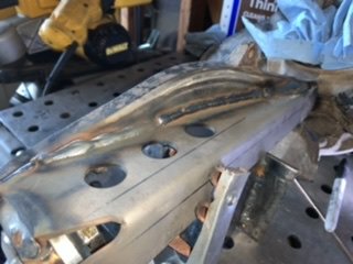

    Definitely take them off the truck before welding. Make sure you clean up the weld area really well with a flap disc. Take your time.
    Here are some pics of some spindles a guy had doner while they were on the truck and they were all bad. Sent them to me and I was able to fix them for him.
    If you like, send them to me and I'd be happy to weld them up for you. I'm pretty cheap and I enjoy welding them up.

    Thanks for the offer bro!
    It’s much easier for me to pull em off and weld same day. Yikes, those welds hahaha. Def done that though when visibility is bad. Just slightly off of the joint. Glad you fixed em for him.

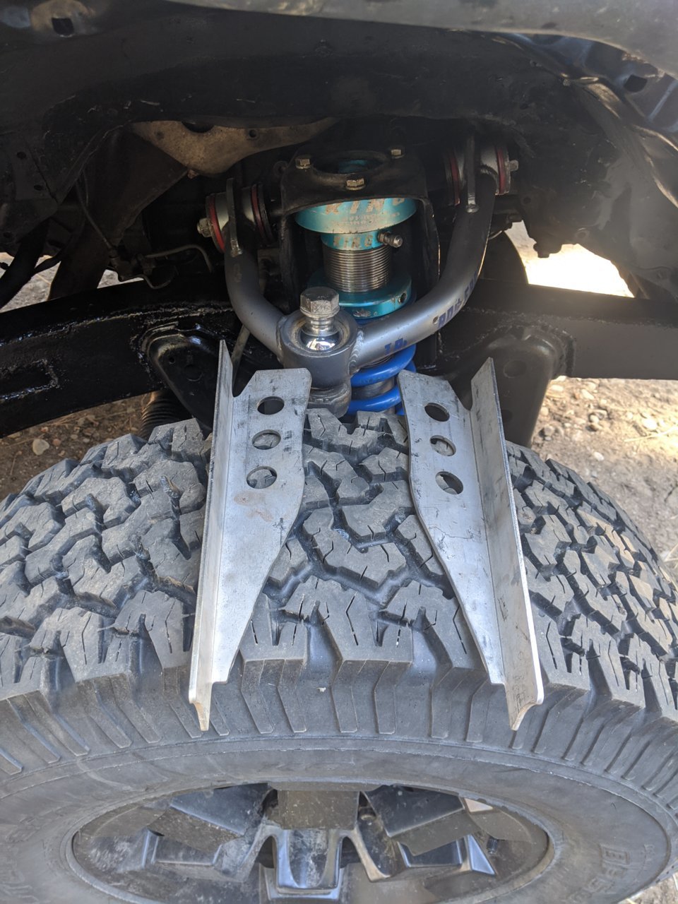

  16. Oct 18, 2020 at 11:30 AM
    #16
    frenchee
    frenchee Favorite Member
    Aug 4, 2015
    #161024
    2,127
    Oceanside CA Area
    2003 Tacoma TRD Double Cab 4x4
    Converted to 4WD DD VW MK6 TDI
    Well was a pain in the ass job, as expected without getting the right pullers haha.
    Got it done in a day though. Couldnt pull the upper ball joint taper so removed the UCA with spindle attached. Set it up on two blocks and hammered it right off. Last time I did it with a three jaw puller and it was an explosion. This time didn’t have the patience.
    Couldn’t get the right cups on the upper ball joint press fit connection at the spindle so cut the shaft off of it and made something work. Hit it with buddies impact and it slowly pressed out.
    Weld wasn’t bad at all. As some said the fitment was “off” but I didn’t really wanna open can of worms and start grinding. Touched it in couple spots but just welded gaps. It’s a ducking spindle reinforcement don’t over think it. You can easily mig or tig the gaps. Some were 1/8 some maybe 3/16 but I clamped where needed.
    One thing to note is for the ICON UCA the bottom puck that supports the press fit spindle insert on the spindle is quite large. On one side the gusset was touching. Could have grounded the puck a little, but I just welded the gusset on with it touching. With these reinforcement and ICON spindle inserts , you just have to accept they willl never come out.
    We installed icon UCA as well

    The rigging buddy came up with to hammer offf upper ball joint. Was easier than fucking with the puller I had.

    What back spacing do you have on your wheels? I have OEM FJ trail team wheels and they are super close to the gussets.
