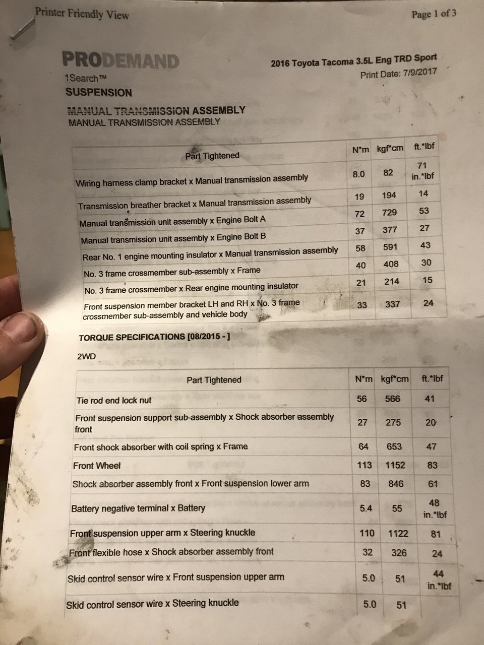

    Hi TW community,
    Does anybody have reference material that states what the torque should be for the rear shocks and front coilover assembly for the top and bottom nuts?

    Hopefully its the same. Maybe i should have done the research BEFORE i took the old one off. Now i just have the truck on stands....lol

    Btw, the torque for the 2nd and 3rd are different in some areas. The rear shocks attached to bottom axle housing for instance 2nd gen is 74ft lb the 3rd gen is 43ft lb.
