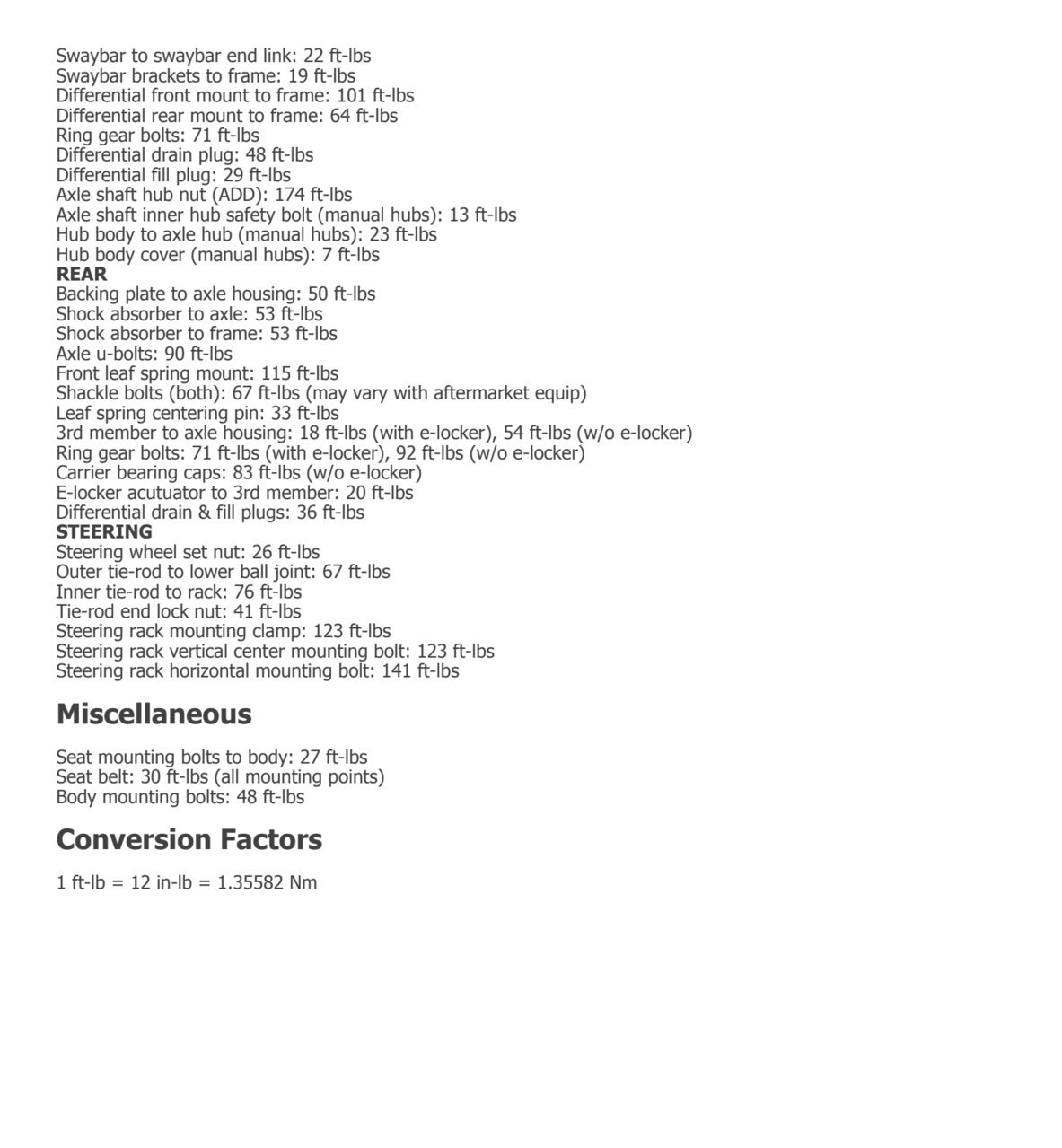

    The brake caliper mounting bolts are 90 ft/lbs
    Here you go, I keep these 2 sheets printed out and laminated in my truck...they come in super handy

    It's not what I'd call "a lot" but it is pretty tight, for reference 90ft/lbs is the same torque you want on your u-bolts, and those hold your leaf springs to the rear axle lol. Lug nuts call for 83 ft/lbs
    To me 'a lot' of torque is like 175 ft/lbs and over, but it's kind of a matter of opinion really

    Also I really like the Pittsburgh 1/2" torque wrench from Harbor Freight that goes up to 150 ft/lbs, I use it all the time for a few years now and never had an issue with it. It's pretty cheap too, like 20 or 30 bucks
