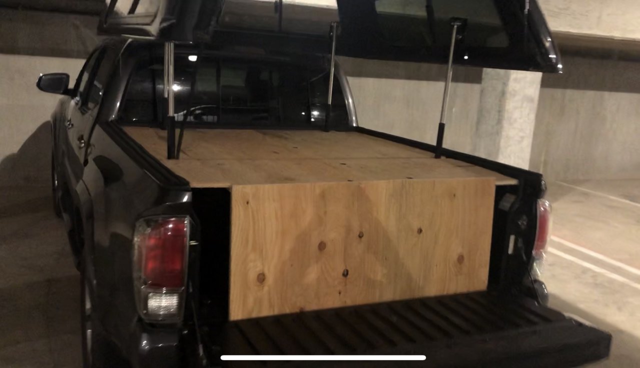

    I recently bought a 2017 Tacoma and I’m working on building out a camping setup. I purchased a Topper EZ Lift weekender package and just installed the lift system.
    I’ve also started the platform bed, but still need to upholster the plywood (with cheap carpet), and attach a hinge, handle and fold out support leg for the board sitting vertically in the pictures below
    Here’s a picture showing the 2x4 supports and how how I cut the boards. I wanted multiple pieces to be able to take it apart / remove it easily.
    I’m wondering if anyone has any general suggestions for me related to the EZ Lift and / or setup in the back.
    Also, I’m wondering if anyone has installed an EZ Lift system and a roof top tent?
    Thanks in advance!

    what are the 2x4 supported by underneath? They look like they are floating lol
