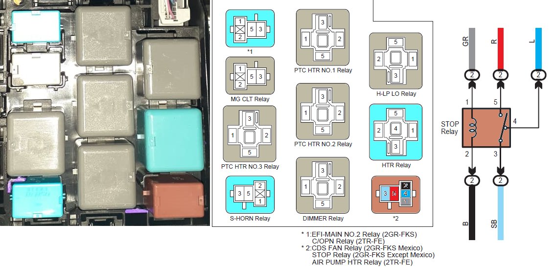

    They might try to grab at the relay for the stop circuit? @caribe makaira do you happen to know where that sucker is located? Might be in the engine bay relay box. I'd be fairly impressed if that's how this dealer rolls.

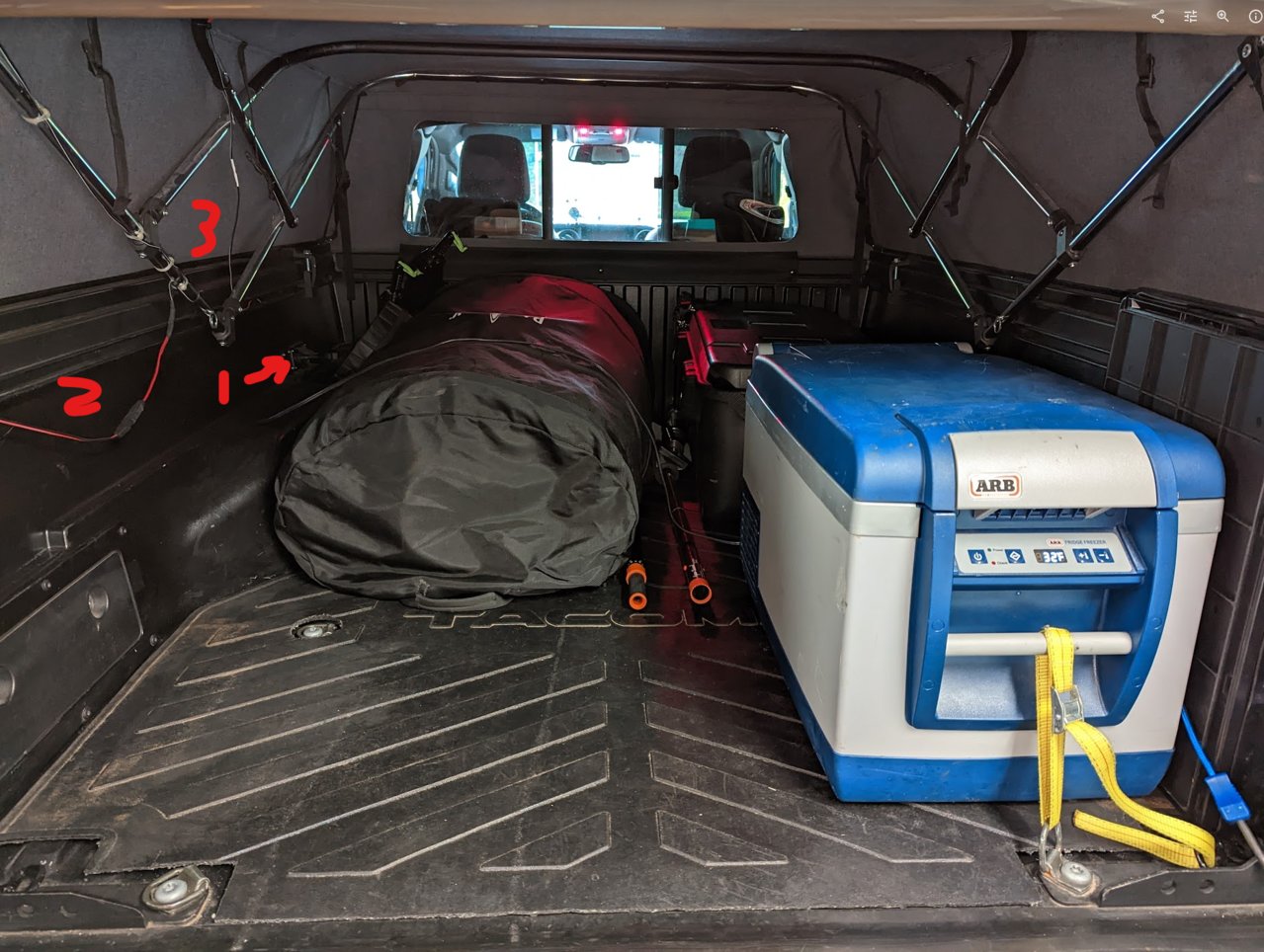

    That sounds psychoic. I do not believe that our tail lights are on the CANBUS network. Second, what is their quote for that? It has to be insane.
    For a low draw brake light, tapping the circuit has been done over and over again. I don't recall an issue posted here.
    For bed lighting, yes. Tapping off of the battery is the usual way. But, for them to do it, your going to be in it for more money than it is worth. I've been running a fridge and my mood lighting off of a simple Dometic harness. It was easy to install.
    Just my opinion.
    For fun:
    1 - Dometic panel
    2 - Brake light harness with disconnect
    3 - Mood lighting pigtail

    EB1 has the brake light, but I don't know why you'd go to there to grab it. It is the same wire as in the back of the truck. The brake lights are not canbus on these trucks. The main concern is just drawing too many amps, but assuming you are just talking about a regular brake light, you'll be fine.

    Depending on engine typeL=:
