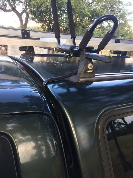

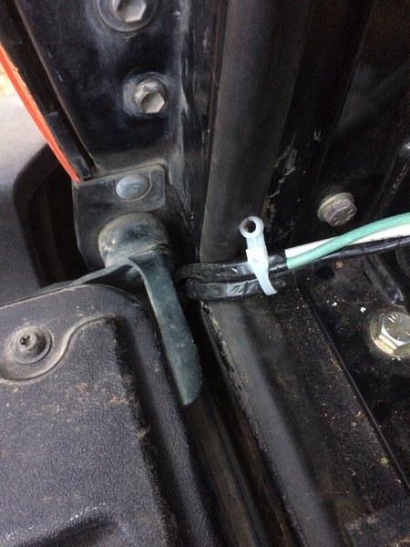

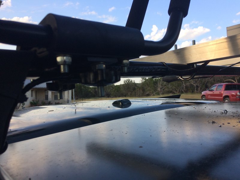

    Here's how i ended up running mine in between the cab, along my cross bars, down along the frame, and into the back of the shell

    I am still using this setup. Ran the wires in between the cab along the frame rail to the back. But i then rerouted them up through the drivers side bedside cubby.
