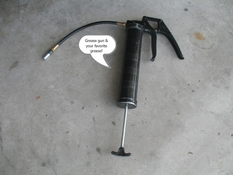

    get under it and have a look. look for the zerks at the u-joints. may not be exactly like this one, but similar. all you will need is a grease gun and some grease.

    You'll at least have greaseable u-joints at the front. All you need is a decent grease gun, and a set of sockets (to remove a small shield).
    Some guys use a needle nozzle to get at one of the zerks that is trickier to access, but I had no trouble getting to it without the need nozzle.

    I use Lucas Marine Grease (NLG #2) on everything. Drive shaft, lawn tractor, boat trailer etc. Some people get several guns, other swap out the grease in a single gun between lubs. I have one gun, use one grease on everything. I forget the brand (don’t think its important) but its one that takes the large 14 oz. cartridge, and has a larger handle so I can pump some pressure. A flexible grease hose/head helps getting in tight places.

    No. Superlube is PTFE base; you need a NLGI #2 lithium or calcium sulphonate base grease.

    Not much too it.
    Clean the zerk.
    Keep pumping grease until you see new grease appear out all 4 seals.
    Wipe off the excess.
