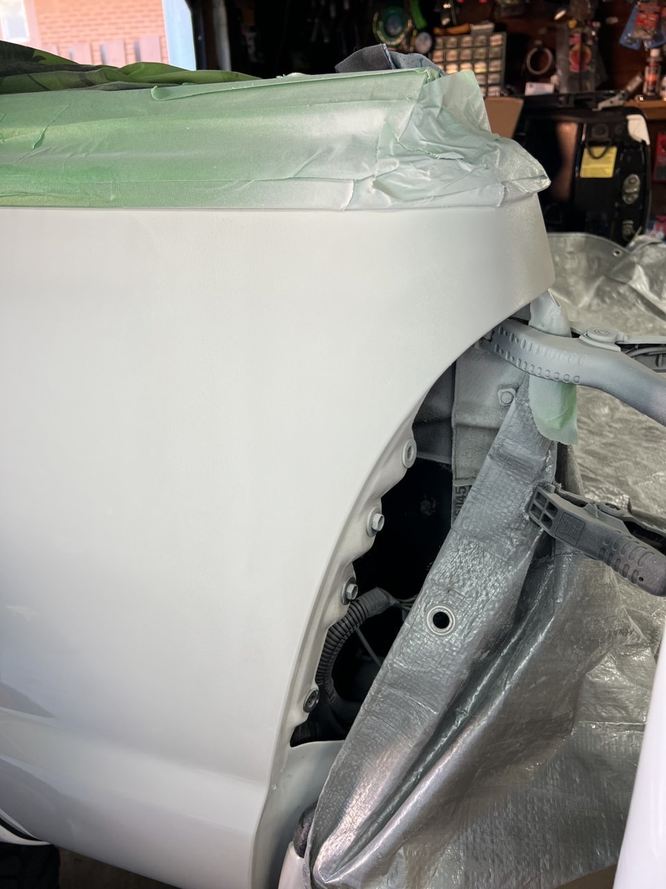

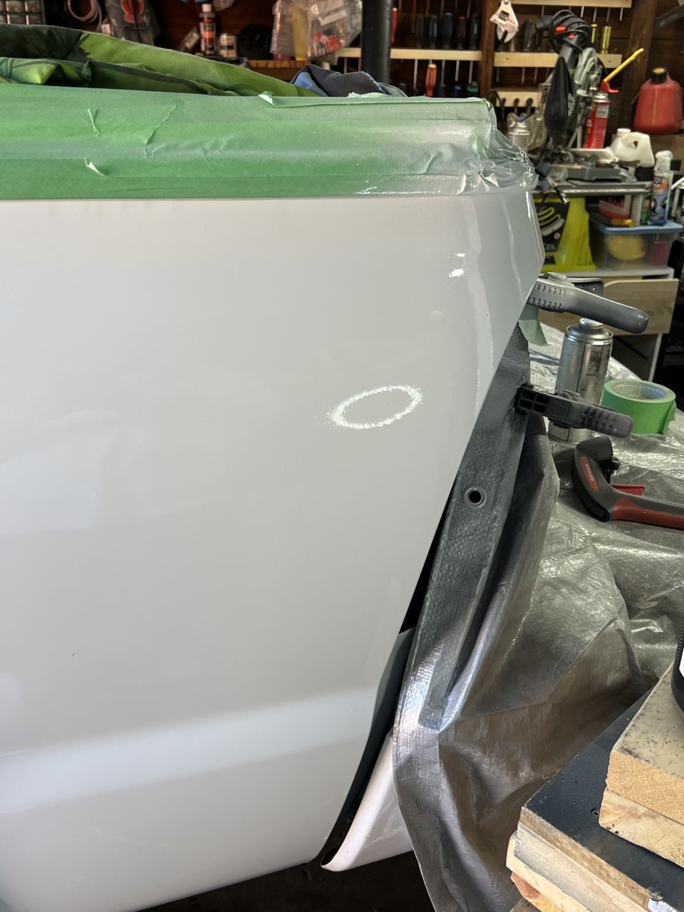

    That can be easily fixed with 2-3 cans of base coat and a can or two of SPRAYMAX 2K clear. Since it’s the roof, doesn’t have to be perfect.
    All this using spray cans.
    EB9CE6A5-81A4-428D-B708-8D5549313D1E.jpg B6D06F3A-298F-47BF-BC0A-37203DED2697.jpg 6CB788C5-200F-4473-A250-198887999147.jpg

    Personally, this is what I would do, since it’s such a big panel I would get an orbital sander. Keep in mind, I’m not a professional at all. :)
    - sand 320-400 grit sandpaper
    - Primer, 2-3 coats…start light.
    - Wetsand the primer with a block sander 600-800 grit
    - 2-3 coats of base coat
    - 2-3 coats of 2K clear
    This is optional, once it’s cured, you could wetsand it with 2000 grit, use an orbital buffer with a cutting pad and a rubbing compound for a flawless finish.
    The results are without wetsanding, just used an orbital buffer with a cutting pad using Meguiars Rubbing Compound.

    Gives you guys and girls an idea how much I had to paint to blend in with the OEM paint.
    9ABF1CF4-7C83-417A-BC75-858CF23EA218.jpg EB456E77-C78C-4E96-BB78-03D86E56B961.jpg
