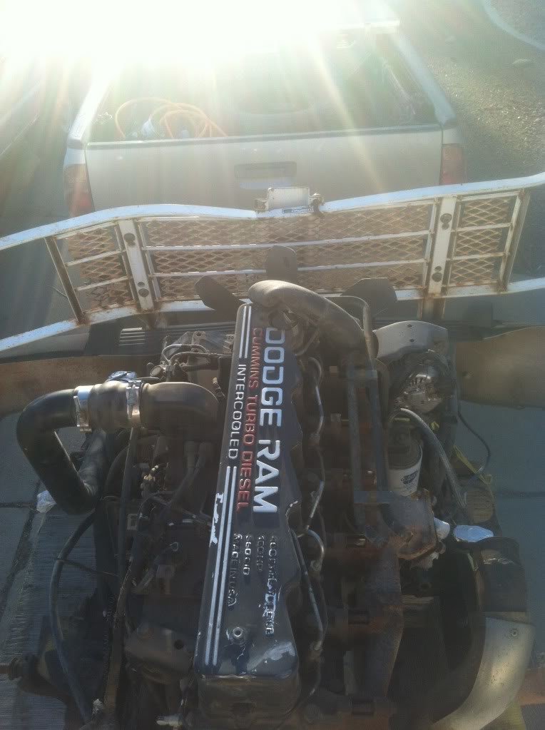

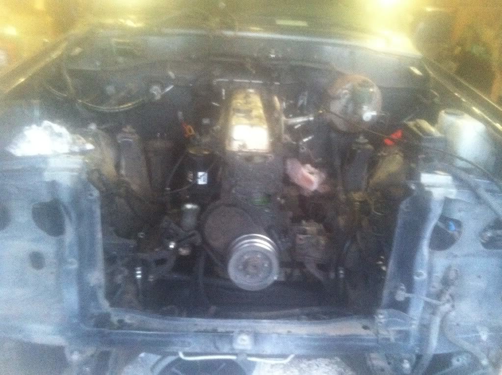

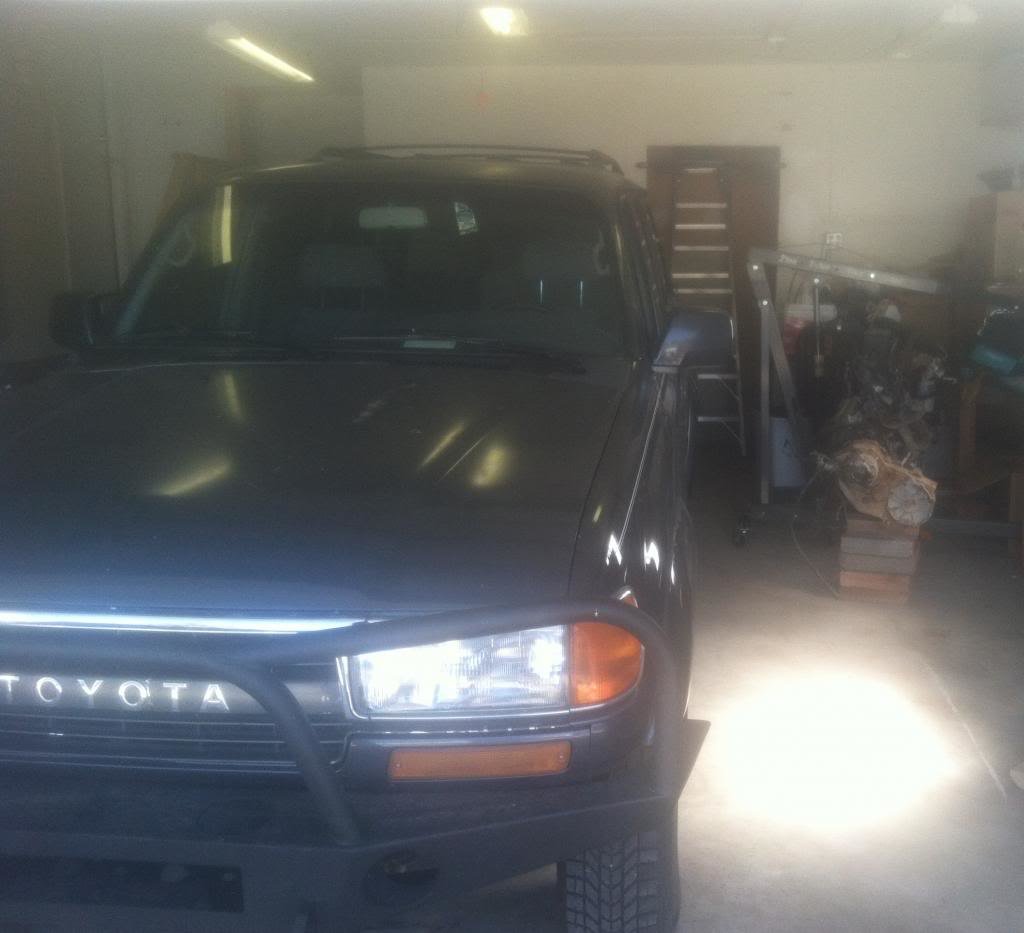

    that's the goal for now-ish
    This is going to be slow going for a number of reasons.
    Pictures!
    She's almost ready to come out. That's all I've got for now. Nothing too exciting.
