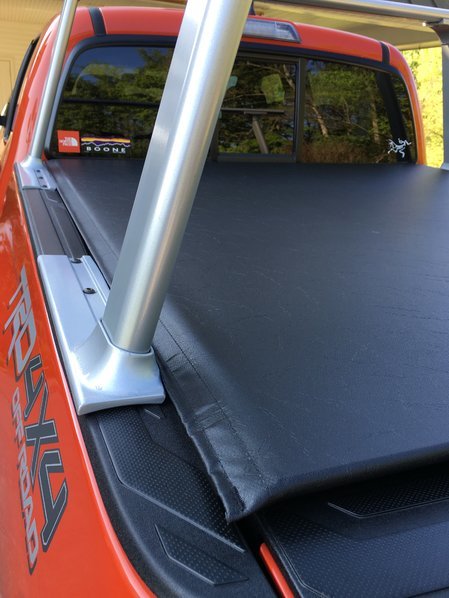

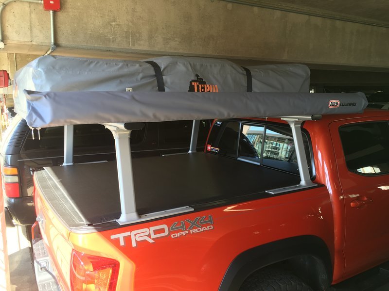

    It's the basic Access Tonneau Sport cover. Was 225ish. Nothing fancy but I wanted a cover that sat inside the rails in order to use a bed rack in conjunction and this is the only one I could find that would work.

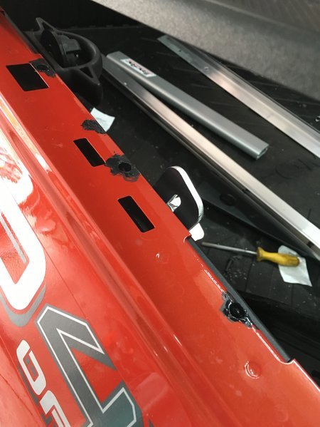

    It's a custom set up based off the basic universal TracRac system I picked up at Home Depot. I had to modify the feet by cutting the 90* bends off of them and drilling through the bed cap. It's fix mounted with 3 button head bolts in each foot through the bed cap. Once the feet were mounted we cut the vertical bars down 7-8" to make it cab height. It's taken quite a bit of work but I'm very happy with the end result. It allows me to run the tonneau cover to keep things in the dry and secure and still have the rack for carrying the tent and camping stuff.

    Nice. Thanks for the pics. Gotta decide if that's the route i want to go.
