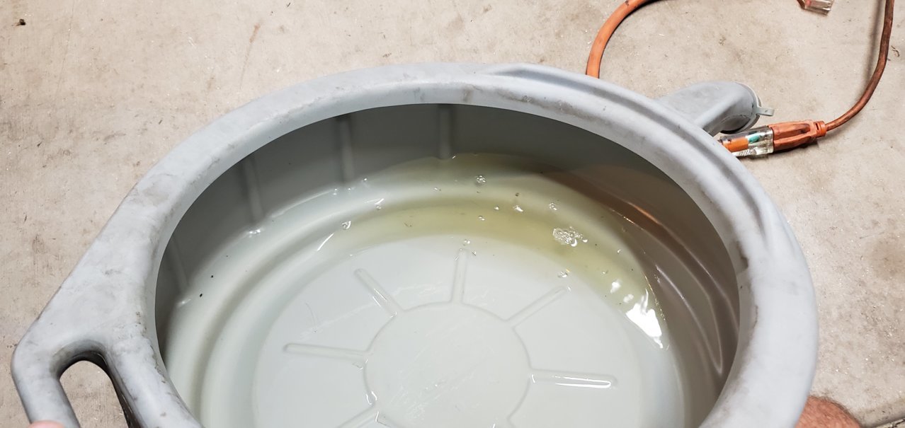

    My 2015 has had a stinky evap since I purchased it (used). Last year I treated it with a Subaru AC refresher kit (the same as Toyota but cheaper and was available on Amazon) which helped the smell until a few months ago. Being curious I decided to check out my evap with an endoscope to see if I could visibly see anything. I pulled the blower fan and sent the camera inside. To my surprise there was a collection of small leaves and debris packed into the end of the evap channel
    I used a mini vacuum accessory kit attached to my shop vac that I taped to the camera. I used a cut up wire coat hanger to then scoop the leaves and suck them up.
    The leaves and everything underneath was pretty nasty. I'm hoping this was the main source of my stink smell. I'd imagine they get wet every time I run my AC
    However most importantly I wanted to test the Toyota recommended method of cleaning the evap coil through the drain tube. I squirted about half a can of FJC 5914 foaming cleaner up the evap tube while watching the evap coil from the inside with my camera and I did not see any foam hit the evap coil. I found this very surprising. At this point I taped the foaming cleaner tube, the endoscope and the coat hanger together so I could guide and aim the foam directly onto the evap coil. I attached a video of the application below
    https://photos.app.goo.gl/suTkoCYSMQ4Ln3V4A
    I'd recommend anyone applying a foaming cleaner to use this method - pull the blower fan/motor and apply the foam directly to the coil.
    I collected the cleaning agent into a drain pan and it looked pretty nasty
    I'm hoping this helps with my stinky AC problem. I try not to run recirc and I turn the AC off about a mile from my house but lately the sink has been pretty bad. I'll report my results as time goes on
