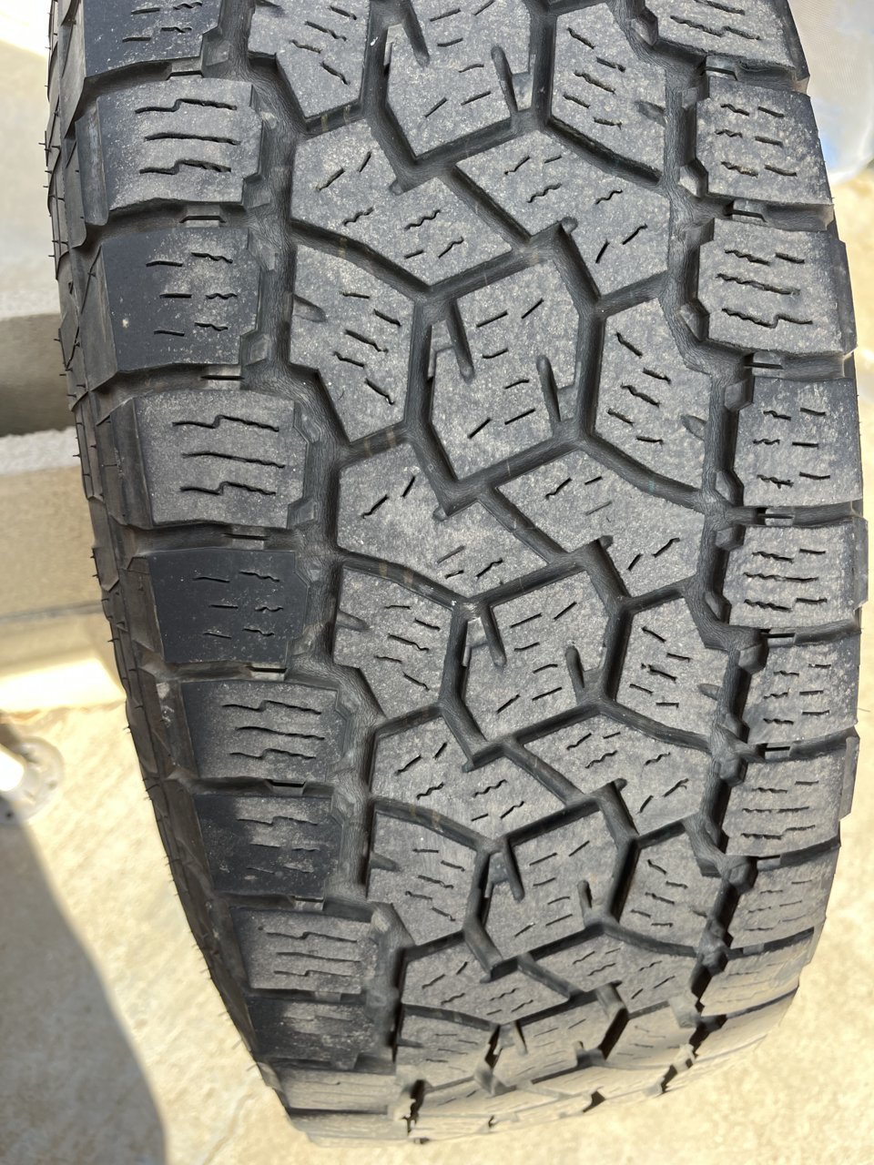

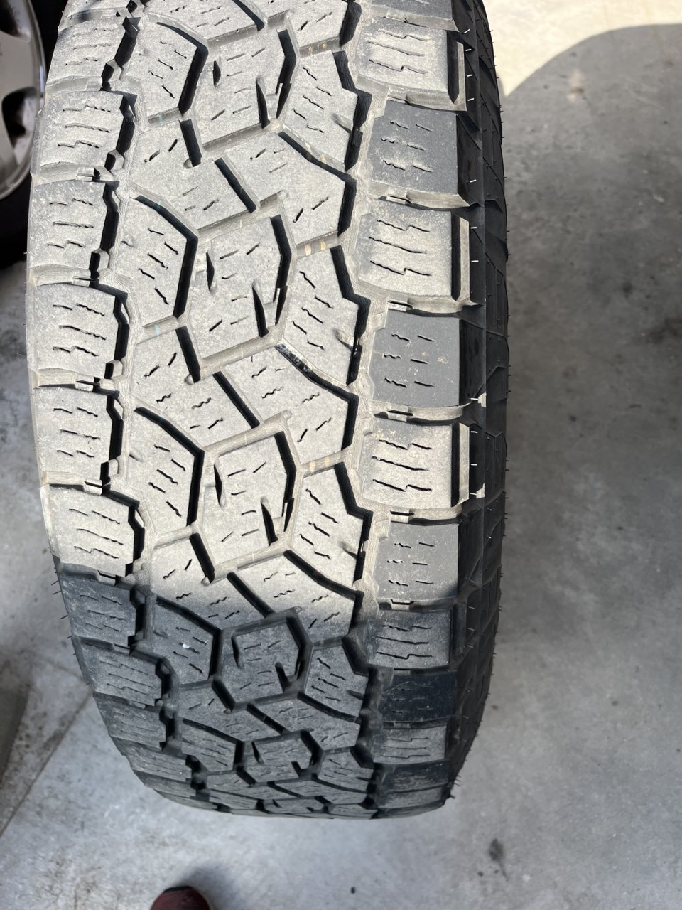

    Hello TW looking for some help on my road noise tires are wearing inner spots are showing check out pictures.
    Toyo at3 about 3 years old just recently starting making noise
    Any ideas shocks looks ok to me .
    Psi are 30 all around
    Tia 968FB5C3-AD34-4582-9CF5-407194EEB562.jpgB224081E-F86B-4FEE-97A9-6B3C00001C69.jpg 0C2C8F86-BDBE-476B-9041-A5152077C4C0.jpg
    Top two pictures are front tires and bottom picture rear tire .

    Alignment, it's the reason why tires wear evenly/unevenly.
    That and wrong tire pressure; this one would be easy to spot if that was the case.

    I would get an alignment either at a suspension specializing shop or the dealer but If that happened over 3 yrs (mileage reference would be preferred) and the truck drives fine I would rotate the tires more often. Because of the low caster design of these trucks it's kinda hard to make them drive nice without causing tire wear because the toe largely is what stabilizes these trucks at speed. Rotate your tires every 5000kms with the fronts crossed to the rear and rears straight forward.
    Make sure the cupping (high spot of the edges) is on the trailing edge and it'll take down the noise. Try a couple psi less of tire pressure if you want but honestly I wouldn't really want much if any less than 30 psi because I find the fuel consumption exponentially increases

    All tires do this to some degree, all terrains are just more noticeable. Along with alignment, doing a cross rotation to work the cupping away will help with its remaining wear. Reversing the tread direction helps prevent this.

    Usually when I see this type of wear, it's because of infrequent (or improper) tire rotations. Bad shocks, alignment, and worn suspension parts certainly can be culprits as well, but I haven't seen that nearly as often as simply not rotating the tires often enough.
    Your alignment looks OK to me, judging by your pics (other than the cupping, the wear looks pretty even across the tread).
    Rotate them like was said above (rear tires straight up to the front... front tires crossed over to the rear) and they should eventually even themselves out.

    Pics look like under inflated thus outer edge wear and not rotating or slight camber issue. Front to rear is standard as crossing on truck radials may cause vibration or wandering feeling but many opinions on that so do what your tire store recommends as they are the ones who will be replacing early under a prorated warranty. Are you running E range because that's another issue as heavy sidewalls.
    On my 4x4 tires running at 35 always and 265/70R16 ran stocks, Michelins, and Wildpeaks that way for even wear all SL rated.
    As for rear if the spring alignment pins are broken off or not in hole then an issue or the rubber or poly spring eye bushings are falling apart misaligning springs - should be able to see all these issues.

    What you are experiencing is perfectly normal. Tires on the front wear more on the tire edges. Every time you corner you have more weight on the outside, or inside edge of your front tires causing them to wear more quickly there. If turning to the left, the outside edge of the right tire is getting more weight on it. The inside edge of the left tire is doing the same. Once that uneven wear starts the tires slap the pavement and make noise This is much more pronounced with aggressive off-road tires. Barely noticeable with street tires.
    The best you can do is rotate often. When you place the front tires on the rear they will wear more in the middle and eventually even out the tread depth all across the tire. By the time the tread is the same across on the rear tires, the ones on the front are starting to do this. If you wait too long to rotate the pattern sets in and you'll never correct it. This is where you are. You're stuck with the road noise until you buy new tires. Rotating them still helps a bit since the loudest tires will go on the rear where you don't hear them as much.
    You wasted money on the alignment. Unless you hit something that knocks the alignment off it is never needed.
    Bad shocks can cause the same issue, but it would be a lot worse than what you have. And you should get 100,000-150,000 miles out of your shocks/struts.
    I'd run more than 28 PSI. Tires that soft are more likely to cause the edges to wear faster. I keep mine at about 35 PSI.
