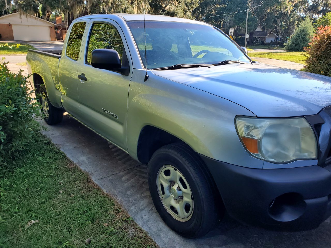

    Here's a pic of the truck. And sorry about the poor description on my part. It has the stock tires/wheels on currently. Looking to upgrade. Advice was no lift but definitely on the wheels and tires. That's where I'm stuck. Based on the rims my son has picked out, one shop recommends a 235/65/17xl Geolandar. Another suggests a 16in Faulken (No other dimensions provided unfortunately).

    On the stock wheels a 235 75 15 will fit with no rubbing, bumping, trimming, etc.
    Clean the wheels and paint them is a budget option.
    Collect 'spare tire' wheels (for proper fit) clean and paint is an option (see pic below)
    Buying new wheels means being VERY careful of the wheel specs in terms of backspacing/offset. The closer they match the OE wheel, the more confidence you have in their working right.
    The tire calculator will help compare overall diameters of sizes. But the wheel fitment is just as important.
    BTW, you might find info in the 5 lug forum that's helpful too.
    PS, CeraKote headlight restorer will fix those lenses right up.

    My taco is similar to your son's. I'm currently running Yokohama geolandar go15s in the stock 215/70/r15. Clearwater Bill gave a great suggestion if you want to save money. I've seen several with 235/75/15 tires on the stock rims and they looked pretty good.

    If your Tacoma is 2WD, looks like it has 15's and is 215/70/15. If its 4x4 looks like it came with 16's 245/75/16.
