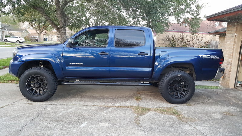

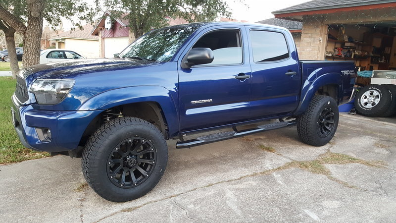

    I'm getting the Bilstein 5100 3" lift. I ordered some wheels 18x9 -12 offset with 275/65r18 tires. I'm really hoping I don't have to trim anything. There are so many different answers on tacomaworld.

    How did that setup work out? Can you post pictures?

    It worked out really well. It looks agressive and rides great! I did have to trim a small amount of the inside fenders. At full lock, in reverse, it rubs the frame a bit. It's really not too bad and I can live with it.
