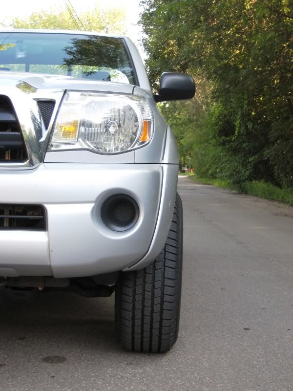

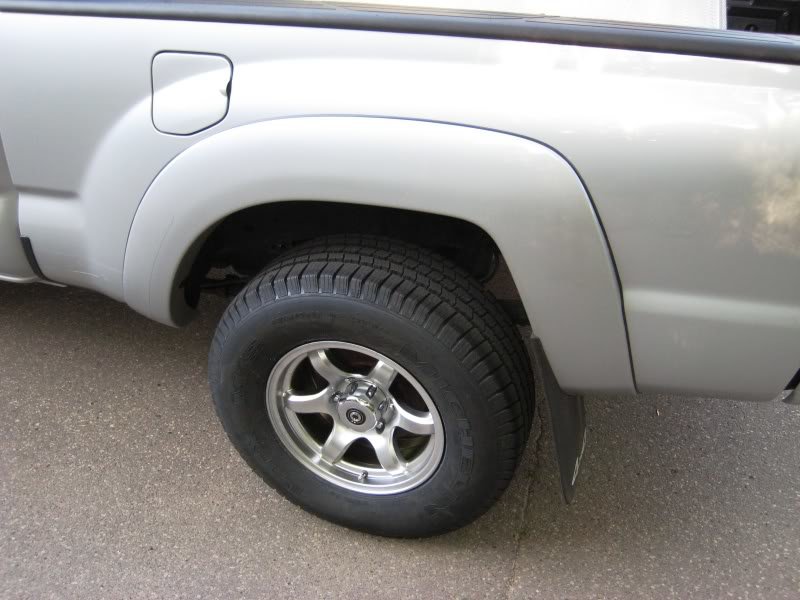

  13. Aug 10, 2009 at 6:43 PM
    Fast1
    Fast1 [OP] Well-Known Member
    Jun 24, 2009
    #18875
    1,029
    Minneapolis, MN
    2021 TRD Off-Road Access Cab
    just took a few so far when getting the tires installed..

  14. Aug 10, 2009 at 6:51 PM
    Tacoyota
    Tacoyota senile member
    Jul 22, 2009
    #20028
    2,931
    North of Cali, South of Canada
    08 4wd
    4.56 gears, rear trutrac,DT header, 235/85r16 Duratracs, 2nd filter pulled, inter.wipers, Cruise control, Factory alum. whls/winter tires(2nd set), Afe pro Dry-S , Dumbo eared flaps cut down.
    Those Konig and michelins are a nice lookin setup! Amazing what photo # does,now I'm wondering if my tpms in stock steel will fit stock aluminum wheels now. I'm buying a set of sr5 wheels from another member , I never considered tpms not transferring directly.

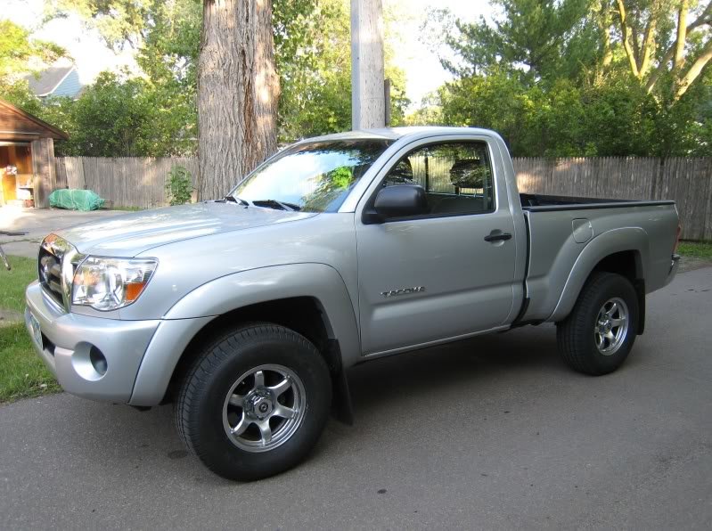

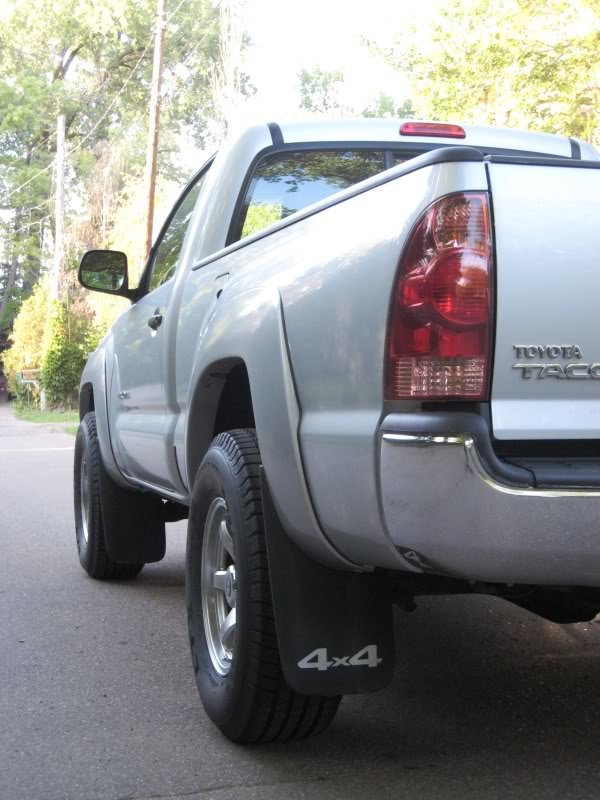

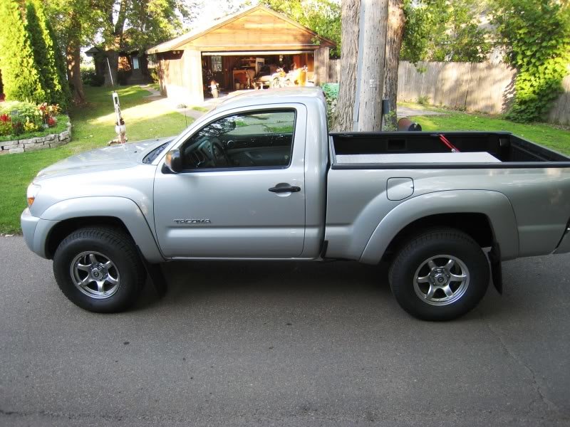

  17. Aug 12, 2009 at 3:09 PM
    #17
    Fast1
    Jun 24, 2009
    #18875
    1,029
    Minneapolis, MN
    some photos.. stock suspension for the moment.. thats next on the list for upgrade
    at least an idea of how the Konig wheels look with 265/70-16 tires
  18. Aug 12, 2009 at 4:04 PM
    #18
    Tacoyota
    Jul 22, 2009
    #20028
    2,931
    08 4wd
    Sharp lookng combo!They have good proportions under the fender, not too wide not too tall or skinny for that matter.My tire searching has been around the 75% sidewall, think ill widen it to 70s also. Goin for a snow/ice set, but good on gravel n such.
