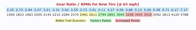

    When I moved up in tire size (from 265/65R17 to 285/70R17, see ratio screen grab below) I also regeared from the factory 3.73 to 4.56
    For an '09 with a 2.7 I think you diff gear ratio might be 4.10, but I'm not sure

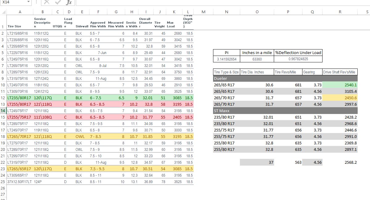

    So if your drive shaft is spinning 3100 in one minute and your gear ratio is 4.11 then your tires are spinning 754.3 times in that same minute (3100/4.11=754.3)
    Now you can multiply 754.3 revolutions by your tire circumference 7.82 feet and you get 5898.6 ft (754.3 x 7.82=5898.6) which is a little more than a mile in that same minute.
  10. Jul 21, 2021 at 9:40 AM
    Tsinajinii
    Tsinajinii Black Wood Streak People
    Jul 14, 2014
    #133888
    1,662
    Jamin
    AZ
    2011 DCLB 4x4 TRD Sport
    OME 885's paired to Bilstien 5100's, LR UCA's, OME Dakars w/ 5160's, Debadged Tailgate, TRD Stickers Removed, ARE Topper, Tailgate Theft Deterrent Mod, Mobtown Tailgate Skin, Light Bar in Hood Skewp, VIAIR OBA, Diaz Fabrication - T.H.R.B., Always on Cig. Outlet, BAMF behind the grill light mount with KC HiLites Pro Halogens, KC HiLites Flex ditch lights
    Here is a screen grab of a spreadsheet I put together a while back when I was looking to regear.
    I created this calculator in excel to compare drive shaft speeds of the factory 3.73 differentials to my new 4.56 Nitro Gears
