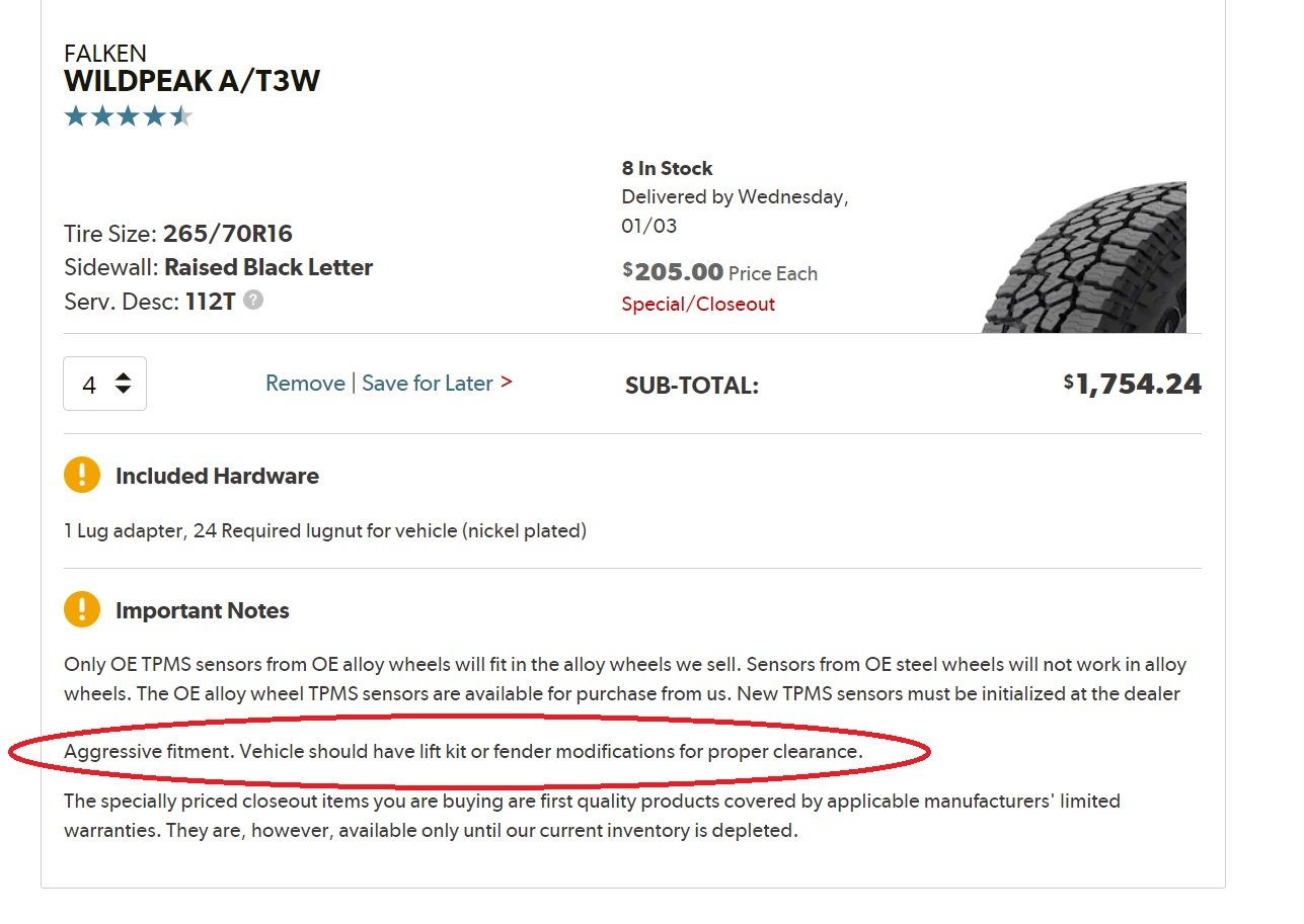

    Hello. I am interested in purchasing a wheel and tire package for my 2016 tacoma TRD off road. My stock tire and wheel size is 26570R16. I would like to purchase the Falcon Wildpeak A/T3W in the same size, and the 16"x8 granite alloy GA640 wheels. However, there is a warning during checkout on Tire Rack under the wheels that says "Aggressive fitment. Vehicle should have lift kit or fender modifications for proper clearance." My truck is stock but the TRD off road comes with a small aftermarket lift kit. Will this wheel and tire combo be a problem for my truck? I selected stock tire sizes while shopping.
    See screenshots attached.
    Thank you!

    This is contradictory. Is your truck stock, or do you have a lift? The TRD Off Road does not come with a lift, but you say you have an aftermarket lift. You need to clarify this for a proper answer, but also keep in mind that there are variations truck to truck and tire to tire. What fits one truck may not fit the next even if it's the same tire size on the sidewall.
    I had that issue on my Tundra. I bought the Wildpeak AT3Ws in the same size as another member with the same suspension, but his tires were Nitto Ridgegrapplers. Well, the Falkens were about 1/4 inch larger and I had rubbing that he did not. Just because somebody here says your fine it is still never more than a 90% surety.

    All that said, the tires will not be the issue. The offset of the wheel is. Stock should be around a +25mm offset and those wheels are a +01mm offset. That is pushing your wheels and tires out almost a full inch. You may hit your mud flaps or bumper when turning full lock, especially in reverse.

    Oh I see. I skimmed too fast lol. I'm assuming you're getting the message because it's a wider wheel with lower offset, although there are a ton of people on here running 16x8 +0. I'm sure you'll be fine.

    They are just covering their butt in case they rub.
    I got the same message from Canadawheels.ca when I upsized to 255/80/17 Wildpeaks.
    No issues....
