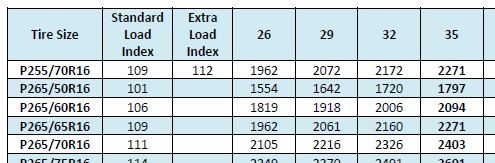

    Also - just for some other math based ideas - here is some more support - go to - https://www.toyotires.com/tires-101/tire-load-and-inflation-tables and download the Inflation Load Index document
    cut to P265/70R16 which will show a bolded 35 psi as the indicated pressure at 2403 lbs which is just under our load index of the Goodyear Kevlar at 2469 that is OE drop the load by the 1.1 factor for the ratings and you get 2245 or roughly 33 psi... now jump down to LT265/70R17 and see that to get to a similar load index of 2245 you would be under 45 psi. Point being, there is a definite change as you change size and loads and etc... if you watch tire wear, you'll learn what you need to need

    also - not only did the OP change tire size, he changed load... truck went from 265/70R16 P-Metric to an LT 265/70R17

    Guys and Gals, the recommended tire pressure from Toyota inside the door jam is ONLY if you are running P Metric tires with the same specs as the OEM tires. Once you change that label is pointless. The next thing to consider is the Load on the tire with GVRW. Every tire manufacturer has this documented what pressure their tire needs to be for the load it is going to be used on. Match that with the load you have. Period. No chalk, No seat of the pants feel etc. It is literally science.

    Yeah, that door jam sticker is for stock P rated tires... not aftermarket larger tires with a different ply rating. As nettleberger said he went from 265/70R16 P-Metric to an LT 265/70R17. That is why i said earlier that the door jam is for what tires the rig comes with from the factory.
