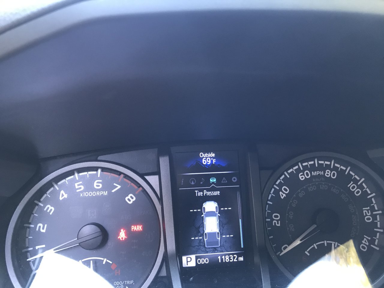

    I saw a few similar posts, but either didn't see a solution, or slightly different from my problem. So...
    Recently got new tires at a local installer. They put the OEM TPMS into the new tires. On the drive home, noticed that I had the --- for all 4 tires on my display. Did the reset button, drove the specified distance and speed. Still no pressure displayed.
    Went back to tire dealer. They reprogrammed. They could see each sensor and the tire pressures. Did the reset again, drove, nadda. They suggested that I take it to the local Toyota dealership since they "sometimes have problems with resetting Toyota sensors."
    Took it to dealership. Same deal as above. After a reprogram, --- for all tires on display, but could see all sensors and pressures on their programmer. They asked me to come back latter so they could dig into it further. Sigh*
    One last note. Went on a hunting trip. Aired down tires from around 35 PSI to about 25 PSI while I was on logging roads. Low pressure light came right on on my display. So it seems like there is some communication, but no pressures displayed.
    Any ideas before I take another trip to the dealership?

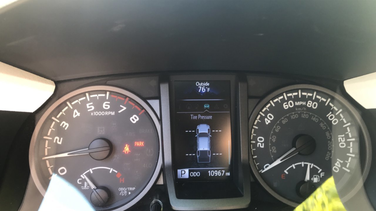

    I'm running stock tires / wheels and my display still says ---. It has been like that for almost a year

    Im kinda confused... if the tire pressure doesnt show up on the screen, then why am I getting a low tire pressure light? I don't know if my sensors are broken or if there is something wrong electronically. I manually checked my tire pressure and they're all between 29-31.
    Running stock wheels and tires

    I’ve been trying to do that all morning and it just finally went away. Luckily, the light went away but the tire pressure still isn’t showing which means the sensors are still working.
    something electronically probably broke and I have no idea what it could be
