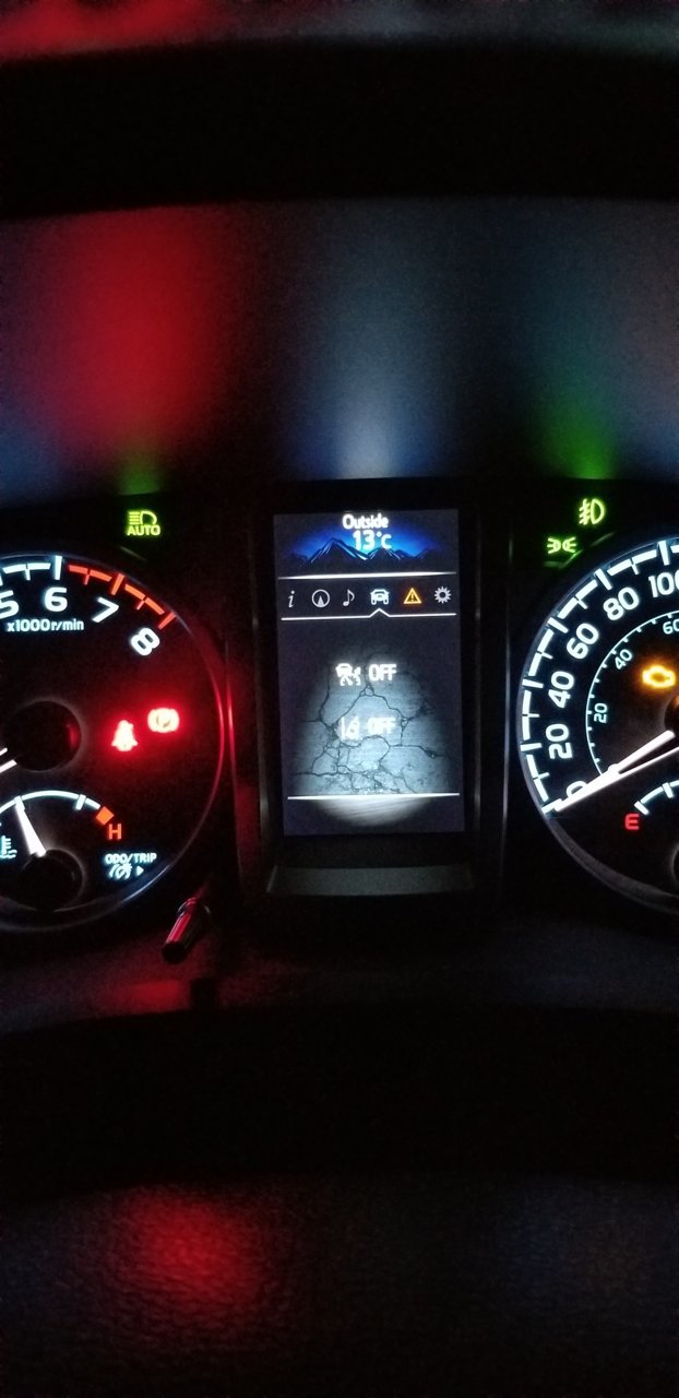

    Hey all.
    Just picked up a 2018 TRD Sport 6MT in canada.
    Do i have TPMS? Dealer seems to think so, but i cant get the pressure to display on the center display.
    Is this not an option on this model or am I missing something?
    Thanks.

    Did that... nothing all it goves me is radar cruise off and lane departure off.
    I hold down the customize menu and press yes, then it just goes back to the same screen.

    Hmmm. Just rechecked Pg. 96 of the Owners Manual?
    Not sure if this info is still correct. - Are your valve stems rubber or metal? Pretty sure that the TPMS devices need to have metal valve stems.

    Thats what i'm thinking... i dont think i have TPMS.
    I dont have this button either.
    Valve stems are rubber.
    I dont see the tpms warning light come on during startup either.

    Something's funky there. The 18 sport should have two screens under the little car icon: lane departure (as seen by your photo) and tpms.
    I'd take it back and have them check it.

    You pressed the up/down arrow when you were on this screen?

    Yup and it doesn't move.
    Just confirmed with the dealer i bought it from.
    Rubber valve stems and no "learn" button on the dash = no tpms.
    Im not dissapointed as i find it useless anyway... and saves me 300$ on my winter tire and wheel setup.
    I think it has to do with it being a Canadian model.
    Looked at a new 19 TRD sport in the showroom and it too had no TPMS.
