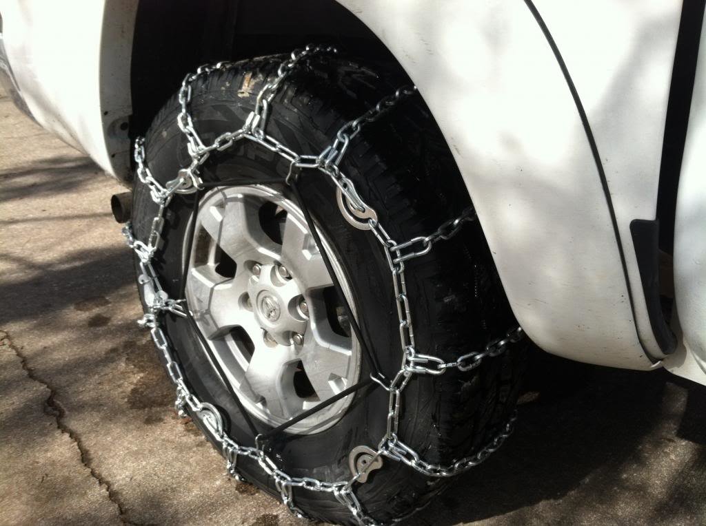

    I have these.
    http://www.tirechain.com/square_alloy_cross_chain.htm
    You'll have to be careful about the exact chains you buy, the heavy duty V-Bar chains probably won't fit and if you're running E rated tires they may not fit. I have P265/75/16's The chains I bought are a smaller 5.5mm chain, they offer a 7mm chain but I don't think it would fit.
    If not in extreme conditions or mud cables work surprisingly well on ice or light snow. If over 4-6" then cables are less effective.
