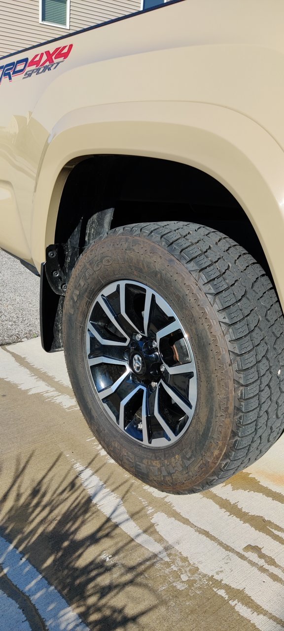

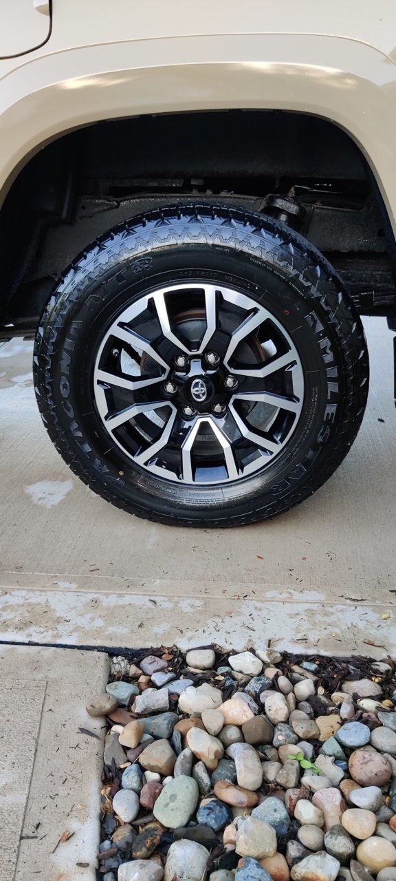

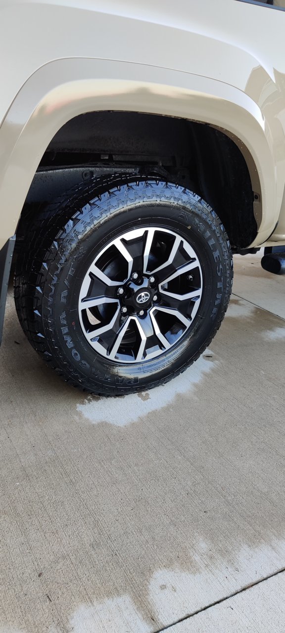

    Got these tires from Walmart a bit over a year ago and recently they have started blooming pretty bad. I had no idea what was even going on until I stumbled upon this term while frantically googling "WHY TIRE BROWN???"
    Before, these 2 are the best and worst looking of the 4
    After some minimal research I did the following:
    • Quick wash with soap & water
    • Picked up some PurplePower degreaser to remove the oxidation. I started out spraying the brush and scrubbing, but this took many passes & more scrubbing. Instead, I tried spraying directly onto the tire (while wet) and let it soak for about 30s-1m.
      • Note: PurplePower says on the bottle to not use on rims, so I did my best to avoid overspray, wipe off excess, and wash well afterwards. In the future I would probably not use it, but these tires were so bad and I tried with other products first.
    • Scrub tires with moderate force with a tire brush, let sit another 30s.
    • Rinse clean.
    • Quick wash rims with soap & water.
    • Hit rims with some wheel cleaner, I used some shitty Jay Leno Garage Wheel Cleaner I had lying around.
    • Rinse and dry everything.
    • Once tires were dry I hit them with a couple layers of shitty Armor All Tire Shine. (I have since picked up some Meguiar's Hot Shine that I will use next time.)
    The after photos look a little wet because they were and I was running out of daylight xD
    This seemed to work pretty well, and according to the internet as long as you keep them protected it shouldn't happen as bad. Hopefully this helps someone, let me know of your feedback or what products you would recommend instead.
