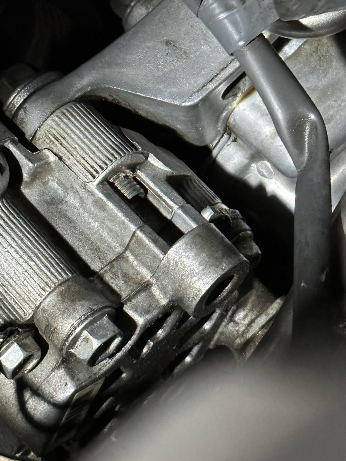

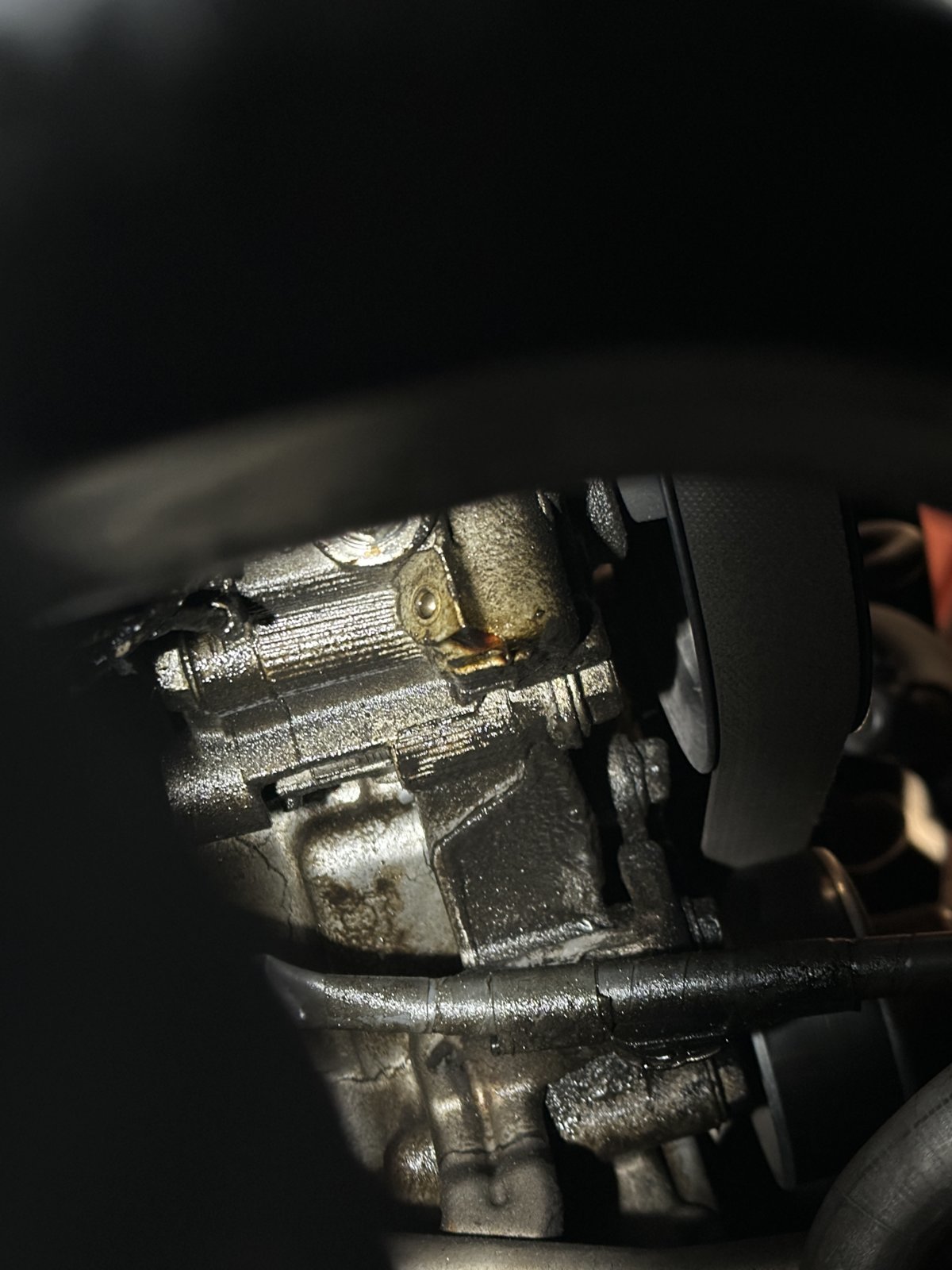

    Hi all,
    I finally acquired another Tacoma after selling my 2007 5 years ago.
    I purchased a 2016 TRD off road with 55k miles from a Toyota dealer. Beautiful truck that was babied by the prior owner. Two days after I brought it home I noticed what appeared to be an oil leak behind the power steering pump and dirt and grime in the area. Brought it to the dealer who cleaned the area and put dye in it and told me to return in a couple weeks.
    After some research on here I am concerned it is the timing cover leaking. The dealer includes a 90 day warranty so I believe they will cover it if that is the case. However, I am concerned with how invasive the procedure is to reseal the timing cover and am concerned something else will get broken during the repair. I would like to keep this truck for 20 years or so. It appears to be a small amount of oil leaking/weeping and I doubt it will be noticeable between oil changes.
    I am curious if any of you have had this seep and decided just to leave it and clean the area each oil change? Is there any harm in doing this and will the leak get worse over time? I appreciate your opinions.
    I likely would not have bought the truck if I would’ve noticed it at the dealer, but I missed it despite thinking I looked over at thoroughly.

    I would leave it alone, but what you can do is remove the power steering pump clean the area very good to make absolutely dry. Then apply sealant on the seam and let it dry overnight . Put the pump back and it should be fine . Other people have done this successfully. Remember that cover just gets oil splash, and there is no real pressure there . It’s definitely worth a try and I really think you will be fine . It’s not very hard to do and what do you have to loose ? Nothing except a little time

    Thanks for the advice on tagging. There is a 90 day power train warranty included and I just bought it last week, so it should be covered if their diagnosis also confirms it’s the timing cover.
    when I was in the first time, the initial thought was the power steering pump but now that they have put dye in it I have been watching it, and it smells like motor oil to me.

    I have a 2016 with the same issue. Unfortunately, it started after the warranty was up and there was no way I was going to pony up to have the timing cover resealed. I did what one of the above posts recommended and got the pump out of the way, cleaned the area really good and coated the seam with Permatex Right Stuff. I have checked it daily over the last few months and it seems to have done the trick. I also sealed the pressed in bearing that is in the block directly above the pump. Other threads said this might be the issue and it was the area I observed the most oil.
