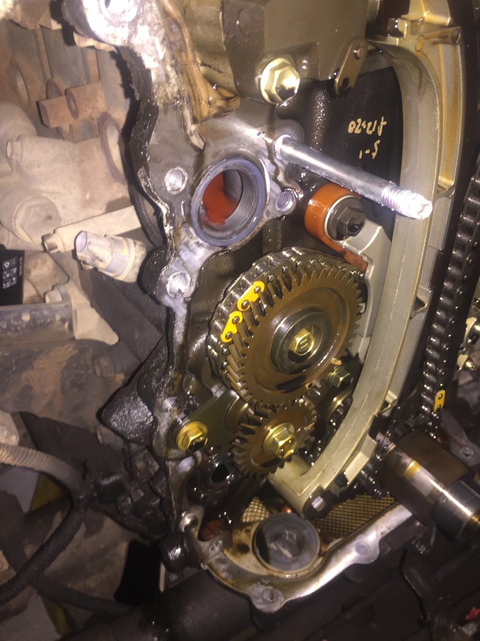

    7AA75C22-B21E-4CC4-AE2E-77AFA8699C87.jpg full]2486539[/ATTACH]
    Ghost or not the rattle was there at 1200 rpm and we’re going in for a timing chain set replacement.
    Not sure where the tensioner plunger should be but mine’s extended 3/8”.7AA75C22-B21E-4CC4-AE2E-77AFA8699C87.jpgHere’s the kit I ordered.

    Okay enough of the pretty pictures and disorganized posts let me recap to this point.
    I’ve owned this 2008 Tacoma with 150k miles on the 4 cylinder 2TR FE motor for 1 month before a distinctive timing chain rattle reared it’s ugly head. The motor had an excessive oil leak coming from the timing cover and jet black oil in the pan when I received it.
    From what I’m hearing this shouldn’t have happened unless the motor was possibly starved for oil or had not received proper oil changes, regardless I’m moving forward hoping this will correct the abuse she’s had.

    Did you find the cause of the "rattle"?
    Was the chain loose?
    Was the chain guides worn?
    From the pictures it doesn't look bad at all.
    While you have it down you should replace the Coolant Bypass pipe that is plastic under the intake. They have an updated unit that is steel. You can see yours in Post # 10, Second Picture is plastic still.

    The timing chain and guides had no damage or ware marks at all and when these new parts where installed the tensioner plunger was sitting in the same position as the old one leading me to believe there was no chain stretch or pulley ware either.
    The second chain, down lower and behind the first did have ware marks in the pivot guide but the other two fixed guides where like new. This assembly did seem a little sloppy which could have caused the rattle. The new tension plunger for this new set did appear to have less through when assembled indicating more ware.

    In summation I post. The timing chain rattle was in fact operator negligence. The engineers have oil pressure keeping tension on the chains and these tensioners will relax shortly after your oil pump sucks air giving you a subtle and not so damaging reminder to fix your leaks and pay attention to your fluids.
