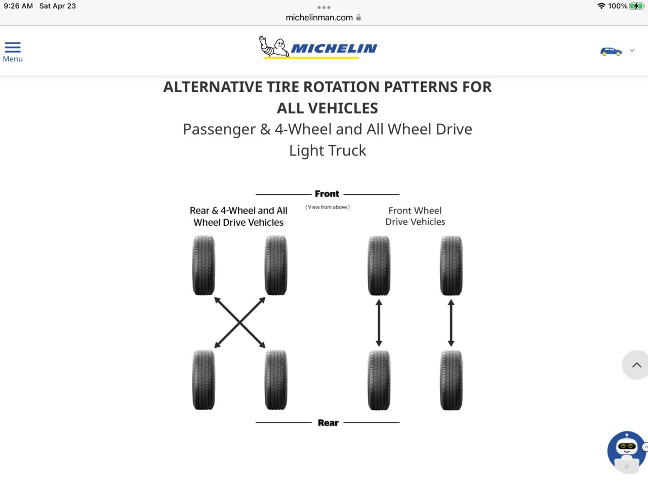

  9. Apr 23, 2022 at 6:30 AM
    #29
    spitdog
    spitdog Well-Known Member
    Sep 2, 2014
    #137440
    3,923
    2015 Access Cab V6 4x4 SR5 MGM
    The people who make the tires would disagree.95C778E6-A15B-4AC1-9B3A-BEA652B4BCC9.jpg
