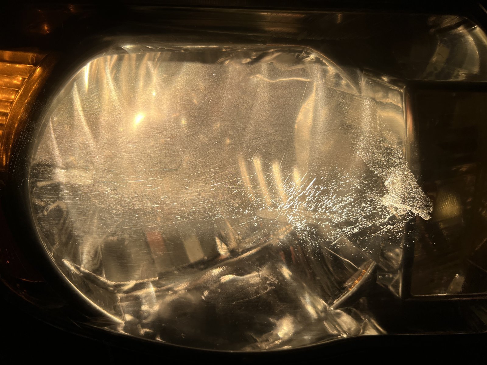

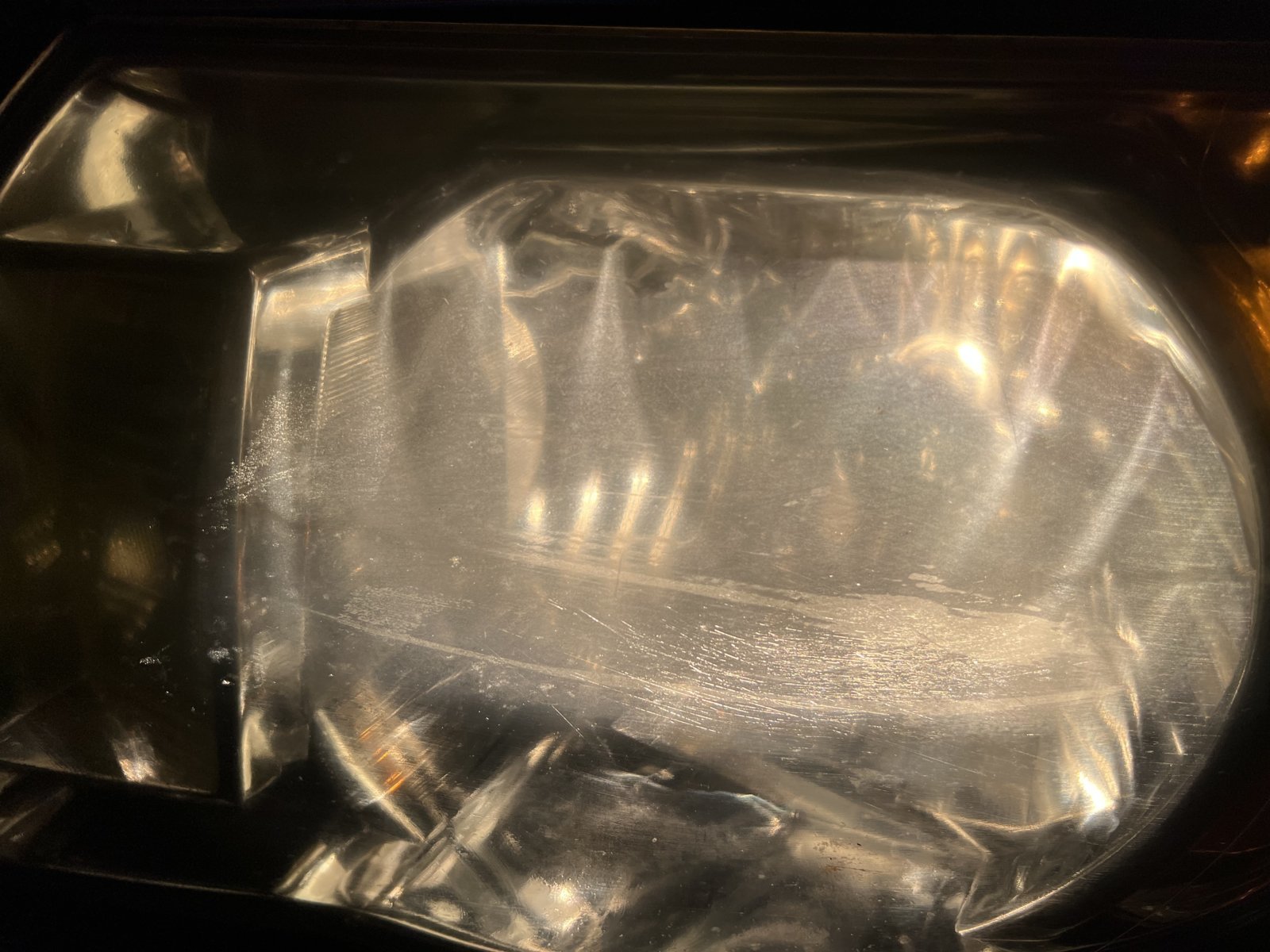

    The evenings are getting darker and driving home in light rain tonight I thought I really can’t see much at all. So I left the car in idle after getting home and took a look for myself from the front. The lenses look fine in the daylight and nothing was ever mentioned during the annual state inspection, but this looks pretty bad!

    All the micro scratches and dirt are far more apparent at night with the lights on, if they look fine during the day they may not be as bad as you think. Replacing the headlights with new OEM units is certainly the best route to go by far. But also, halogen bulbs dim over time, if you are still running old stock bulbs the output will be poor due to the bulb, not necessarily the assembly. You might consider trying a set of Philips Racing Vision +200 performance stock wattage bulbs first and then if unsatisfied get the new assemblies. Of course both together would be even better.

    You may be able to restore those lenses by wet sanding. If your goal is to order new housings anyway, you might as well give it a try. As others have stated, replace the bulbs too.

    wet sanding and a 2k clear rated for headlights can do wonders

    I did this with 1k rusto clear - does not last and makes a bigger problem than before. Get a rattle can of 2k clear at minimum or take them to get sprayed at a good auto paint shop - otherwise you’ll be doing all of that for not much benefit, maybe 3-5 months or thereabouts.

    A Cerakote headlight kit and a little patient work will likely make a big improvement in the lens.
    It did on mine. Inexpensive and they have you tube application instructions

    You can polish those lenses and get a few more years out of them. The sun here in GA is a lot harder on stuff like that. I polished the lenses on my 07 three times before they became too yellow. I replaced them with OEM housings about a year ago. Cost me $550, but the difference is amazing plus it almost looks like a new truck now.
