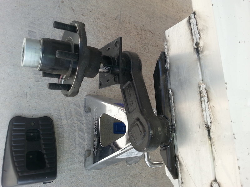

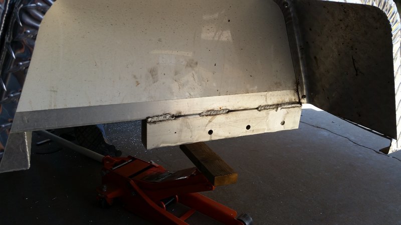

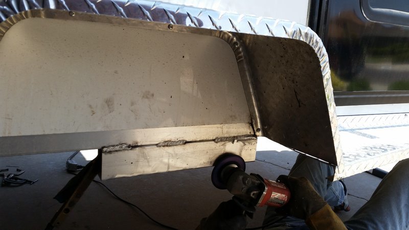

    Had to remove the angle and add 3" of 2x3 to the front of the mount.
    All ground down and holes drilled for the suspension arm. Didn't really have to but I did sleeve the bolt holes for good measure.

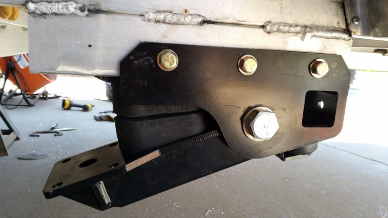

    Curbside bolted in;

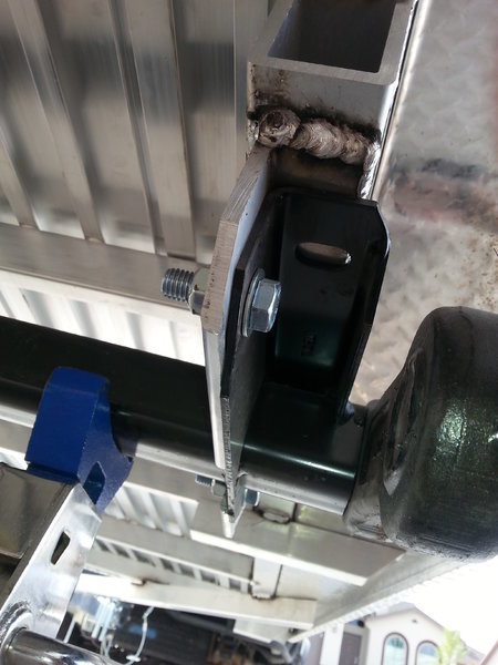

    Roadside bolted in and the 2x2 square tube welded in instead of bolted;

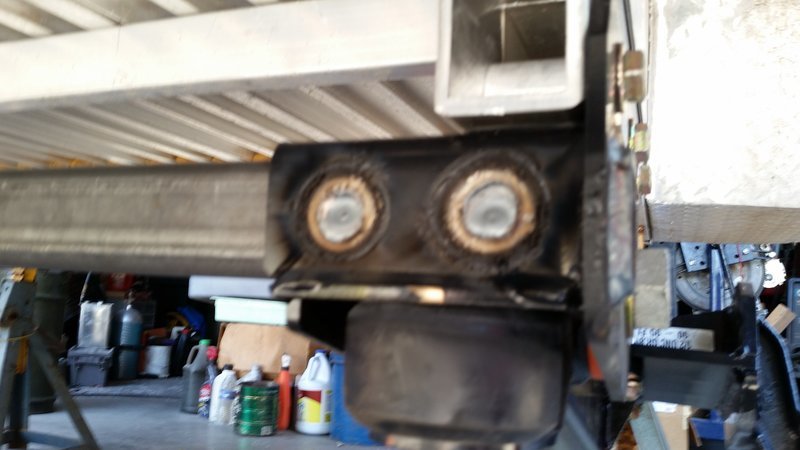

    Bolt holes with rosette welds;

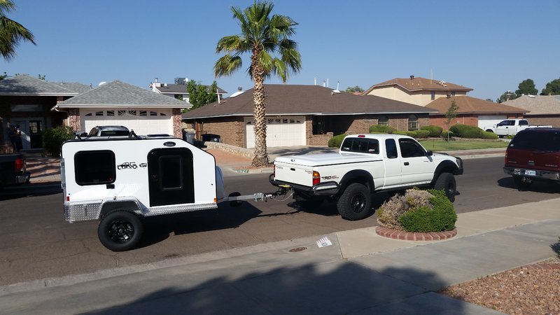

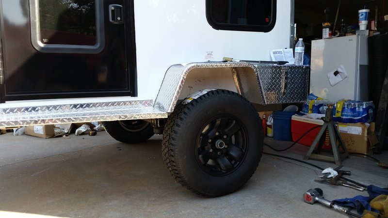

    Finished install with 235's on painted stock wheels. I also wanted to try the Centramatic dynamic wheel balancers, they have been working very well as I only mounted the tires and did not have them balanced. They are the silver looking disk behind the wheel.
    Finished product on shake down run before heading to the mountains the next morning;

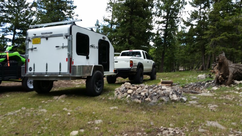

    By noon the next day I was about 5mi up a canyon that is more of a creek that a road and the suspension and trailer did excellent!

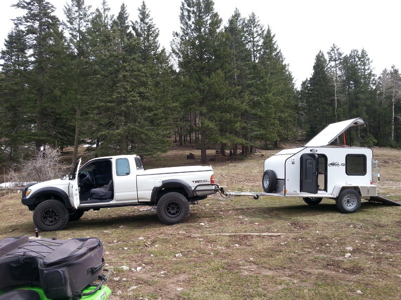

    This is the next weekend in another mountain range with the bike inside heading out of camp.
    You can see how much clearance you get underneath compared to a leaf spring setup.

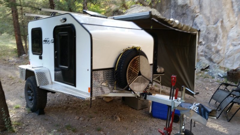

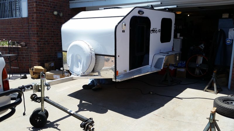

    Added the OX jockey wheel, I needed it for the adjustability up and down because the drawbar is high.
    the company has a video of winching a trailer in the sand basically making a trench with it and it doesn't collapse. Very solid unit.
    Also installed a pair of SaveAJack.com jack savers. Since the trailer is higher than when I bought it due to the new suspension, the ramp is too short to use safely while loading my MC I found these that make the stabilizing jack removable. I now have a great 'patio' when I need it and don't have to go down the road with the jacks sticking out. Win win!
