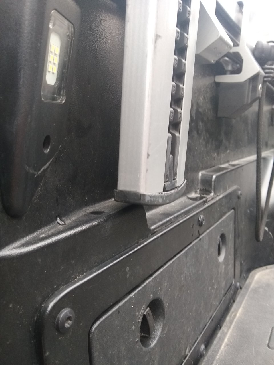

    I’m interested in why the rack doesn’t lower on Tacoma’s. Is it because the posts hit the wheel well? Or does the post towards the tailgate not have the ability to lower either? Maybe because of that lip that sticks out? I have an access cab, so the wheel well wouldn’t be an issue

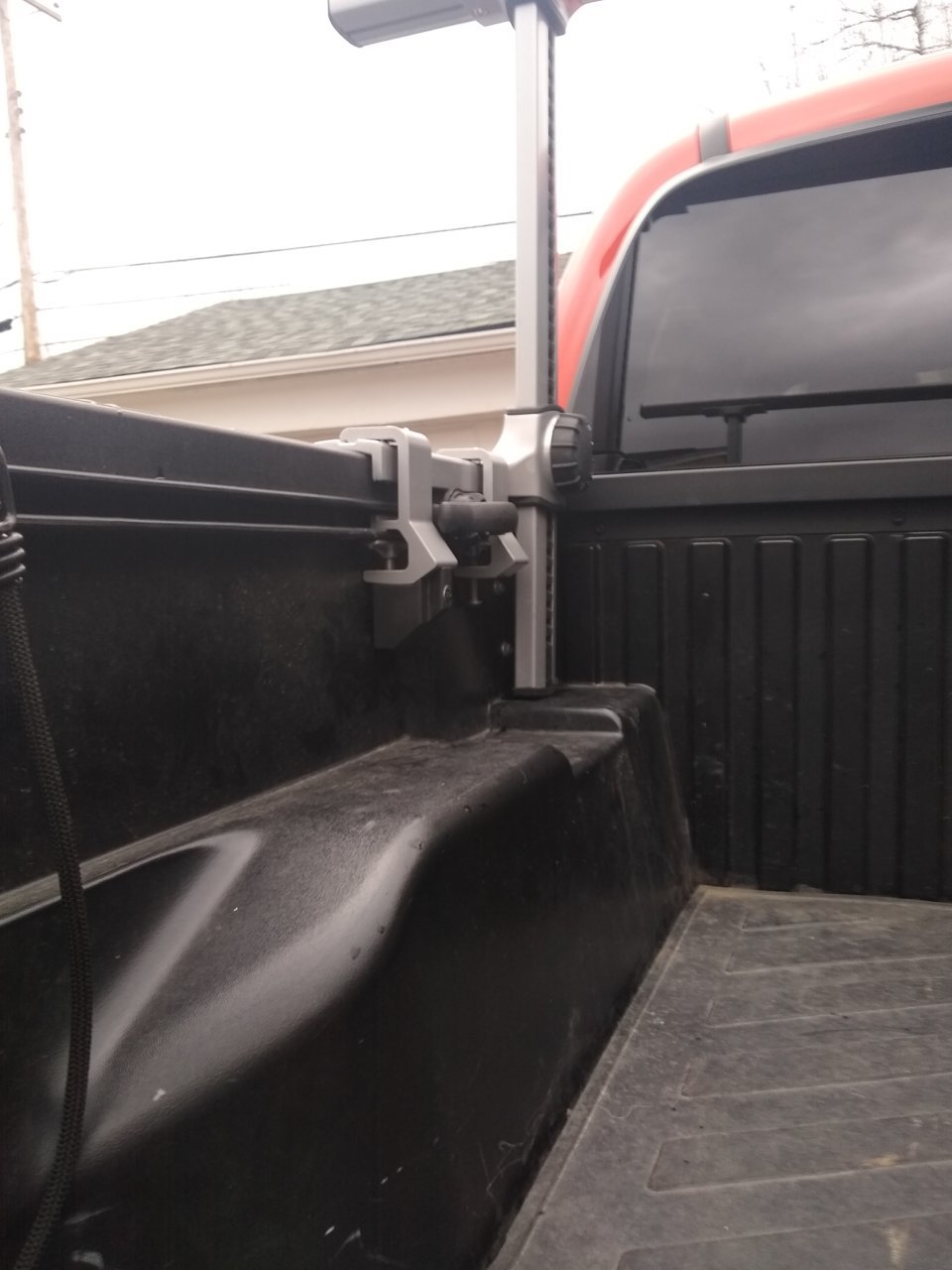

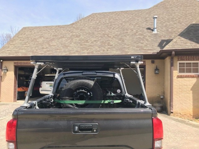

    Just installed one yesterday. Both front and back sit at the '20' height - low as they will go. With an access cab you might be able to get it down to '19' if you install the pillars above the bed slats. Was debating on cutting it down too but think I'll leave it for now. At lowest setting the top of the rack sits 3-4" above the cab which is perfect for lumber/ladders etc. Would prob need to raise it a few inches for my canoe.

    Awesome, thanks for the info! I guess I’ll go with these and just remove the post/crossbar when I don’t plan on using it. You can essentially just lift them out of the bases, correct?
  16. Feb 24, 2019 at 6:30 AM
    #16
    Beau_Higgins
    Beau_Higgins Well-Known Member
    Mar 15, 2017
    #213359
    417
    In theory yes, in practice, it's a bit of a PITA. You have to unlock the caps at each piller, untighten them, then shimmy each one up the foot (kind of hard to slide the whole thing at once). Honestly, I got this setup off Craigslist for $250... If I were buying something new I'd go with the Yakima Outdoorsman... way better price and overall simple setup. Especially bc you can't really lower these without hacking them up, anyways.

    One thing to consider with lowering them is visibility out the back. Before I installed mine, I set the crossbars at different fixed heights in the bed (just set them on random things) and then looked out the back from driver's seat. I found that anywhere I put them other than completely down (crossbars laying on the bed rails) or in their normal position above the rear window I was annoyed with them being in my field of vision. Obviously, cutting enough off the height to fix them toward the bottom of the window isn't feasible since you in turn wouldn't have enough height left to raise them. This was another reason I decided not to mess with cutting them down.
