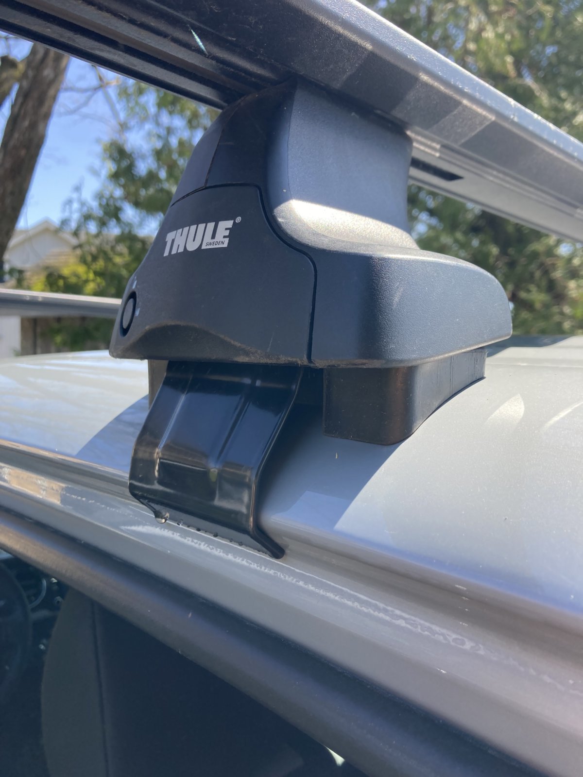

    I specifically signed up to answer this question. Just bought a used Thule fit kit #1511 tonight. It DOES fit on my 2021 Tacoma double cab perfectly. The 1511 is for 2005-2015 Tacomas but it will work on 2016-2023. With this style of Thule racks being discontinued, it gives some hope you may find this fit kit for your gen 3 Taco!! Cheers!!
