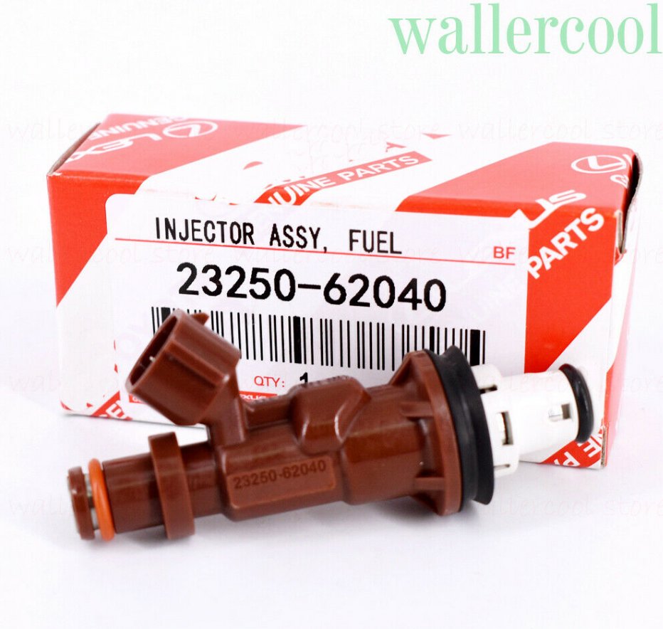

    I have an ‘01 V6 AT Tacoma. Need to replace the fuel injectors. What do you guys think of
    https://www.ebay.com/ulk/itm/143501071302
    If negative, then can you recommend something else? Limited budget here and can’t afford the LCE ones.

    Ebay Denso fuel injector? Id bet those are the cheapest thing Rockauto has to offer in a Toyota box haha.

    No. Never buy denso parts on ebay. People love to counterfeit them. Buy from a trusted parts house. Napa, Rockauto, Advanced, the dealer etc.

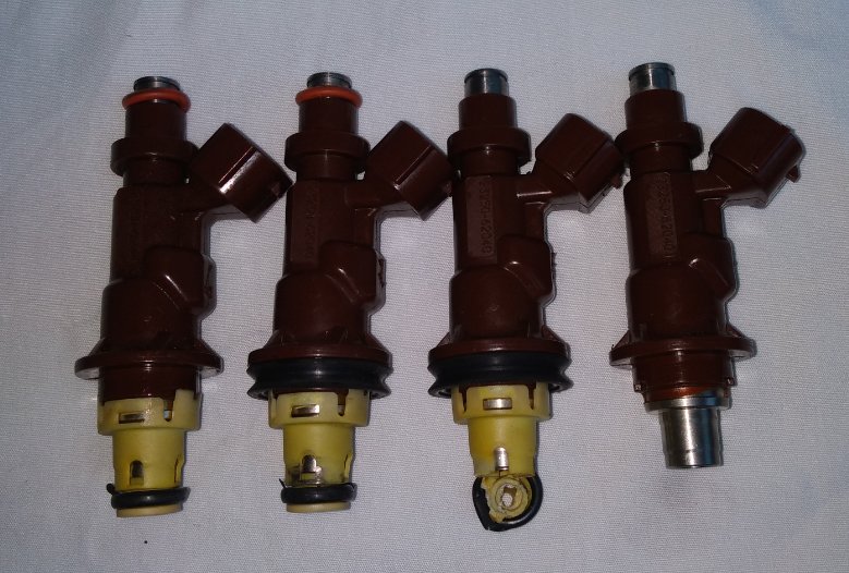

    I got burned on some counterfeit injectors from Amazon that literally started to melt and caused a major fuel leak on my intake manifold. I was lucky that I caught it before the truck went up in flames. Any part of the fuel delivery system should be taken seriously.

    Here's a picture of a counterfeit injector from Amazon.
    Here's a picture of a leaking counterfeit injector.

    These injectors from the link above are as counterfeit as the day is long. No testing lot number under the part number. Event the pintle cap is the wrong color.

    To @Empty_Lord 's point, for the 4 counterfeit injectors (on the left) that I installed, all had pintle caps that either melted into the intake manifold or deformed and leaked.
    I am very lucky the truck didn't go up in flames.
    The two (2) normal looking injectors on the Right are OEM/Intermotor that I reinstalled after buying four (4) more from Rock Auto to replace the counterfeits.
    Counterfeit injectors with melted pintle caps.
