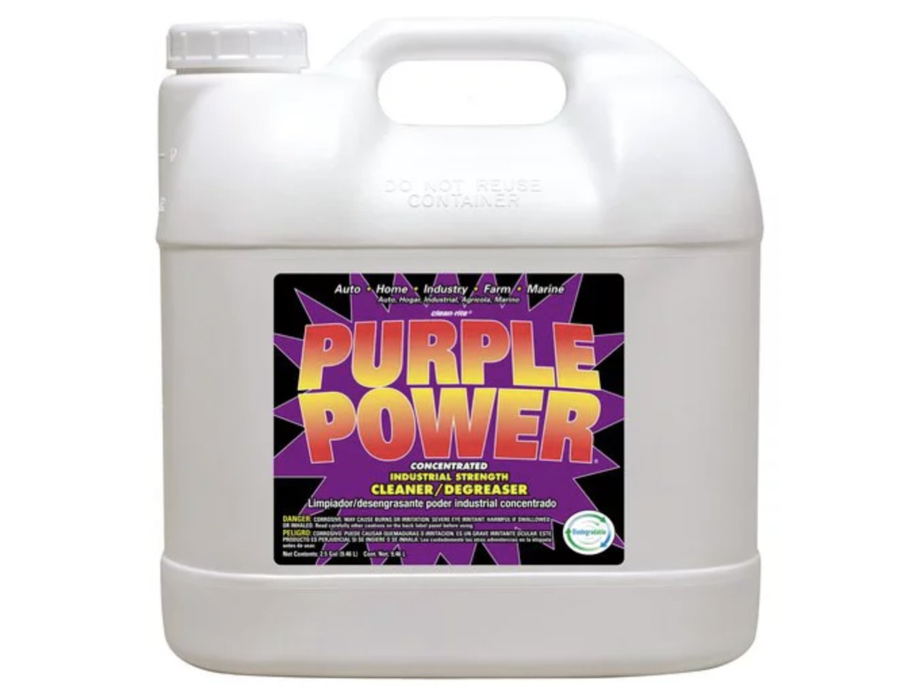

    I recently cleaned the Engine bay of my Tacoma.
    I used Purple Power in a spray bottle on the dirty spots and the underside of the hood, then hosed it down with a garden hose. I was shocked how well it cleaned up.
    Now it looks new under the hood.
    this stuff is also good for cleaning the door where the door seals cause the frame to get dirty and black.
    I've been using it on my Harley for clean up after an oil change so I tried it on the truck.
    This stuff is great.

    Some of that shit is hard on aluminum.
    I have used the purple formulation of simple green - I think it’s the only reason be that’s aluminum-safe

    I've been using it on my 2009 Harley of years with out any adverse affects.

    It is awesome stuff and a great value for the price, but you have to be very careful with it. It can damage/stain some surfaces and/or materials, and should be diluted 50/50 with water for most usues.

    Well yeah, it is concentrated so you would need to delute it. My only advice with it would be to keep it away from the alternator and the fan belt, but that would be the same for any cleaning agent.

    I've found that purple power tends to make plastics and wires get brittle and hard.
    It cleans good but I don't recommend it.

    I used it on my polished aluminum wheels and it made them “cloudy” looking.
    But that was about 20 years ago, they might have changed the formula since.
    Just don’t let it sit too long on polished aluminum.

    From Purple Power website:
    Can Purple Power be used on Stainless Steel and Aluminum?
    Do not use Purple Power on Stainless Steel or Aluminum as it could leave white streaks or a hazy film. If accidentally used on Stainless Steel or Aluminum and you have this residue, try buffing with a Metal Polish, such as Wenols or Mothers Metal Polish to restore finish.
    https://www.clean-rite.com/faq#:~:text=Do not use Purple Power,Metal Polish to restore finish.
    Soap and water is fine and, with any of these cleaners, rinse quickly and rinse well.
