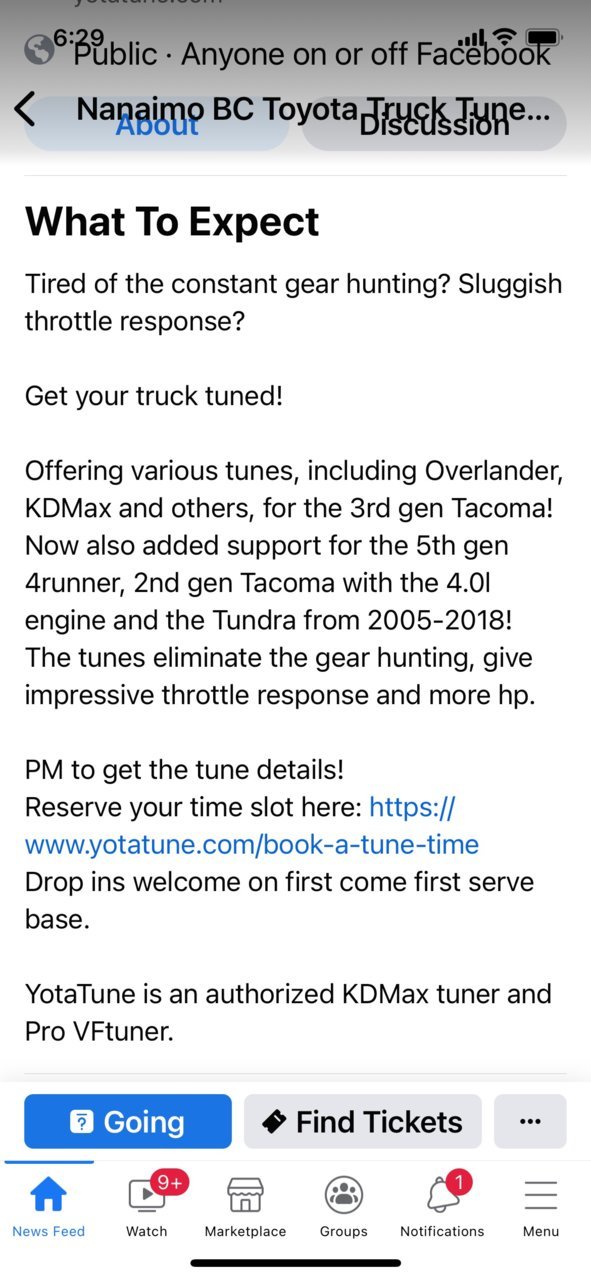

    So there’s a local tune thing happening. Has anyone done this? Is it worth it? Will it mess the truck up down the road possibly?
