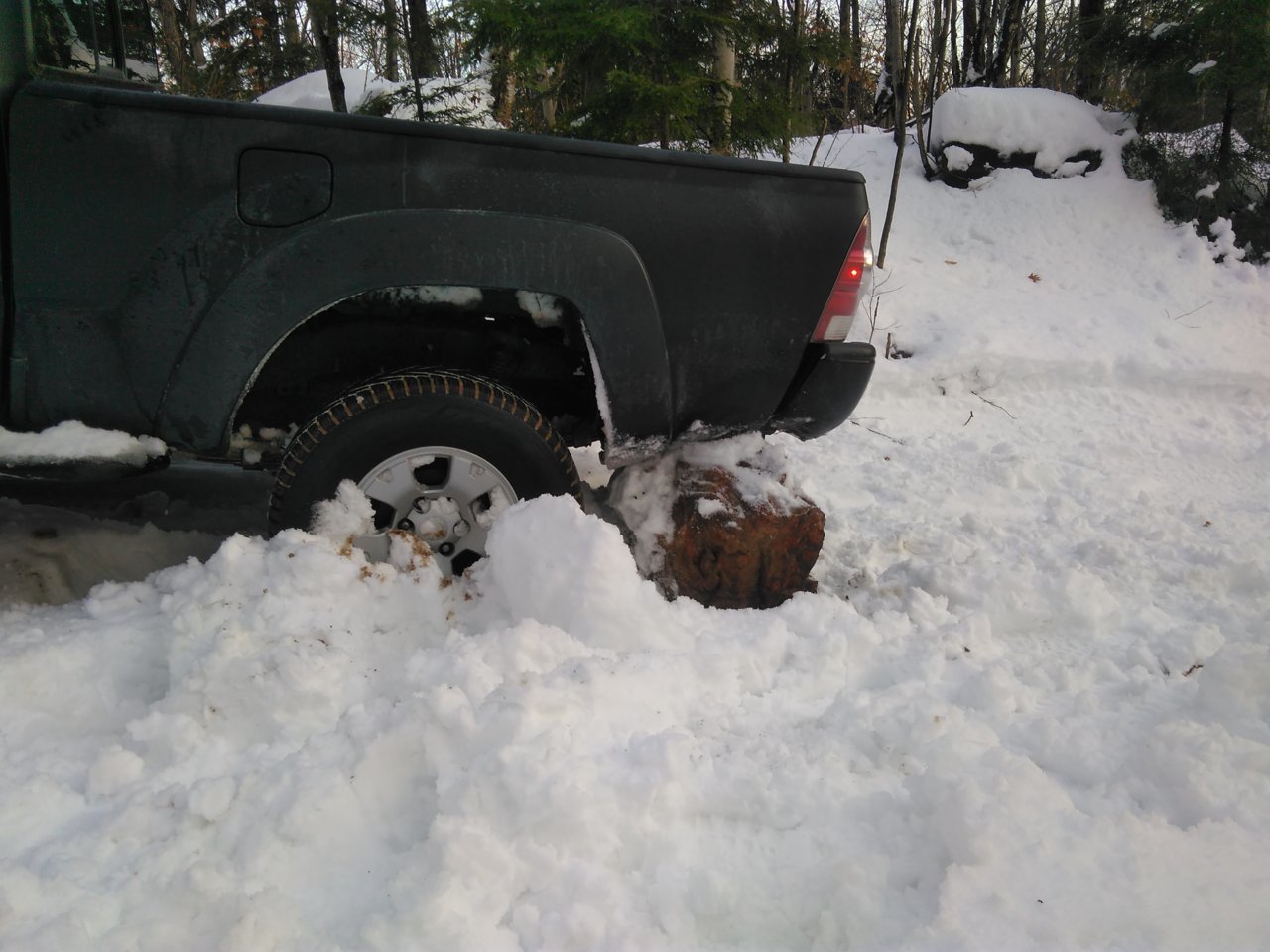

    I had my chrome bumper wrapped 3.5 years ago when I had my truck done in matte black. Not much help on the white issue with color match. :boink:
    I believe it is 2mm 3m matte black vinyl, had a shop apply it to the entire truck. Didnt think I could do it myself.
    Still looks ok :bananadead:
    It takes the most abuse of anything with dragging in the sand and such, or giant rocks. :cookiemonster:
