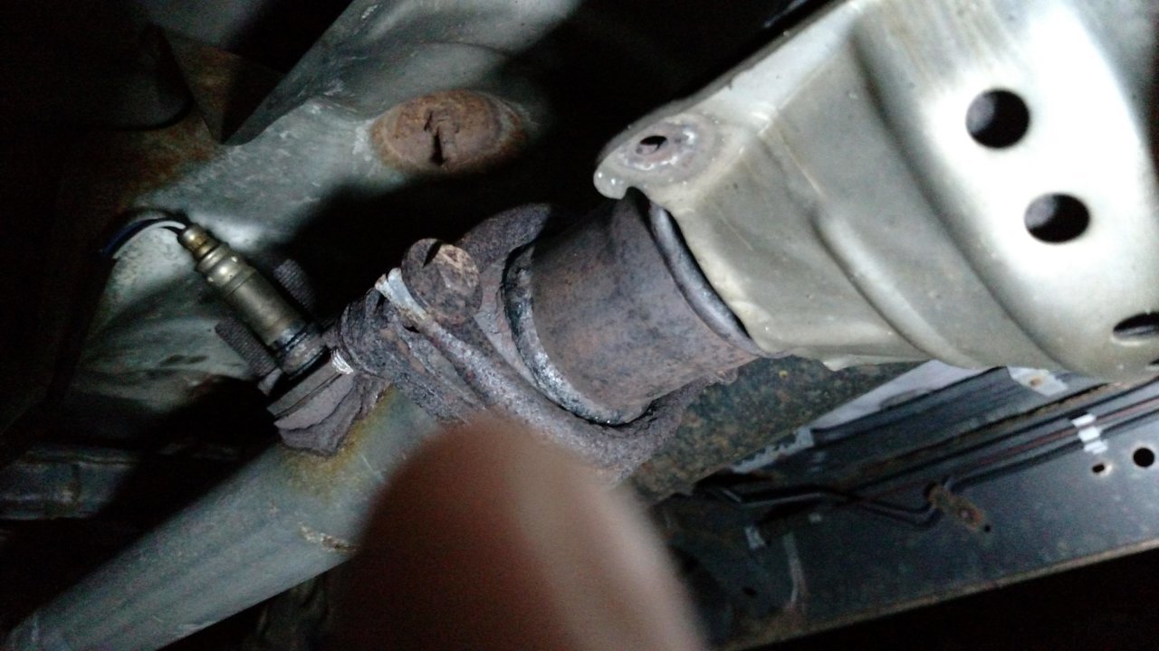

    Any videos on how to install a 2003 Toyota Tacoma Catalytic Converter? Also which aftermarket Catalytic Converters that are cheap would you recommend? I am going to have an inspection done tomorrow and I think they will tell me my Cat needs to be replaced. I would like to attempt it myself. Looks like a bolted on Cat. Here are some pics. If you notice in the last pic there is a bolt missing on one corner of the Cat. Would that throw a P0420 code?

    That is for sure your p o420 issue. fix the air leak and it will go away.

    That bolt only holds on the heat shield. It won't cause the 420 code to throw.
    Most likely us the gasket on ends of the cat.

    Any idea what size nut and bolt that is off hand?

    Those flange bolts are 3/8". They don't need to be metric. Most likely they will twist and break when you try to remove them.
    When you get new bolts and gaskets and clear the code, you still won't pass the emission test tomorrow. You need several days of driving to clear the stored code. I wouldn't even schedule an inspection for at least a week.

    Not decent under there, sorry but that’s the truth. You definitely need to pair up with a good welding /repair shop and get rid of those rusted tubes and put some good flanges on the exhaust and it will seal for another 20 years. In Ca they might flunk you on visual alone! Too bad we live in a world that requires this shit on our trucks because big corporations honestly put out more pollution than our vehicles do if properly tuned. The cats are probably for fine, bang on them with a plastic hammer and if the cat doesn’t rattle chances are they are good. You have a bad air leak just by looking at the pics, all at the flanges, they look like they were altered before and didn’t create a good seal.

    Ok. So I tested both the rear and front Cats with a digital temp gun. I pointed the gun at the right side of the Cat on the pipe and on the heat shield. I then tested the left side of the Cat near the gasket and then the heat shield. Looks to me the temps are about the same for the rear and the front Cat. Tell me if I am wrong? That is not good right? Should be a 100 degree diff from one side to the other right? Here are my videos. One is the rear Cat and the other is the front Cat.

    If it feels like it's running normal, but only has the CEL, it doesn't need cats.
    Also, if the exhaust does not smell like a trash fire, the cats are still good. The issue is going to be something less expensive.

    I've never heard of using temps to "test" a cat before either.
    the 0420 code can also be your O2 sensors or an exhaust leak, I'd go there before replacing a $600 cat.
