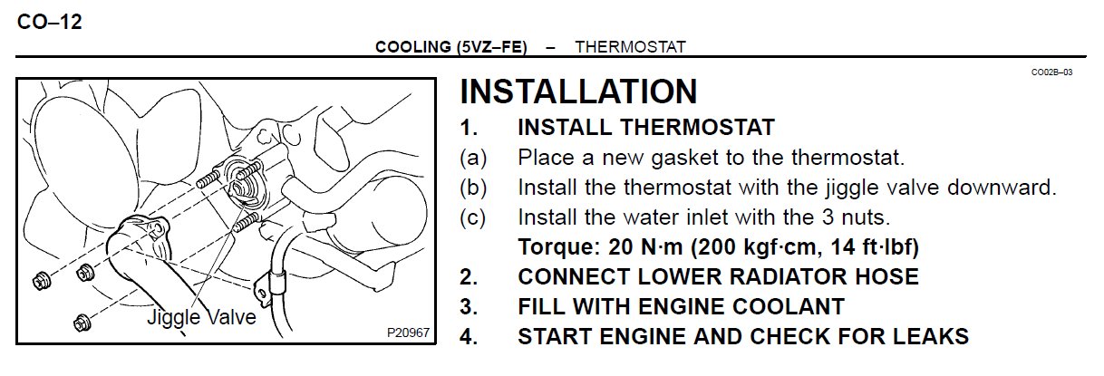

    Originally the factory service manual stated to put the jiggle valve on top in the 12 o'clock position. Toyota later sent out an update for the FSM that stated the bleeder valve for the thermostat of the 3.4L should be placed in the 6 o'clock position.

  20. Feb 10, 2022 at 11:19 AM
    #20
    Chacho87
    Chacho87 Member
    Jan 24, 2022
    #388279
    15
    Mauricio
    2004 Tacoma TRD-OR 4x4 Auto
    I was curious about the downward jiggle valve as well. I verified in the FSM that it is indeed installed downward (b).
