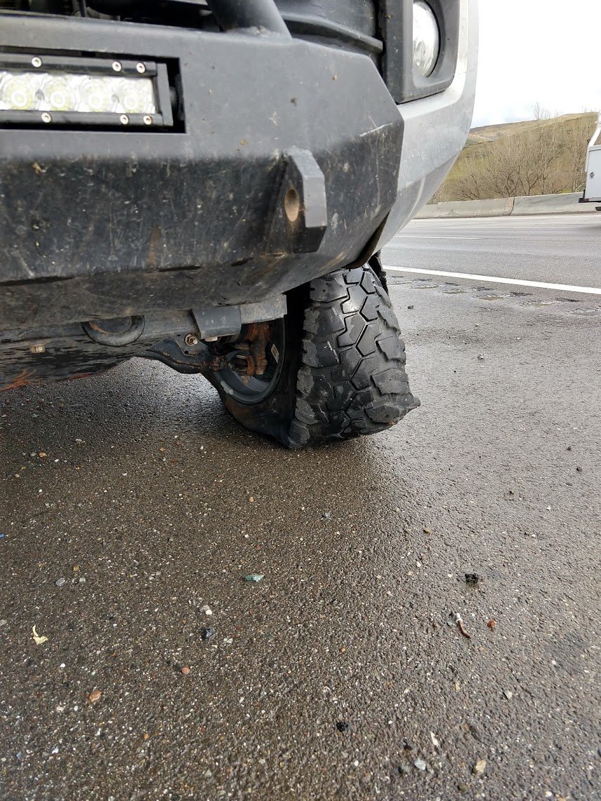

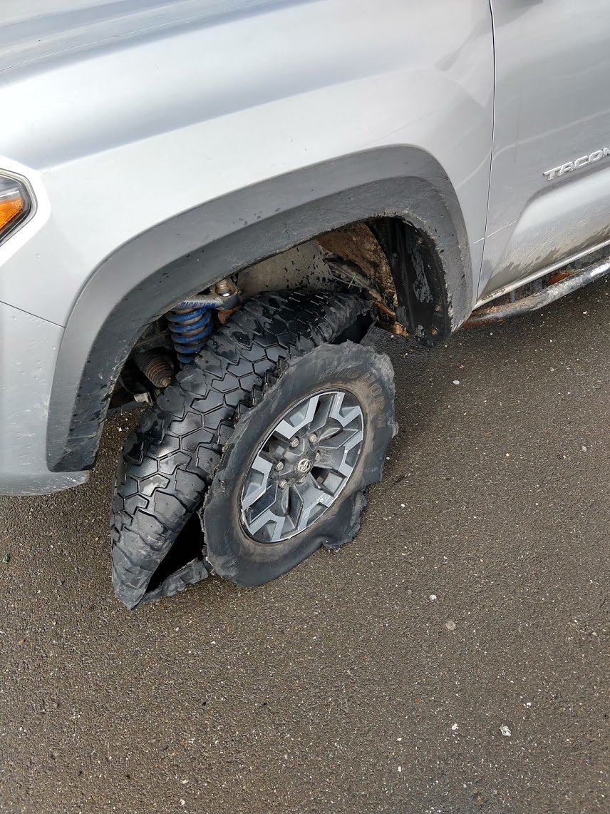

    Haven't updated in a while, so edited for current setup and to fix some obvious errors. (WTF was a 255/75/R16s tire, anyway?)
    Also, this happened:
    OExDt91qBD-obBc03IHpJOORkIlQaJvEmjuWD4w9_67ab362e5fe47c1815c657d0e231af0f816f599e.jpg
    fKANytXaGspVUowAfXRlrZD5Pd6DrCJiT6prFgO2_1595f645da9aa1e112fa9a42a058d1e31c16268d.jpg
    (I still like the Bighorns - I'm chalking this up to a trail damage finally making it through all the sidewall plys.)

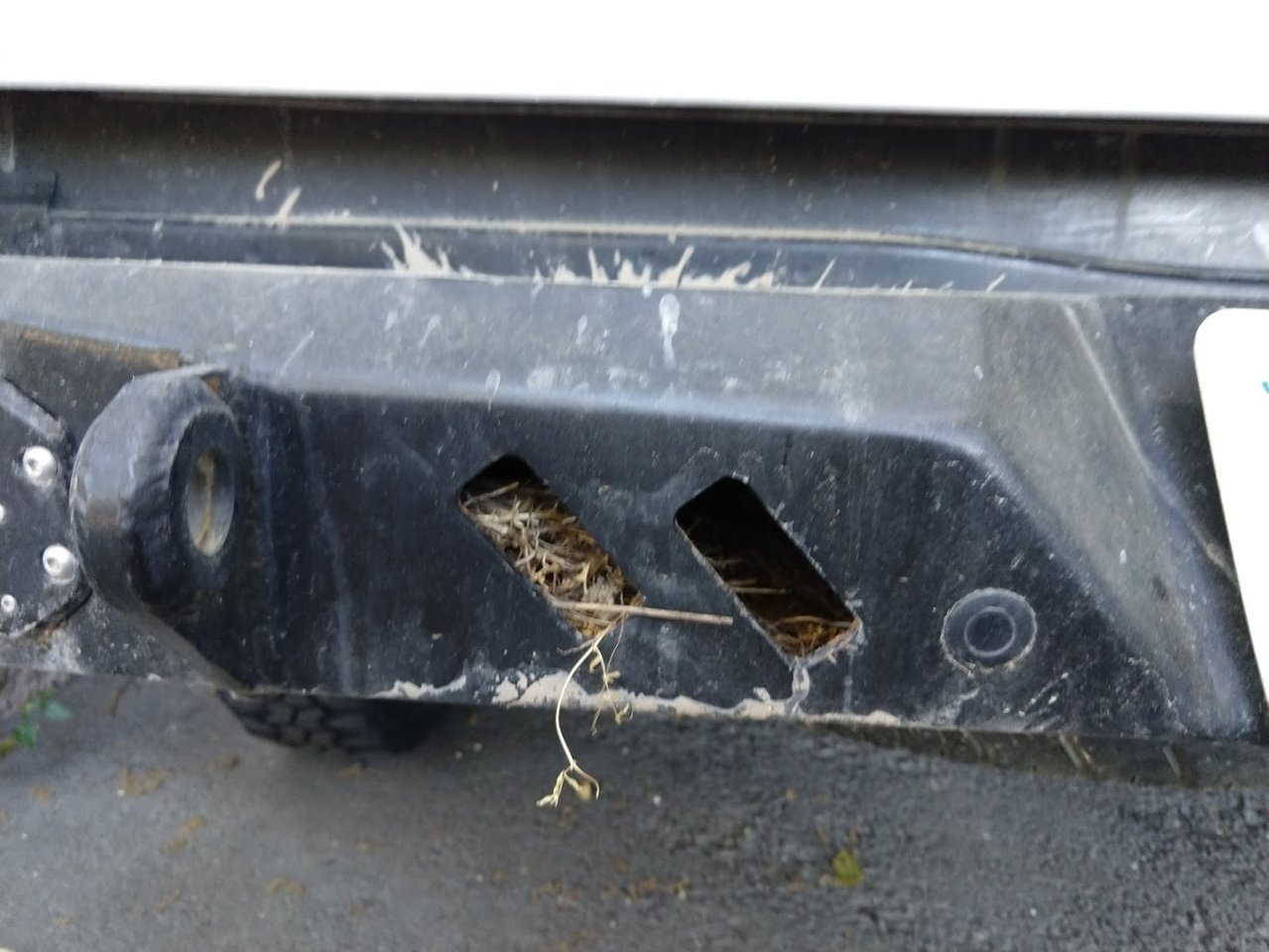

    My BSM system started acting up, intermittently beeping and showing "Check BSM System" on the dash. Sometimes this beep happened every few minutes, sometimes a couple of times a second in rapid succession. Felt like a loose wire or a short or something, and I was suspicious of the connector going into the sensor, but couldn't diagnose it at the time. I disconnected the BSM harness, and drove another few thousand miles in peace and quiet, then finally dropped the bumper to check it out.
    Several trips worth of mud and sand were sitting up against the bottom of the sensor (washed periodically, but definitely not often enough) and also worked into the space between the sensor and the plastic panel. The (aluminum?) backing plate on the sensor was corroded at the bottom, and the bottom tab snapped off of the backing plate on both sides. The lower-most captive nut also came off on both sides. The sensor's connector looked fine and dry on both sides.
