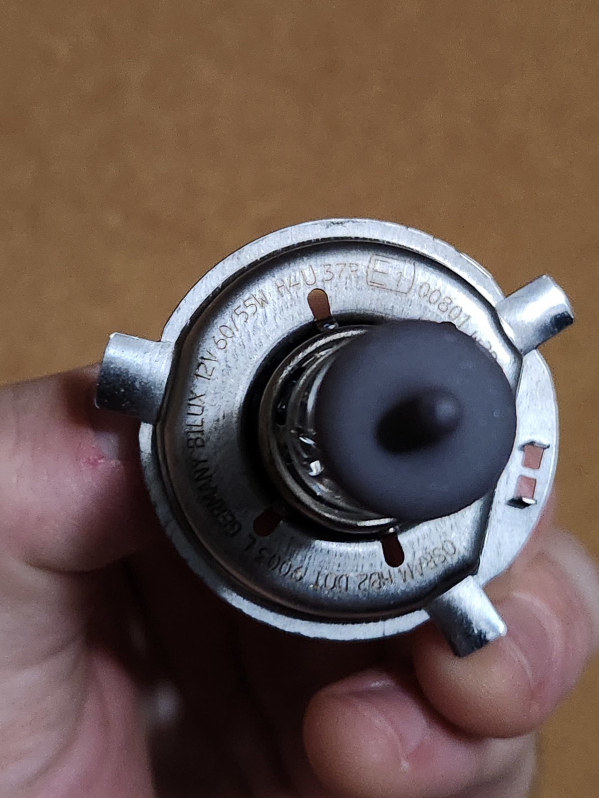

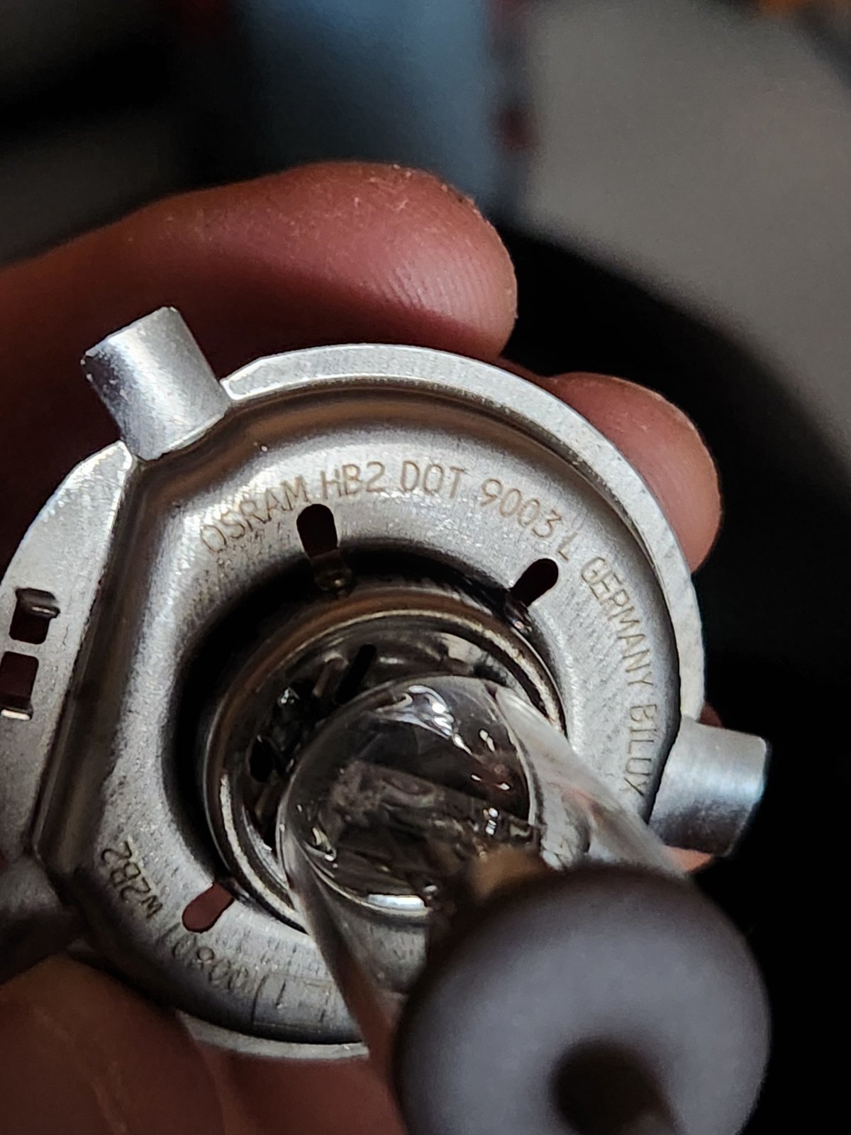

    Does anyone know what make/model bulbs came stock from the factory in a 2013 tacoma ? I wanted to buy the same ones because they are still going strong but figured I should replace them or have backups on hand.

    These are the stock bulbs (not sure if OEM or not) I pulled out before doing the ultimate headlight upgrade on my 2013 Tacoma. They survived 6+ years in the desert heat and countless dirt road camping trips, dust storms, rain storms, etc.
    looks like "OSRAM hb2 dot 9003 L BILUX 12v 60/55W H4"

    yeah I was reading the ultimate headlight thread and it seems like the ones only last 200 hours so i was looking for the kind i had in there. i worked early morning and nights and drive in dark all the time so idk how many hours but i know its over 200 over 12 years.
    i think i found them on ama.zon they are $7.99 a bulb. isn't 1650 lumens a lot i don't think they were ever that bright
    https://www.amazon.com/DAMA-Automotive-Lighting-Original-Standard/dp/B0CW1PQZ91
