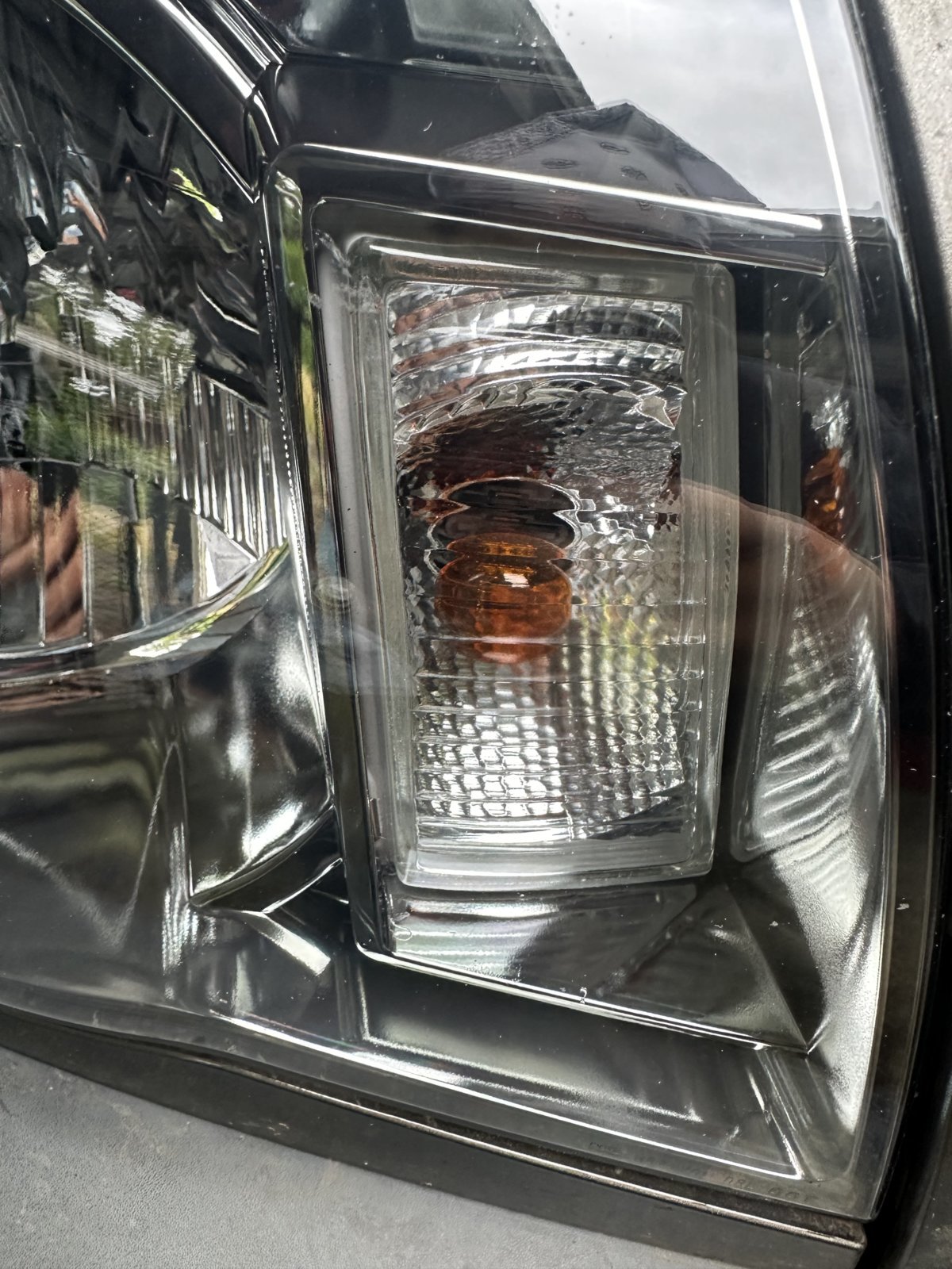

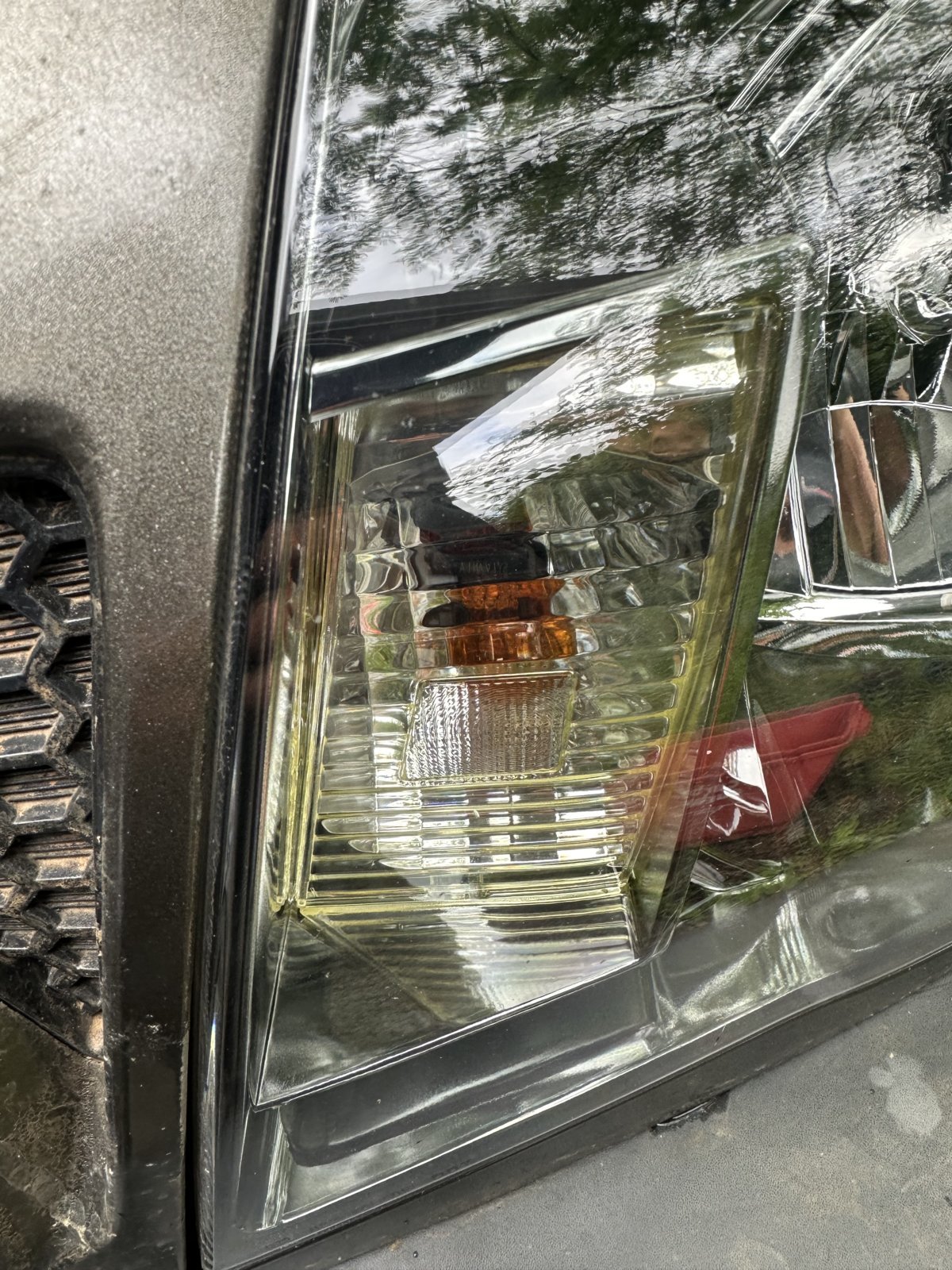

    Late to the party here, after doing tons of research (thanks to this thread and everyone posting) I pulled the trigger on the new headlights and harness from Headlight Services! I did this back in January and all has been good so far, only thing I just recently noticed is one of my headlights looks slightly different. I must have missed it when I put them on because of how stoked I was. I bought new oem smoked headlights for my 2011 Tacoma using the part numbers posted here from toyotapartsdeal. I made sure I wasn’t getting the old ones that had the drl melting recall so I’m not sure what happened. The headlights look identical except for the lens in front of the turn signals as you can see in the pics. It looks kind of yellow and has a square in the center. Can anyone chime in before I write an email?

    Toyotapartsdeal is not one of the more consistently well reviewed oem parts sites out there. Just do a search on here.

    You only got the TSB version on the passenger side. Driver side is the old style; looks like it’s not smoked either, just regular chrome

    I can confirm that the driver side lamp is smoked like the other one but the turn signal is different.
