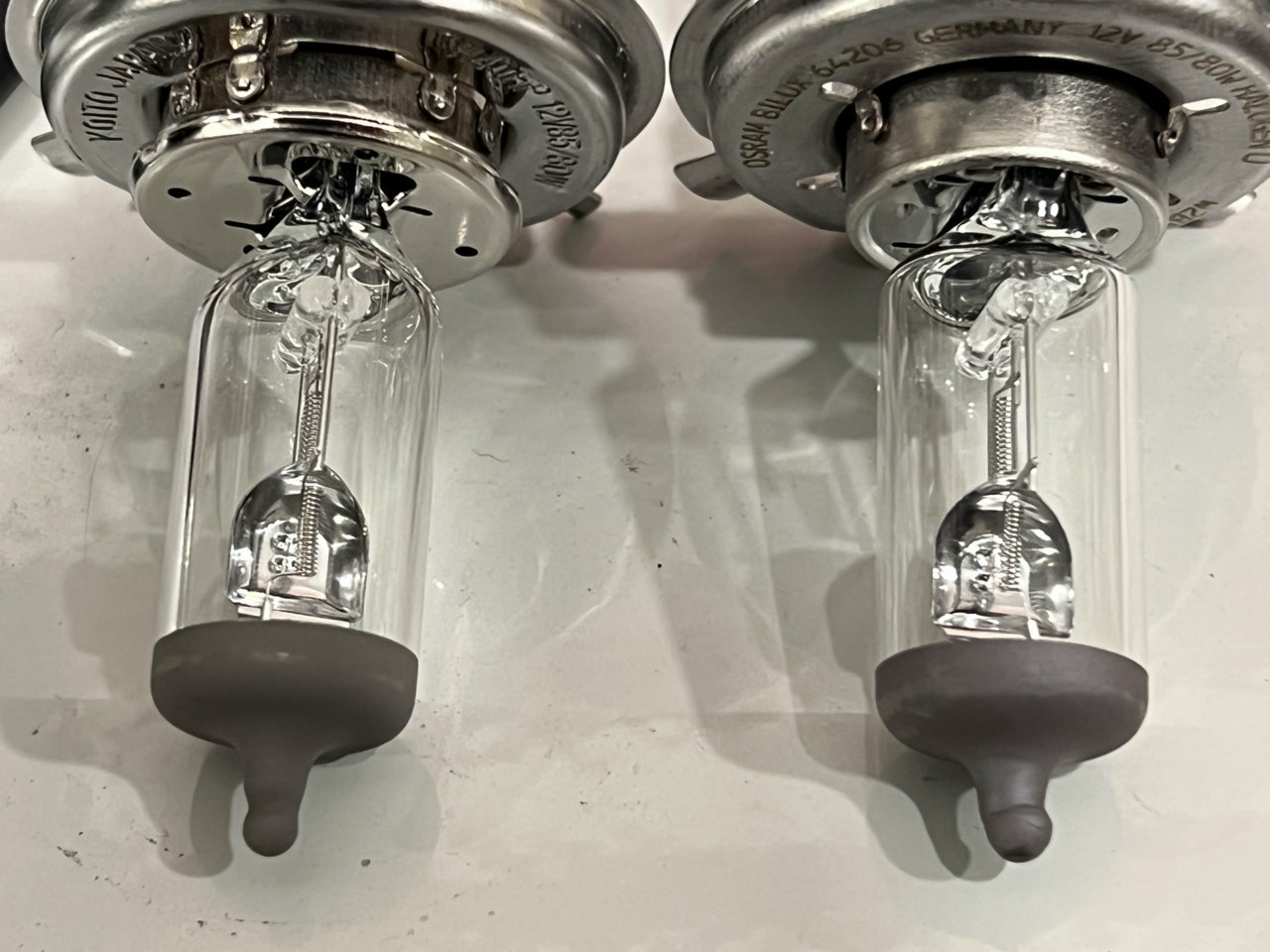

    Koito 85/80w vs Osram 85/80w Hyper
    The Koitos have a denser filament wind than the Osrams. What is also interesting in the above photo, is the Koitos have the bulb assembly rotated slightly more counter-clockwise than other bulbs.

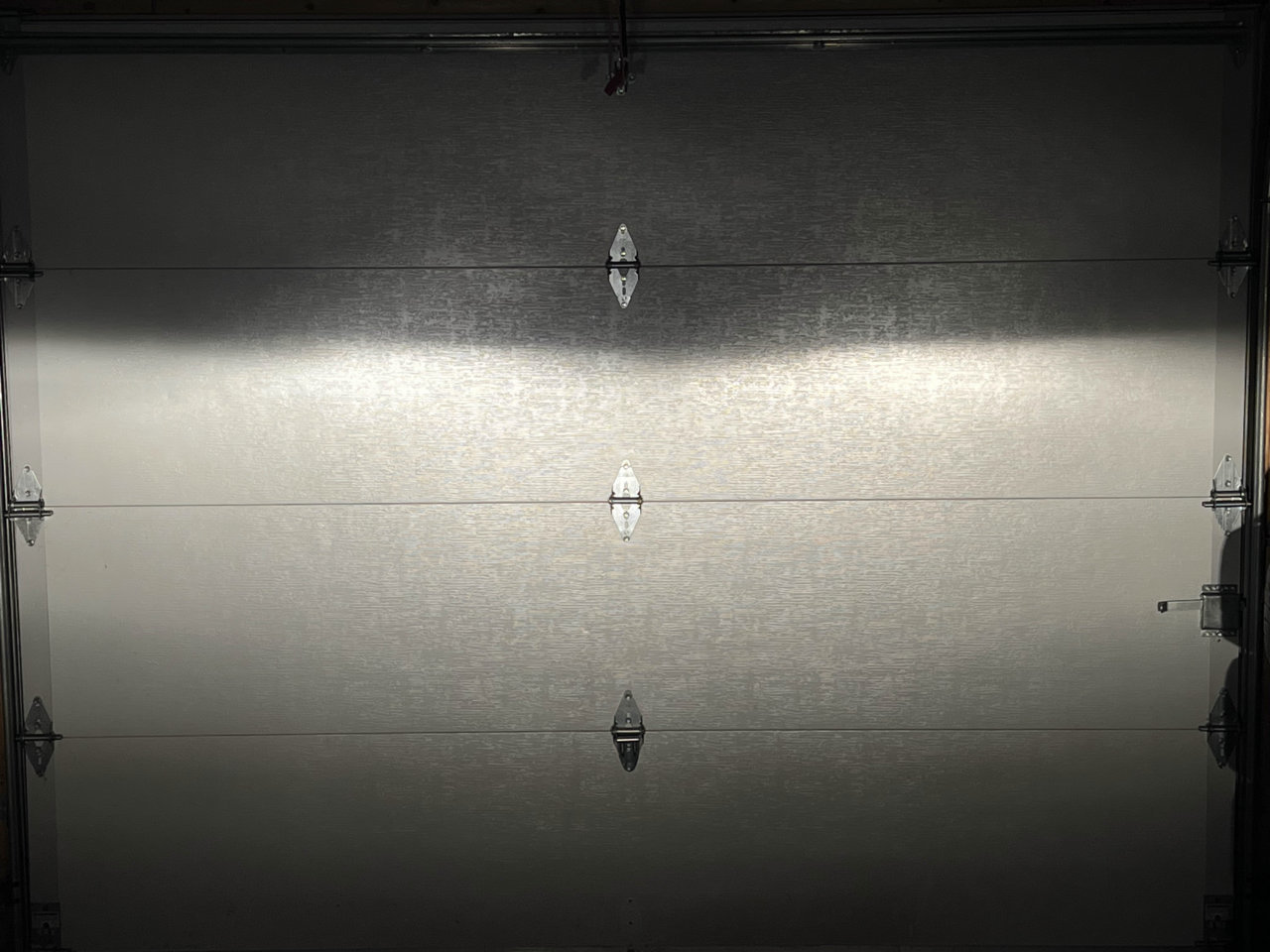

    Osram 85/80w Hyper vs Koito 85/80w
    Nowhere close to the performance levels of the Osrams.

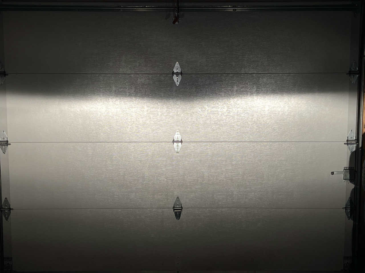

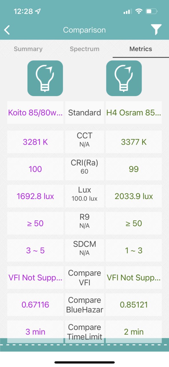

    Koito 85/80w vs Osram 85/80w Hypers

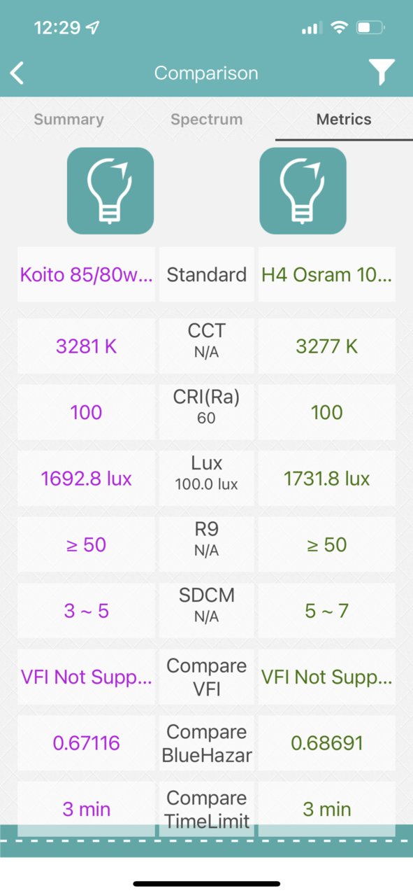

    In fact for a claimed high efficiency bulb, the Koitos actually fail to outperform the 100/90w Superbrights on low beam, while the Koitos *also* draw more power than the Osrams.

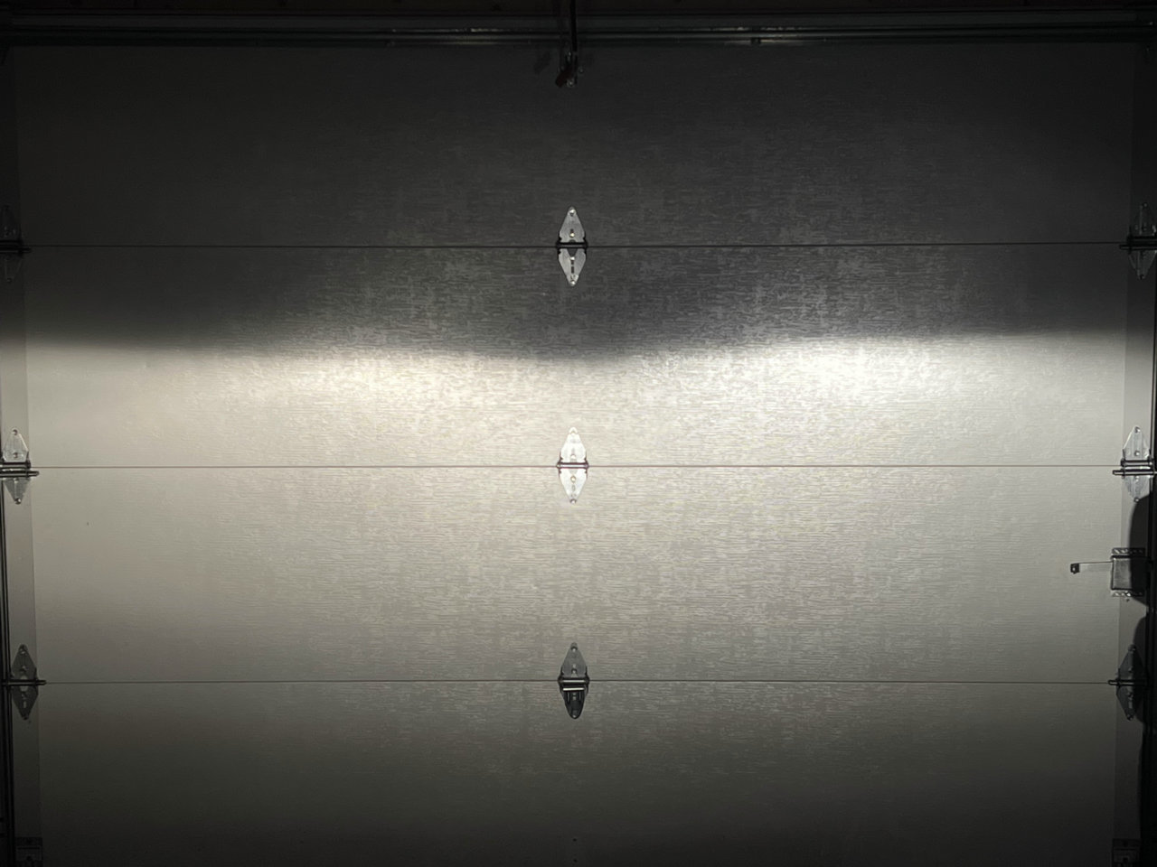

    Osram 100/90w Superbright H4 vs Koito 85/80w

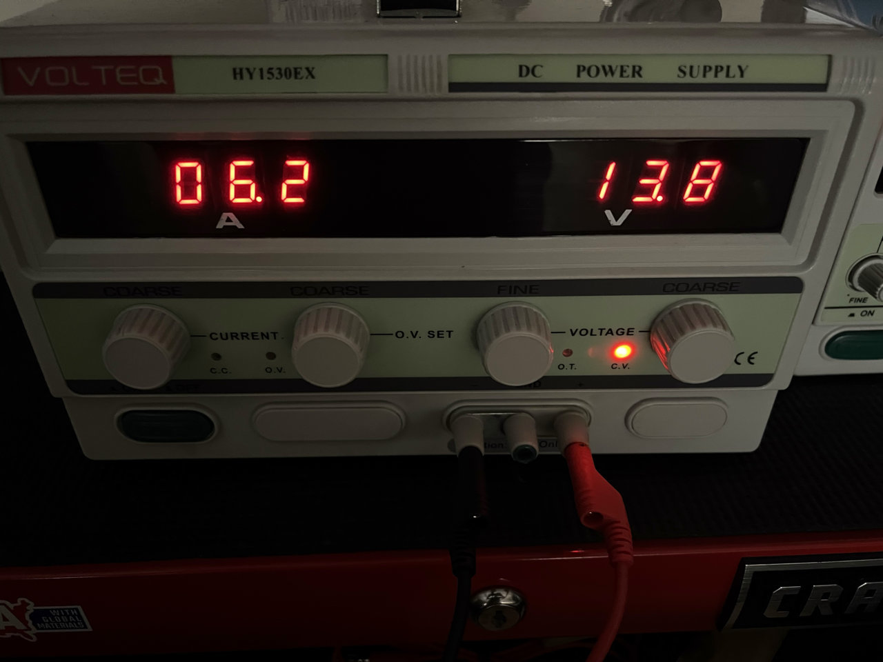

    What is interesting is the Osrams actually drew 6.0A while the Koitos drew 6.2A. So despite the Koitos having an lower nominal power rating and claiming higher output, they actually drew more power and had less output intensity than the Osrams. Koito low beam:
    Koito 85/80w vs Osram Superbright 100/90w low beam

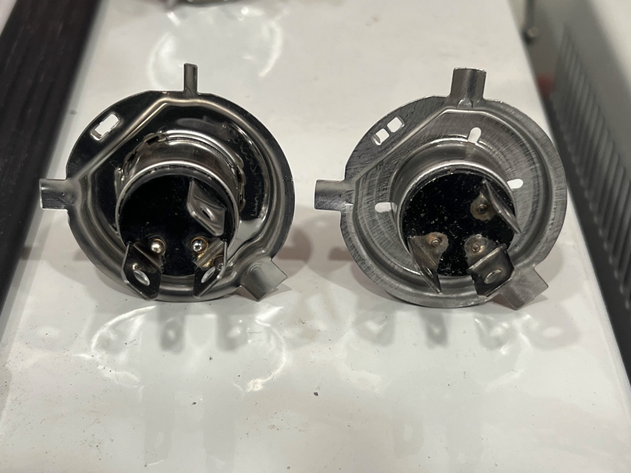

    The Koitos are actually an H4U which has a single narrower tab, and H4U bulb will fit in an H4/9003 assembly but an H4/9003 will not fit in an H4U assembly.
    H4U vs H4/9003
    I was excited for these Koito bulbs, an H4 compatible bulb promising higher wattage plus higher efficiency from a reputable manufacture seemed promising. However this product is a disappointment with higher power draw and lower output intensity than Osrams simplistic Superbright line, much less the significant shortcoming compared to the exotic Osram Hyper bulbs.
