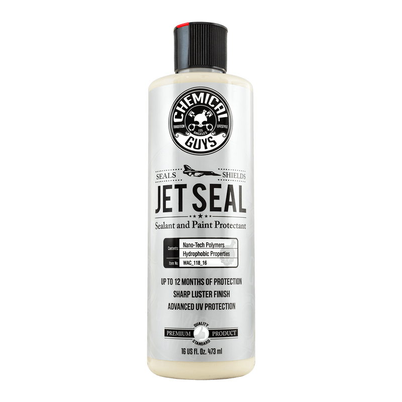

    Has anyone used Jet Seal on their headlights?

    Just about any wax / sealant / coating will prevent oxidation on headlights. It's just a question of how much protection / how much extra time each product will buy you. Unfortunately, there's no way to verify claims of "advanced UV protection" or to compare it to other products. I'd say this particular product is absolutely better than nothing at all.
    As proof of the above, the headlights on my 2014 Tacoma are still absolutely like brand new. Then again, they've had whatever polymer sealant / ceramic coating the rest of the truck has on it from day one.

    I was using the Jet Seal on the door glass, decided since it was out I’d try it on the headlights. I didn’t clean them prior but it seemed to take away a lot of the haze. They haven’t been waxed or sealed in the 8 years I’ve had the truck. The two small spots did look better. My plan is to wash them good this week and apply this stuff, I may even buy a buffer to apply it.
