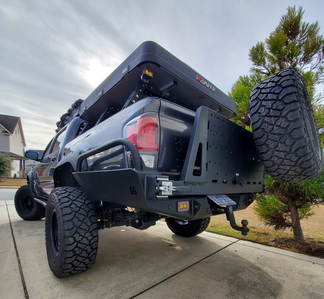

    I get a lot of questions asked about my truck and the build progress. To be honest, I've forgotten a lot of stuff as I have changed up the build over the years. Hopefully using the @Choyota build format I can do some justice to this thread lol, and actually quantify everything in one location. Enjoy!
    2017 TRD Off-Road DCSB 4x4 (MGM)
    Current Mods
    Front Suspension
    • DirtKing +3.5 LT
    • DirtKing Double shear bracket and secondary shock hoop
    • King 2.5 x 8" Coil-overs (700lb springs)
    • King 2.5 x 8" Triple Bypasses
    • RCV Axles
    • @glorifiedwelder spindle gussets
    • Total Chaos cam tab gussets
    • Wheeler's Super-bumps
    Rear Suspension
    • King 2.5 x 12" Smoothies with adjusters
    • Archive Garage shock relocation
    • Archive Garage hammer hangers with cross-brace
    • OME Dakar HD+ (extra EX46XL AAL)
    • Stock shackles
    • King 2.0 x 2" Hydro bump stops with U-Bolt Flip
    • Custom 3"/75mm hub-centric wheel spacers
    Wheels and Tires
    • Fuel Trophy 17x8.5 (-6mm offset, black)
    • Kenda Klever R/T 35x12.50R17
    • KMC Grenade Desert Beadlock 17x8.5 (+0 offest, black)
    • Maxxis Razr M/T 35x12.50Rx17
    Armor
    • Relentless Fabrication Honey Badger Front Bumper
    • C4 Fabrication High-Clearance Rear Bumper
    • BAMF Skids (IFS/Trans/T-Case/Diff) - Steel (1/4")
    • Mobtown Offroad DOM Sliders
    The Goods
    • 4.88 Nitro Gears
    • Toyota 8.75 E-Locker Rear
    • Harrop/Eaton E-Locker Front
    • Gears done by East Coast Gear Supply in Raleigh, NC
    • Locker work performed by Premier West Gears in Riverside, CA
    • OV Tune performed by @moddedbyphil on IG
    • 5th Gen 4Runner brake upgrade
    Lighting
    • 30" Baja Designs S8 Bumper Light Bar in bumper
    • 40" @Choyota special light bar on roof rack
    • Baja Designs Squadron Sports (Fog Lights)
    • Baja Designs Squadron Sports (Ditch Lights)
    • Baja Designs S2 Sports (Rear Bumper)
    • Baja Designs S2 Sports (Chase Lights)
    • AlphaRex Nova Series headlights
    • MESO-JDM tail lights (on order)
    • Cali-Raised Ditch Light Brackets
    Misc
    • CMC by BeastFab Socal Solutions in San Bernardino, CA
    • Trimmed Fenders (myself)
    • Real bolt on pocket style flares (myself)
    • SwitchPros SP8100 on Powertray mount
    • Spiker Engineering hood struts
    • Tailpipe Dump
    • Exhaust Re-route
    • Smittybilt S2O 10k Winch (Synthetic)
    • Factor 55 E-Link
    • Bed Stiffeners - Cali-Raised
    • Amazon special CO2 tank 20lb
    • Viair 440P Portable Air Compressor
    • ARB Safari Snorkel
    • Snorkel Upgrade pre-filter
    • MBRP Muffler
    • All-Pro Hi-Lift Mount (Bedrails)
    • Snail-Trail Tailgate Insert
    • Extended Brake Lines 24”
    • X2Power AGM Group 27F Battery
    • Prinsu Cabrack, dual Pelican 1750 cases
    • Relentless Fabrication modular bedrack
    • iKamper Skycamp Mini
    • WeBoost DriveX OTR
    • MobileStrong bed-drawer system
    Interior
    • Hondo Garage Air Vent Mount Thing
    • Hondo Garage Radio knobs (AR15 bolt face, pewpew)
    • Meso Customs Dual Light Dome/Map Lights
    • Glock 19 Holster
    On Deck (aka Coming Very Soon)
    • Baja Designs 40" S8 lightbar for roofrack
    • MESO Customs Tail lights
    Future Plans:
    • Who the hell knows...
