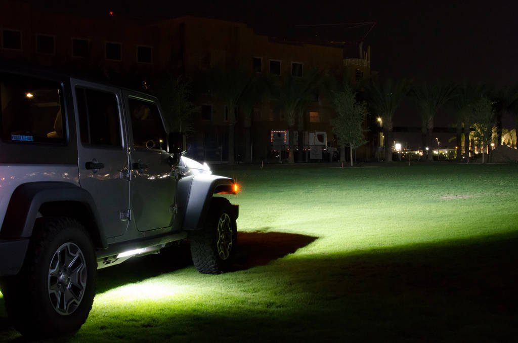

    Pretty much this. At night, your not going to be hauling ass, as....well....that stupid unless you are properly set up for it, and of more advanced off road skill level. Propperly mounted lighting is more important than having a shit ton of lights on the front. Example....50" light bars. They look cool, but the amount of glare on the hood actually hurts your depth of vision, negating any additional output they offer. Pictures don't do much lighting justice, but this pic is with LED low beams, and KC C3 LED pods in Flood pattern. The building in the back ground is about 150 yards away, and there was no light within a half mile in either direction of where this photo was taken:
