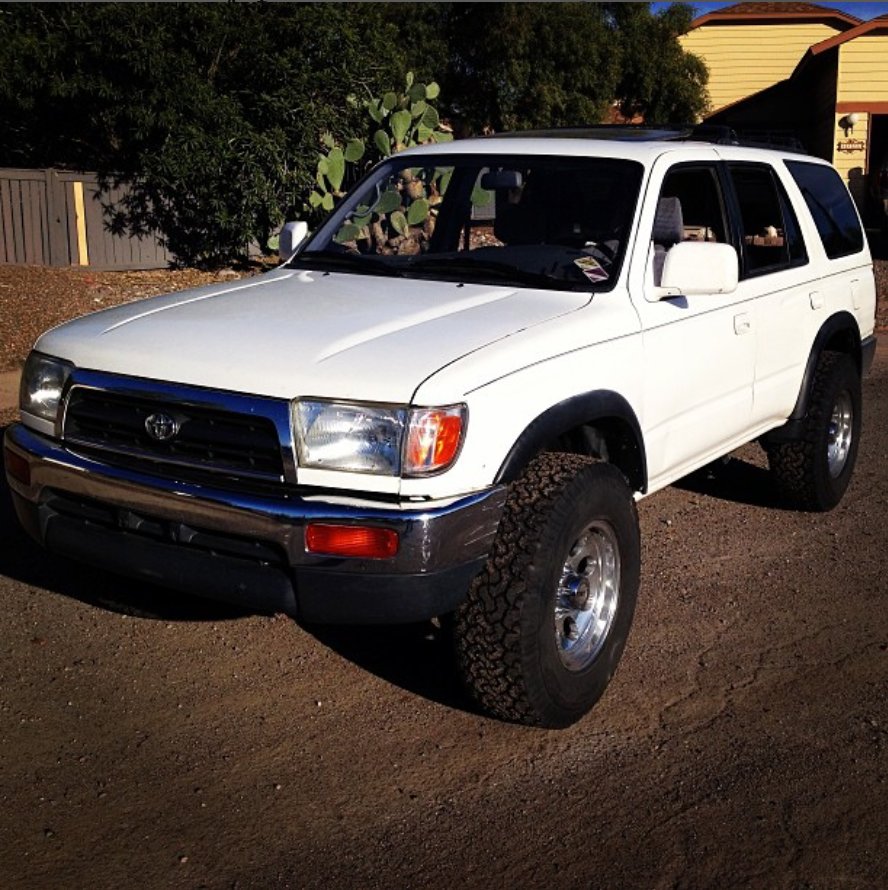

    After saving up funds from my first job I was able to start looking online at a lift and some new wheels and tires. In April of 2013 I was scrolling through craigslist where I found some 265/75/16 BFG K01's mounted up on 16" Mickey Thompson Classic III's for $200 bucks plus stock tires! Blown away that I even found this deal, I messaged the guy and met him at our local Toyota dealership where we did the deal. Other than the fact that they rubbed at full lock, I couldn't be any happier!
    With my new shoes on the 4Runner, I forked out the other $200 to buy a cheap spacer lift kit on eBay. Within a couple of weeks I was ready to do one of my first big mechanic jobs. Thinking back on it now, we totally had no idea what we were doing. I remember my buddy stepping on the lower control arm to try to get the shock bolt to line up. Ohh how far I've come as a mechanic lol.
    Despite having no idea what we were doing, we successfully got the spacers on and were extremely happy with the end result - and better yet no more rubbing!

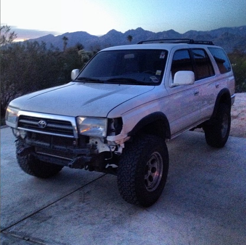

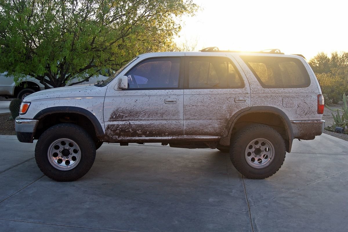

    With the lift on (albeit a really s***ty one) I found the 4Runner to be extremely capable. After I graduated a month later from High School, I was able to go out and do some longer trips in the 4Runner. We went everywhere - all over Tucson and even beyond. In June of that year I took my first long road trip up to the White Mountains where we have a cabin. I remember the first time driving on the highway - how nervous I was let alone going by myself. Despite my nervousness I knew that the 4Runner would get me there, and it did with no issues.

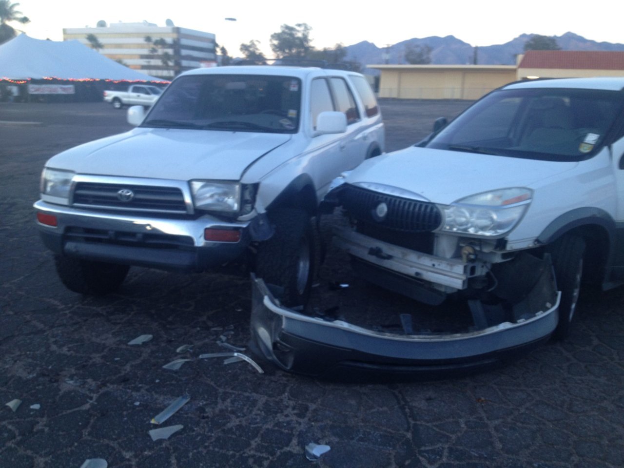

    While I was waiting to hear back from the insurance company on whether they would fix it or not, I saved some money to fix it myself just in case. With the news that the insurance company was going to fix the fender and the bumper, I went out and used my money to buy a brand new OME lift kit and some tires! With the OME kit on, I spent every free moment I had going on adventures or planning one. Here's a few pics from all the trips we took:

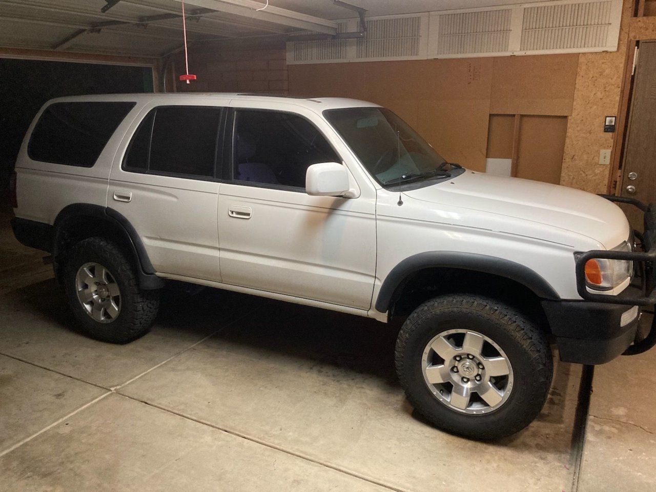

    Pretty lengthy list but I figured with 230k on her it was time. Once I had gotten back to Tucson (where we have the worst roads) I did notice that the front end and suspension was pretty tired. Started wandering all over the road and had awful bump steer.
    When I sold her back in 2015 the front end was pretty wonky and it appears the buyer did replace the ball joints with Moog aftermarkets - which was NOT okay with me. These 3rd gen 4Runners and 1st gen Tacomas have a faulty ball joint design to begin with and I've heard horror stories about aftermarket parts. I ordered all new OEM parts and got to work rebuilding the front end. Installed new OEM ball joints & tie rod ends along with some TRW steering rack bushings.

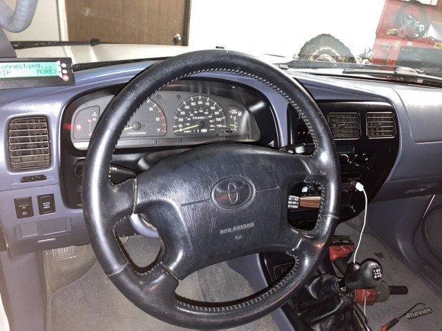

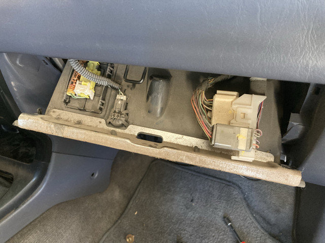

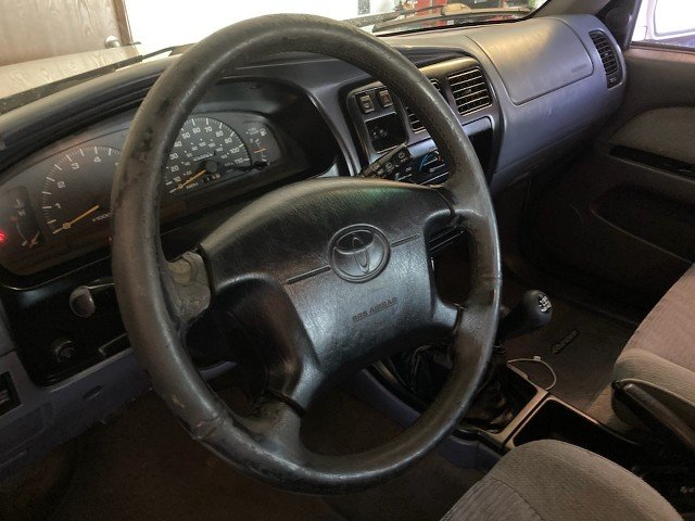

    The guy I originally sold it to did some small mods on the interior, namely installing white LED's in the gauge cluster, red for the climate control and blue for the small buttons. This drove me absolutely crazy so I replaced all the LED's with OEM bulbs with the green covers brining it back to stock. While the dash was apart I replaced the crappy Pioneer deck with a newer Alpine.
    My brother and I tracked down a 1996 in a junkyard and robbed the engine harness & the ECU for our 1990's 3.4 swap. Lucky for me it was a manual in the same interior color so I grabbed the rear cup holders, shifter knob & rear hatch light from it as they were all broken or missing. The rear cupholders had always been broken as long as I owned it back in the day so fixing that was extremely satisfying.
    With the interior pretty much buttoned up it was a waiting game for all my new stuff to come in. I went back to the junkyard and pulled a stock roof rack to replace the Whitson that was on it. Nothing against the rack at all - but I never use them and would prefer to sell it and use the money towards other stuff like the bumper and the lift.
    I was able to get the old one off and re-painted the new OEM roof rack. I don't have any pictures of it on because my new OME lift kit, wheels & bumper arrived! So that next Saturday we got to work installing all of our new parts - starting with the lift kit.

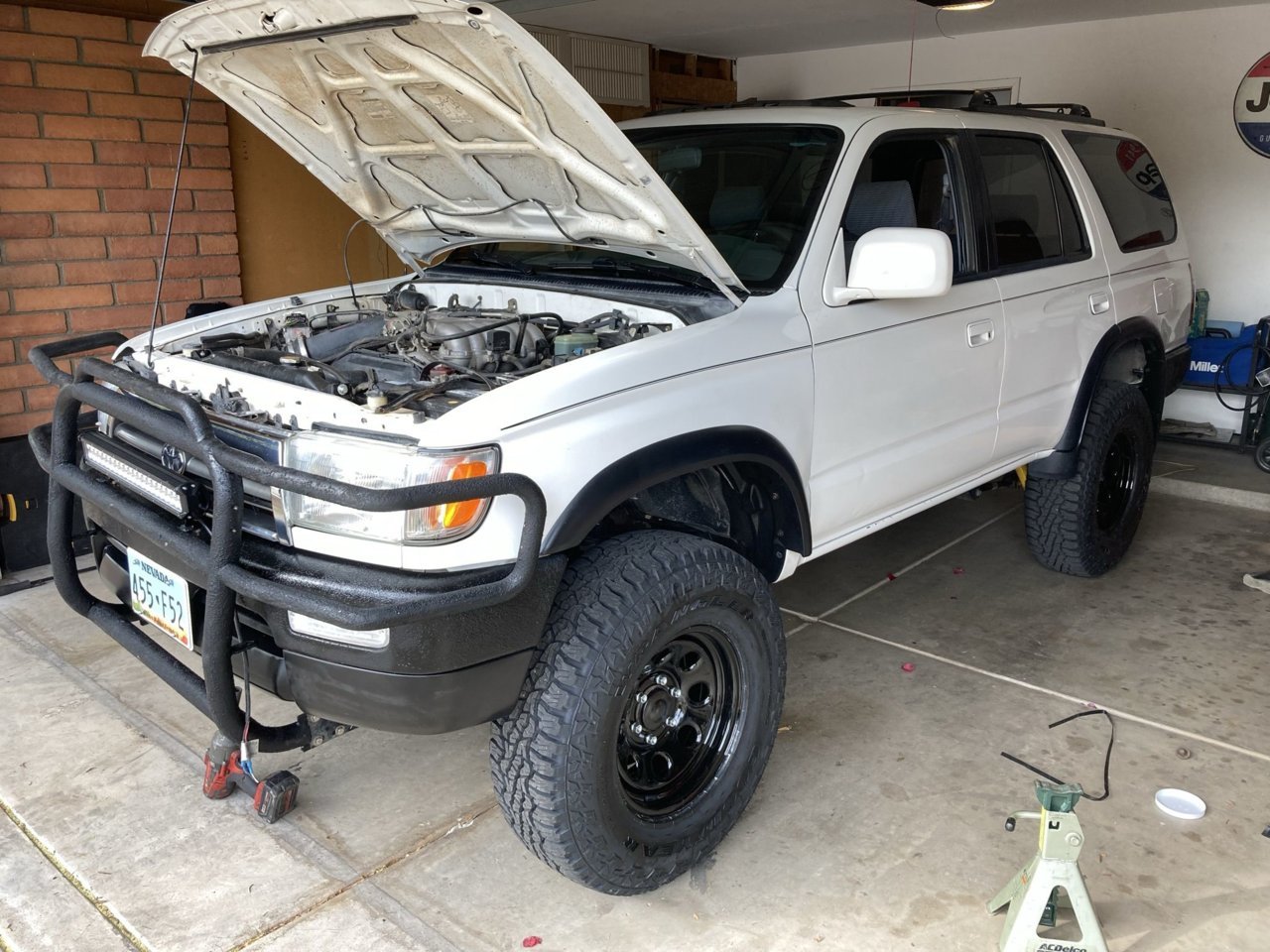

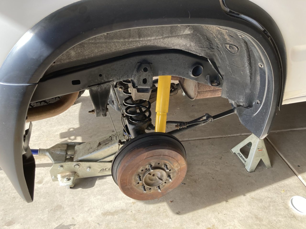

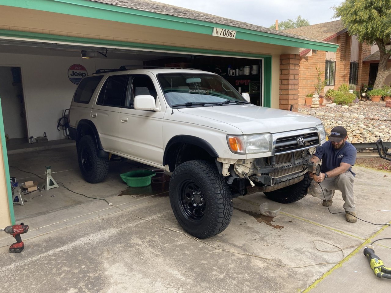

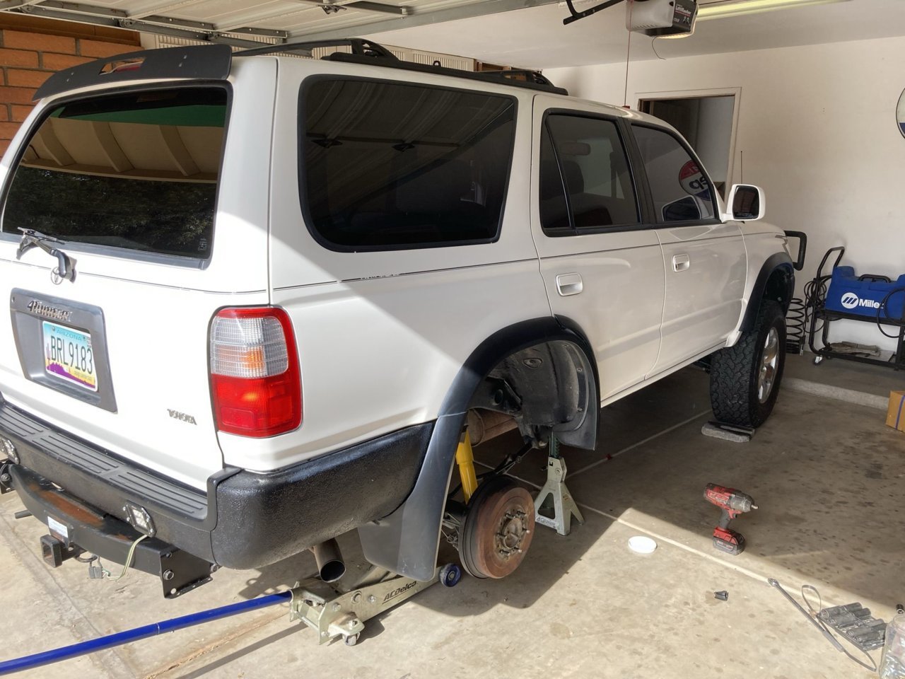

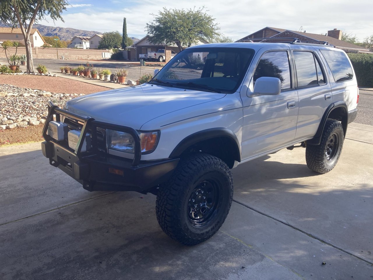

    It took us a total of three hours to get the lift kit on, a major improvement from the two days when I put the spacer lift on! With the lift on it was time to rip off the old bull bar and start to install the ARB.

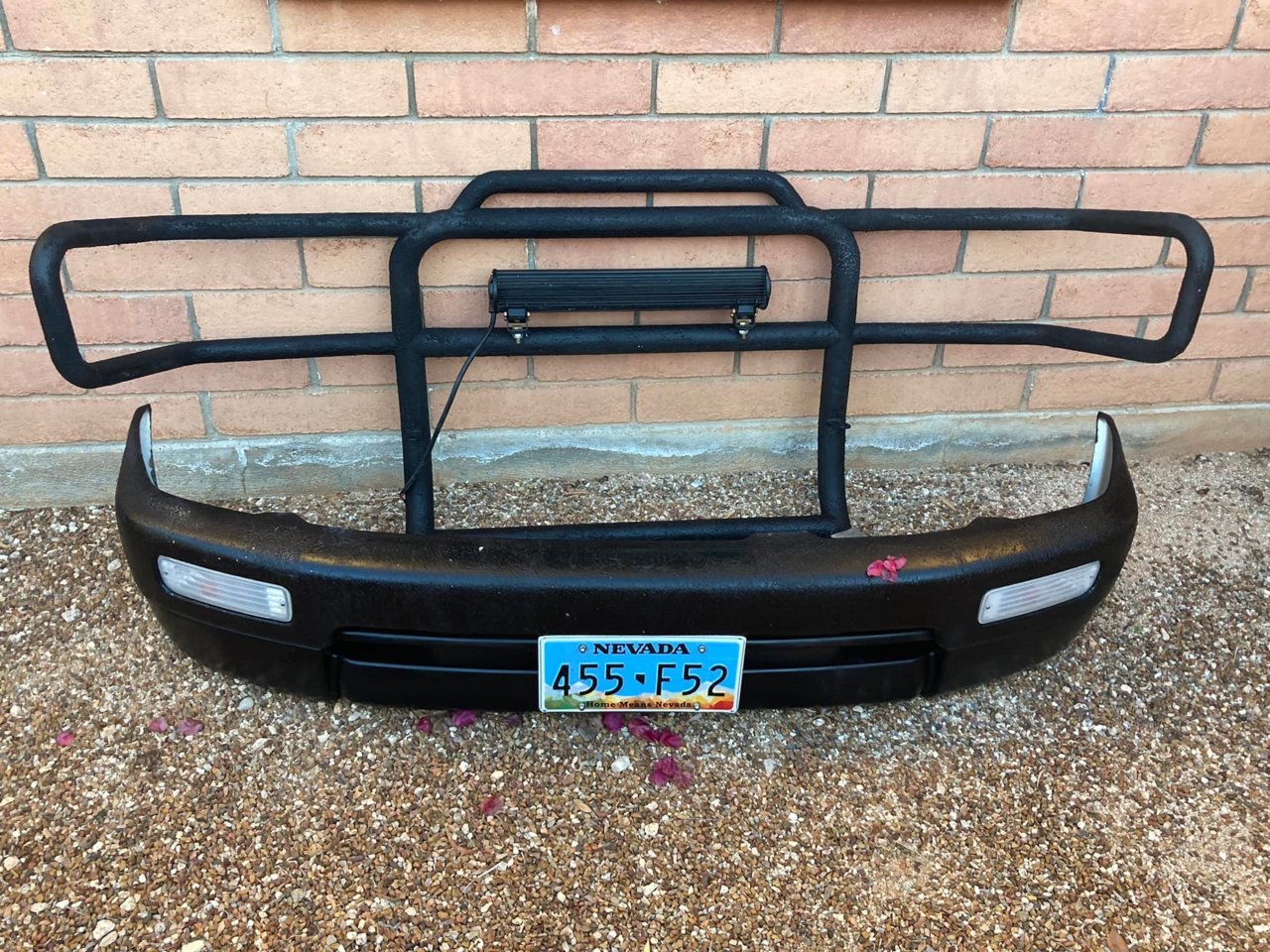

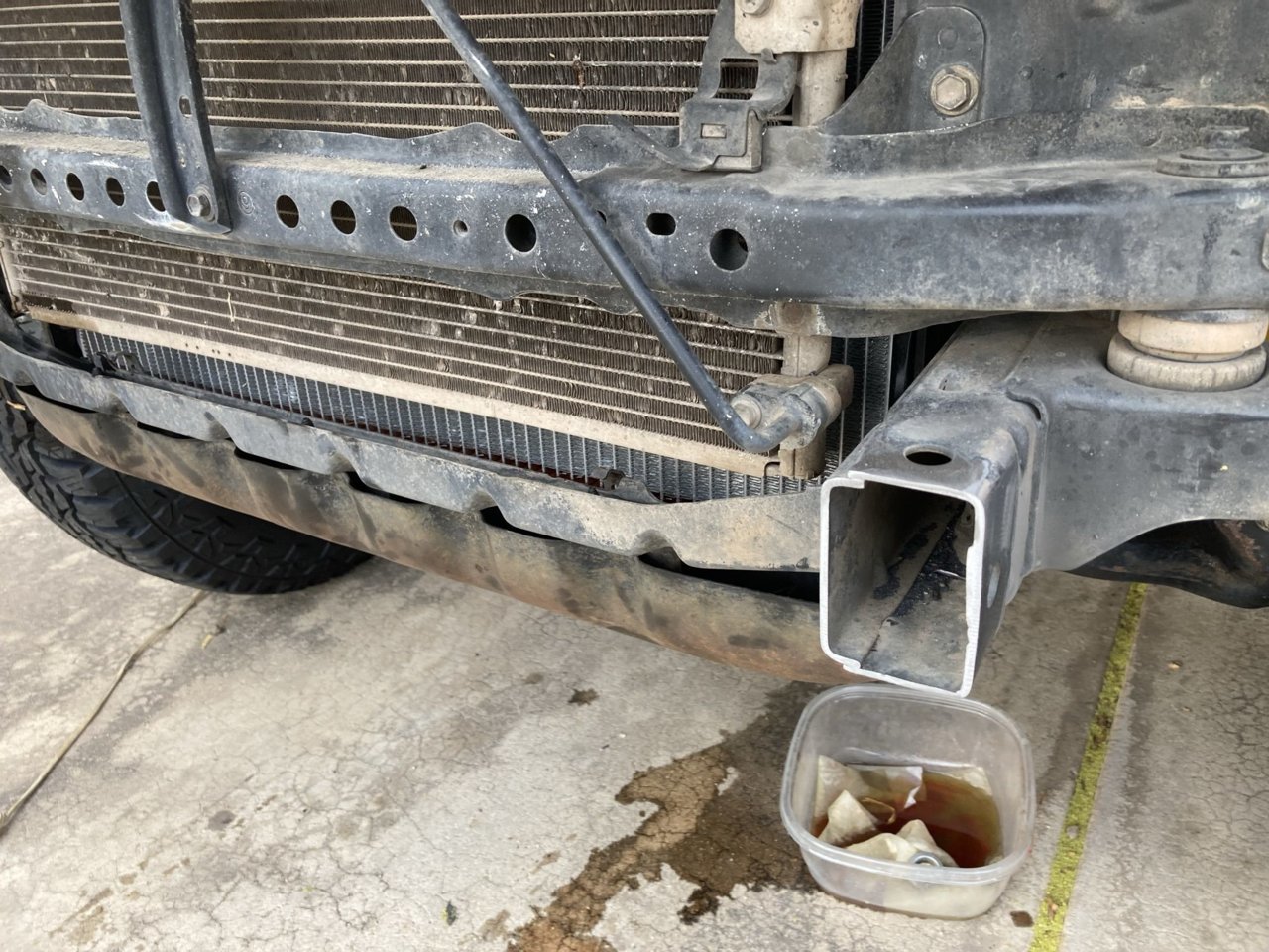

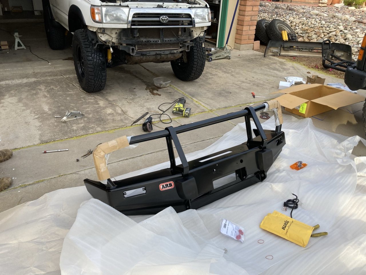

    Unfortunately for us somewhere along the way someone had welded the bullbar bracket to the frame and then a bolt to that. It was one hell of a task to get it off which also resulted in the sawzall blade bouncing off the bolt right into the radiator.
    With it and the stock bumper off it was time to cut the frame rails to make room for the ARB bumper!

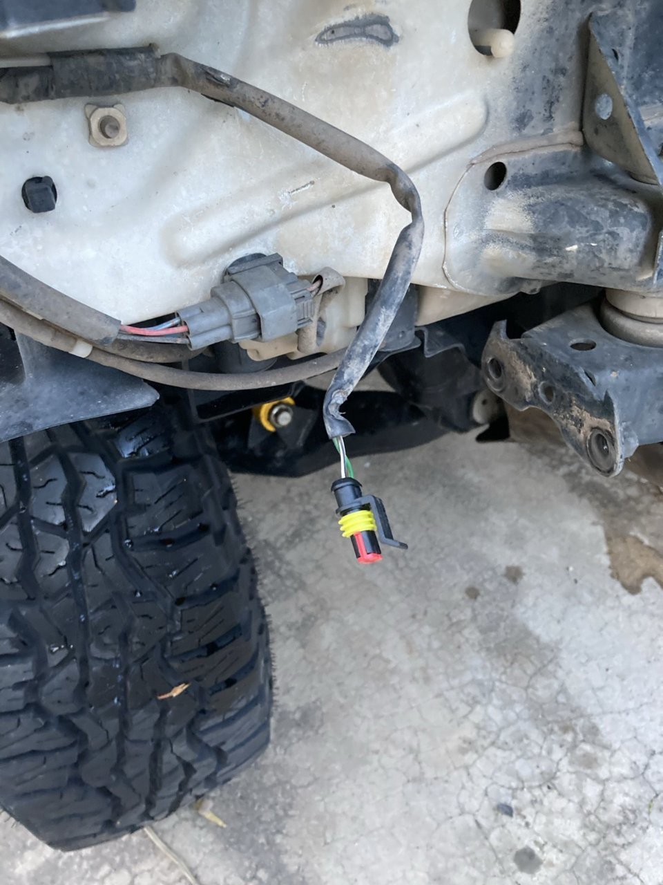

    While my brother and law painted the frame rails, I re-wired the chinsey plastic connectors for the turn signals with some nice weatherproof ones
    We got the bumper on later that night and within one day she had undergone a complete transformation:

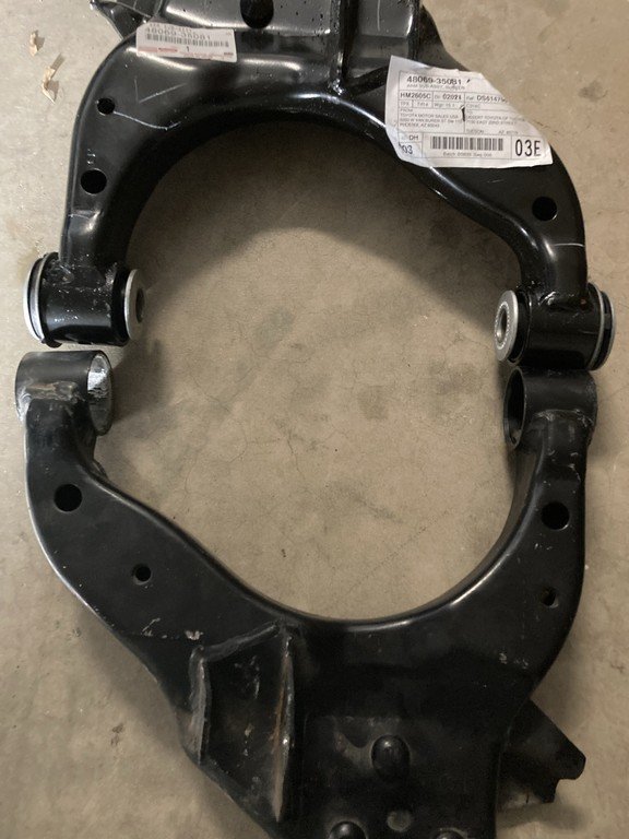

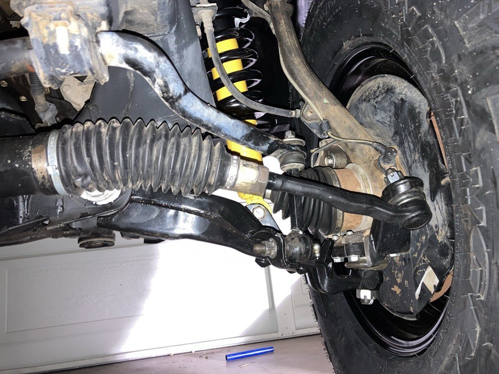

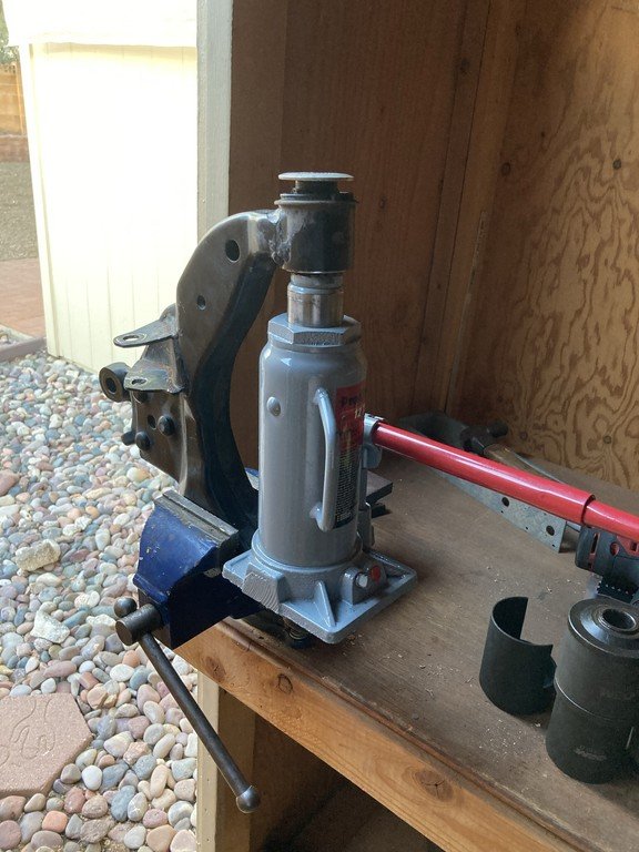

    Took a little bit of time today to press out the old bushings on my lower control arms. I don't have a press so I used the old bottle jack and heat method.
    I applied very little pressure and a s***ton of heat. The first one came out like butter and the second one took a little more pressure but came out too. As I was getting ready to push my new bushings in I noticed that one of the welds on the control arm had bent.
    I measured the inside diameter of the other side and compared it to the one that I pressed and noticed it was off by a whopping 1/4"!
    So DON'T do this with crappy aftermarket lower control arms. Have them pressed out professionally or buy some used OEM ones. I was sick of messing with this so I bought OEM lowers with bushings already installed. While it hurt the wallet I feel WAY better about the quality of it over my old ones - definitely way heavier.
    Here you can see how bent the other one is:
    With the new lowers I was able to get them slapped in and set the camber decently. It'll be towed to the alignment shop but I think this finally wraps up my front end rebuild. Look at all these nice shiny parts in there!
    Really looking forward to seeing how well it drives now. It was extremely sketchy before with the bump steer so bad a pothole would send me in the other lane!

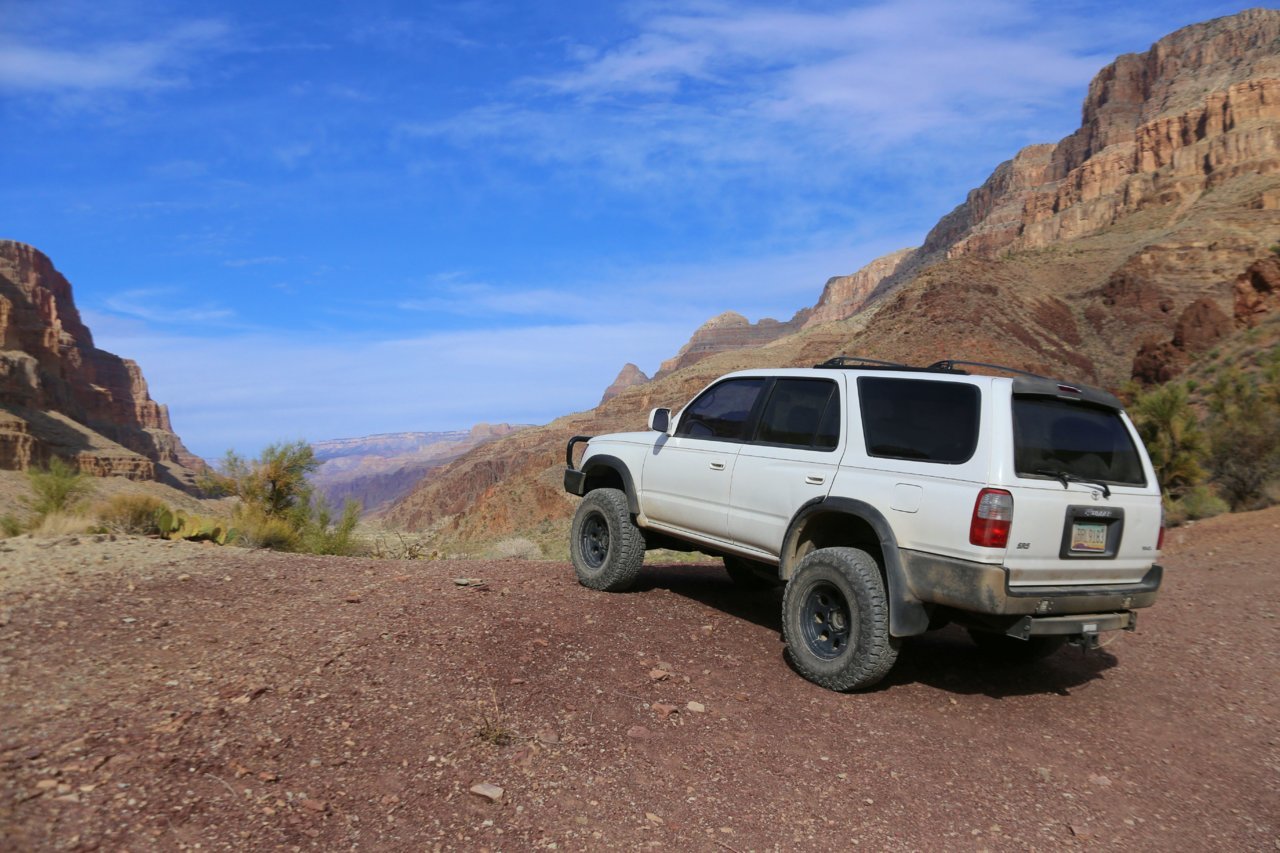

    In bigger news, I just completed a two day trip up to Flagstaff with a bunch of other rigs and had an awesome time! Camped the first night in the Cinders OHV area which is northeast of Flagstaff.
    Then we hit the highway to make our way to the Grand Canyon via Diamond Creek Road!

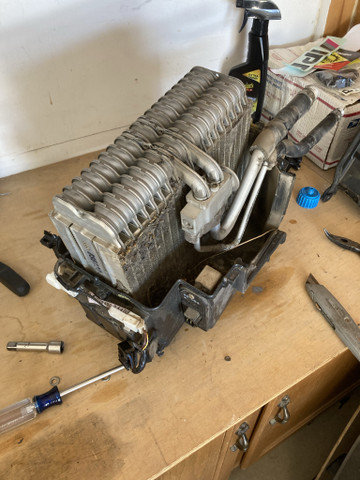

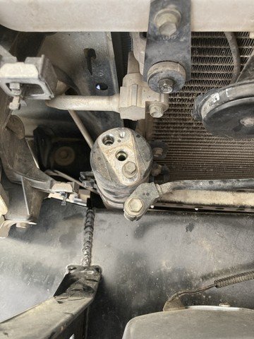

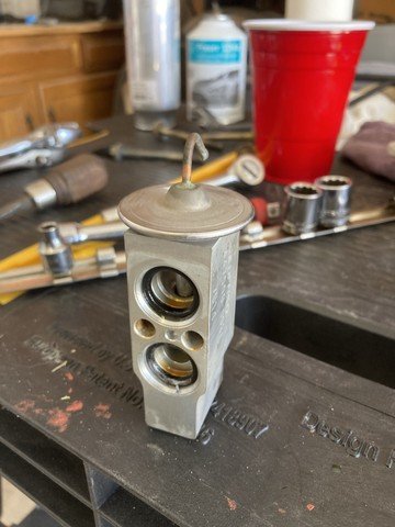

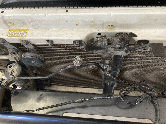

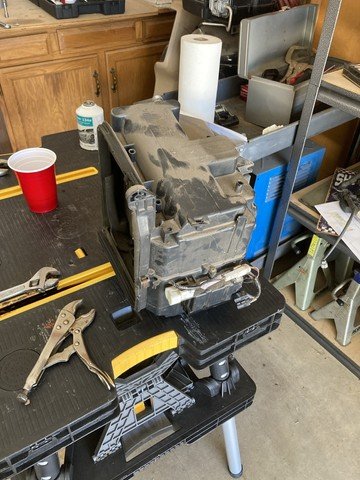

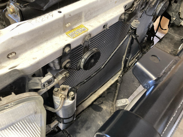

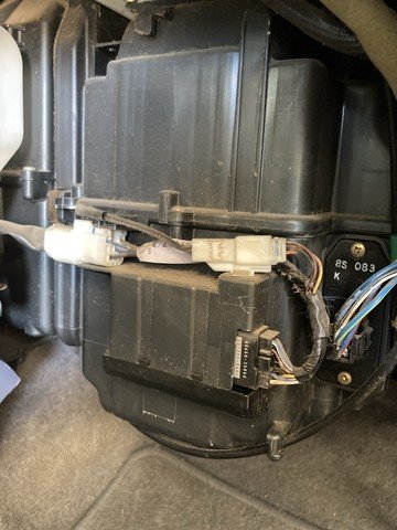

    On my way up to the Grand Canyon a few weeks ago - my A/C stopped working right outside of Phoenix. I was finally able to set some time aside to diagnose it and fix it this weekend.
    Hooked up my new A/C gauges and the high side reading was unbelievably high – hanging around 400 PSI. Normal operation should be around 150-250 so this indicated I either had a blockage in the system or my expansion valve had failed. Given the fact that my A/C was intermittent beforehand I had a sneaking suspicion that my expansion valve had failed.
    Ultimately though, at 234k miles I decided to buy once cry once and get the whole system replaced. I bought a new Denso compressor, condenser & expansion valve along with a Dayco Idler pulley, A/C Delco Drier & a Murray evaporator. (Would’ve gone Denso on both of these but was short on time). Started disassembly on Saturday morning and would’ve been done that day had Amazon delivered my compressor on time. Nonetheless I got it on Sunday and wrapped it up. Here’s a few pics documenting my install:
    Pulling the evaporator:
    EwXuma_61a741a0883950a9075aa2220f7b19e84074ed11.jpgTuXTyh_c27d58c83ae86de2bc06007aa7632d89af2191b3.jpgmeiGBm_4f809c7531fe4defad827ef4f66e64572009fa86.jpg
    Man that thing was gross! Good thing I was replacing it anyway. Here's the failed expansion valve, along with the rusty bolts connecting it to the evaporator. I cleaned them up with a wire wheel before installing.
    bzcnzR_50c400497d67689a9b43e8a2c86d4e53ca6df491.jpgz1APsA_3208fb2435fe6f3a7bc0d3f3c4360389917ab43f.jpg
    New condenser & drier
    qMkQmv_c9951318cc1cf954f5d0db2f3f17f3ce38a60c17.jpgTrNxh4_250231483640887337b2db787d626c80e6bd9ab2.jpg
    I don't have any pictures of installing the compressor, but I found it really easy to remove. Everywhere I read online said you should remove the PS pump to get to it. I'm happy to report that you do NOT have to remove the PS pump! Disconnect your transmission cooling lines (don't have any since I have a manual) and remove the two 12mm bolts holding the power steering hard lines in place. Once you've done that the compressor can come right out the bottom. This made the removal/install much easier.
    All in all the job was not very difficult at all and the results are fantastic - my truck now has a alternative use as a freezer.

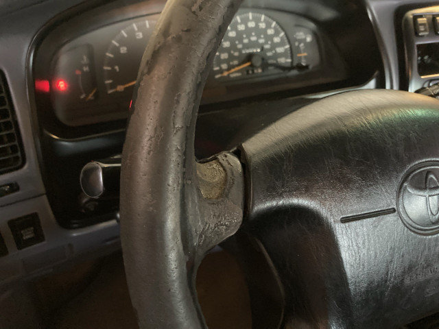

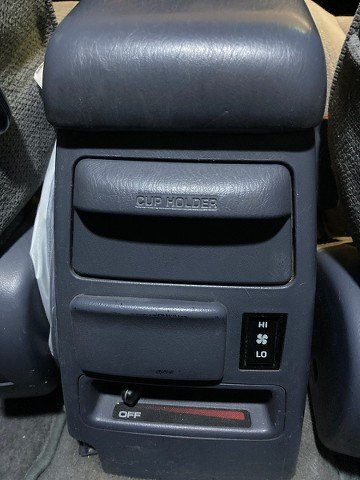

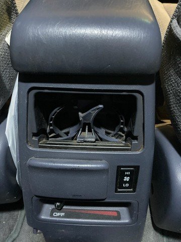

    Now that the A/C is buttoned up I'm starting to focus my efforts on the interior again. The old leather steering wheel has been disintegrating from the sun long before I sold it and it was time to get it replaced. Definitely feels weird having a new one on there but way overdue!
    Before:
    After:
    It feels like a brand new car again! I still need to buy a new middle console lid (which is still available from Toyota) and some new center air vents as one of mine is busted.

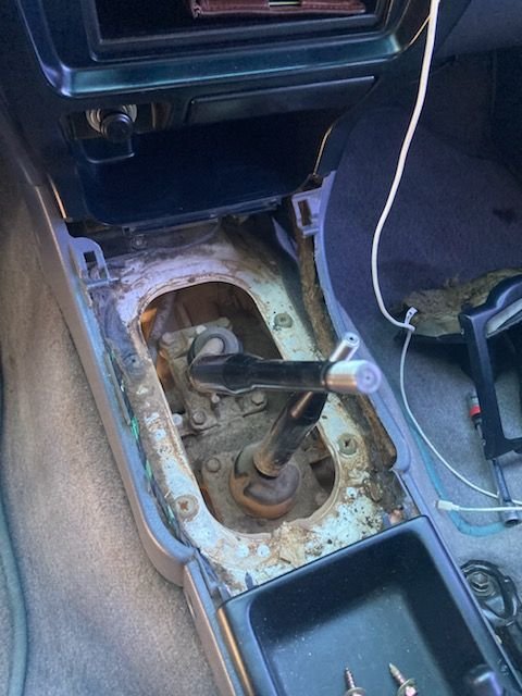

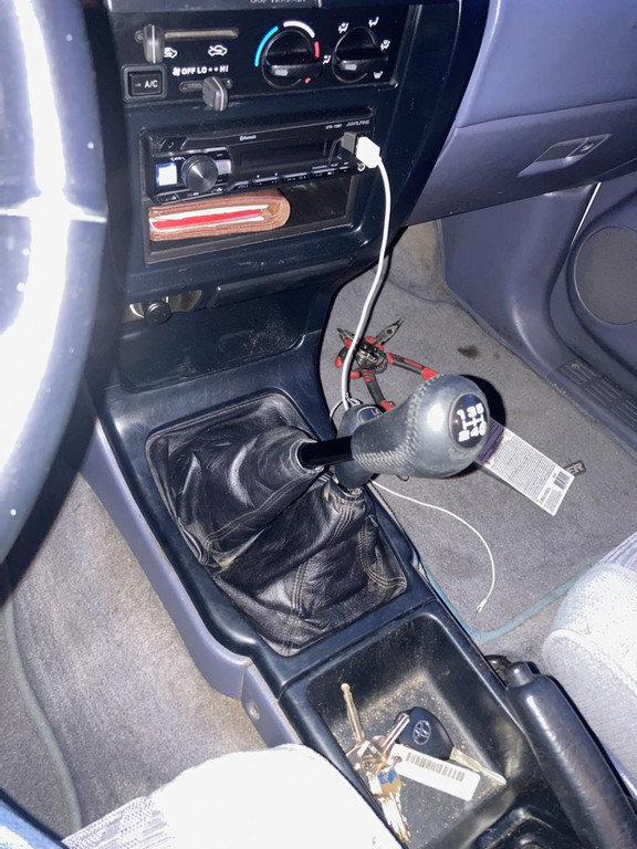

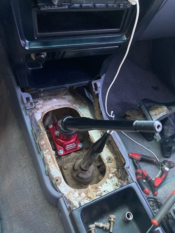

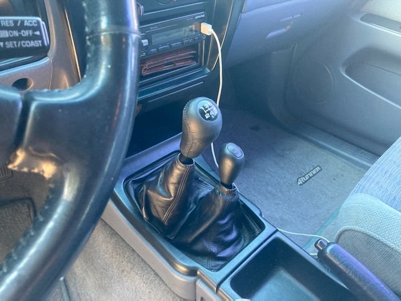

    Bought the Marlin short shifter kit last week and got it installed:
    51pxkM_2824f1e9add22061feb77bb26effa9da719485e8.jpgBBO8U8_323f6b794a624df426d37bf4f2f396c8022316fd.jpg
    Loved the way it shifted but absolutely hated how much taller the shifter was
    So I took it to a machine shop and got it cut back down to factory size and now it's perfect!

    What was the first polished bush-guard or bull-bar that you had on in the early stages? It is so simple and elegant, I have been scrubbing everywhere to try to find something like that.

    Honestly couldn't tell you! I got it on craigslist used for like $80 back in the day. It was actually still on the truck when I got it back but it was rhinolined pretty badly. I sold it to a guy I knew so I could have him check to see if there was any manufacturer name on it if that helps.
    Get your truck done and get a build thread going man!
    Edit - Here's a better pic of it if it helps you find one!
