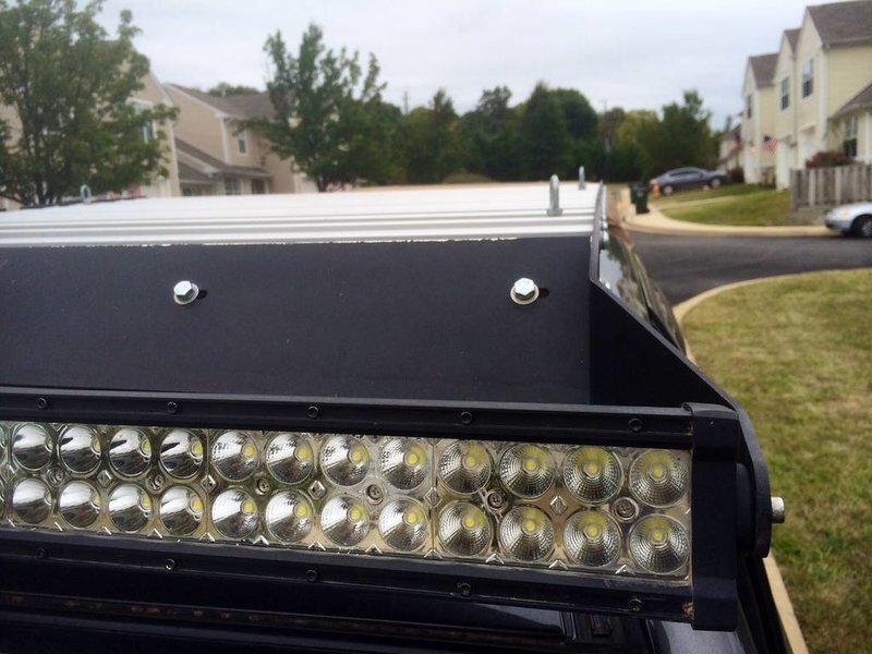

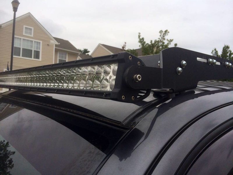

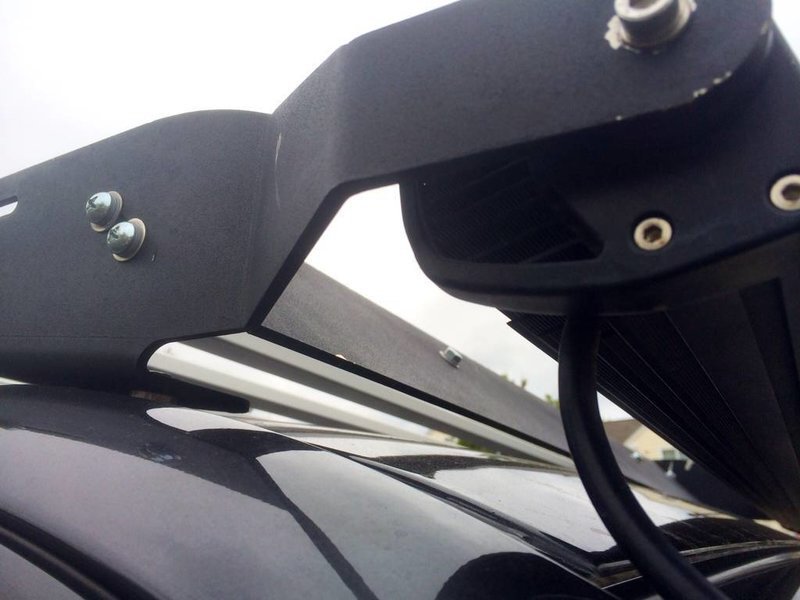

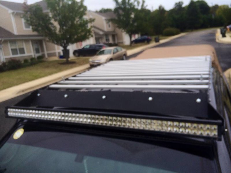

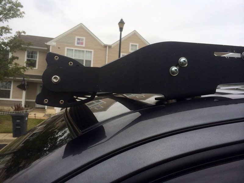

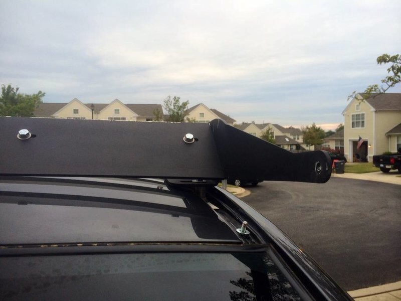

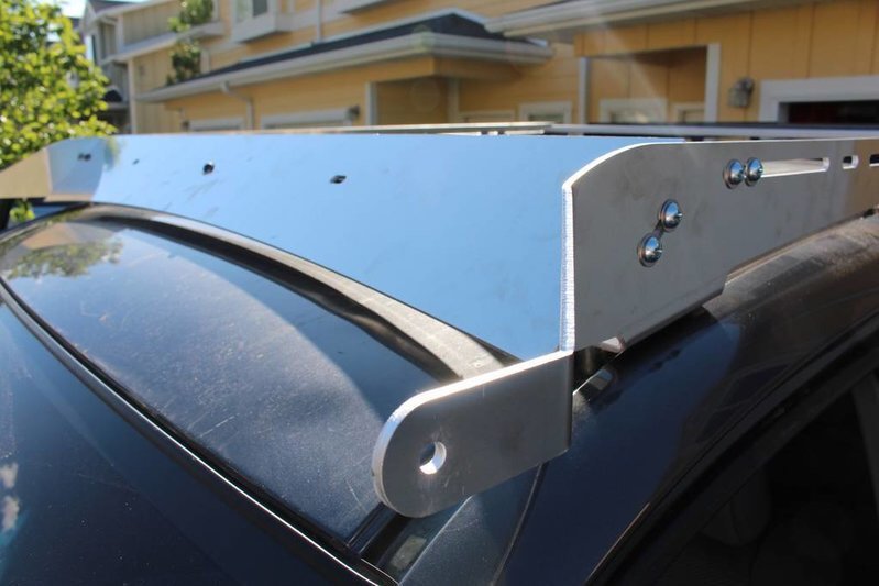

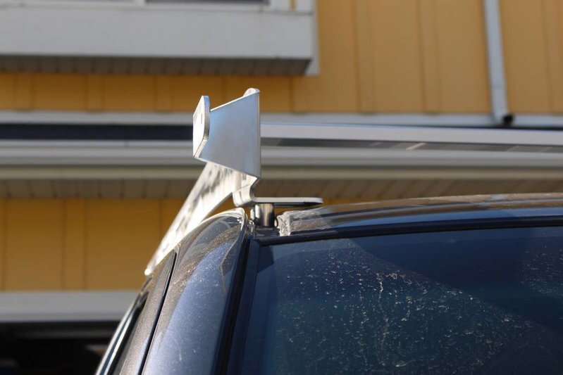

    How to install a Heretic Studios Wraith light bar on your PRINSU rack -
    If you purchased a Heretic Studios Wraith Series Lightbar from us, we provide custom mounting brackets. They work as shown in the following pictures.
    How to install a Heretic Studios LITE light bar on your PRINSU rack -
    These are the light bars that Heretic Manufactured in 2014 and part of 2015. In 2015 they switched to the new wraith series. The LITE series bars came with larger brackets and I found that the best way to mount the bars to the rack was to turn the mounts towards the rear of the lightbar and bolt them directly to the front crossbar which is turned vertical.

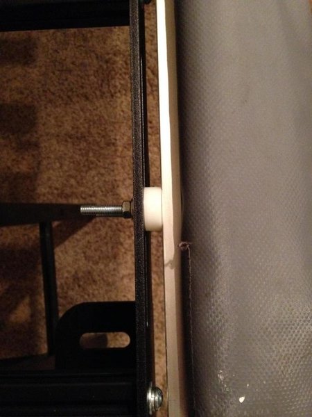

    OPTION 2
    @DoorDing offers up the next option for mounting Maxtrax.
    Instead of drilling holes in the crossbars he created a mounting platform out of 1/4" polycarbonate. This platform gives you as much space as necessary to drill the holes and mount the pins for maxtrax.
    The poly carbonate was bolted to the racks using machine screws countersunk in the poly carbonate and hex bolts which secure into TSLOT nut anchors in the crossbar top channel.

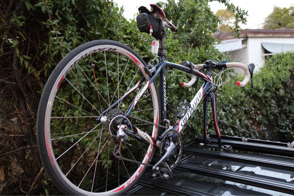

    How to mount bike carriers, snowboard carriers, and other thule/yakima type accesories to your rack.
    Most modern accessories are built to fit a variety of crossbar sizes and shapes and will bolt right to the rack. If not, most companies like yakima, thule, or rhino make adapters. If all else fails, most accessories can be simply be bolted to the TSLOT channels.
    Thanks to @RileyLAFD for this example of how to mount a bike carrier.

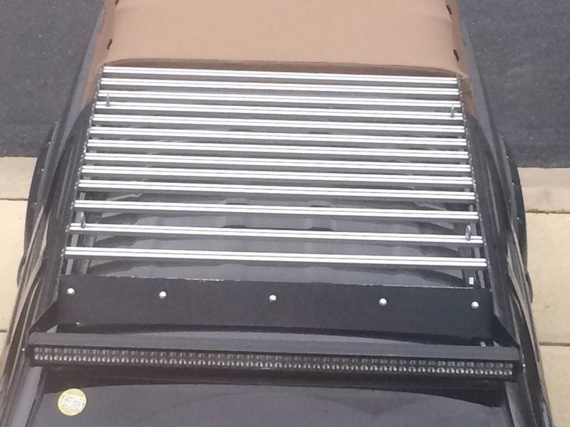

    Only reason I haven't bought this rack is cause I'm curious on mounting a 50" curved light bar... I already got the light bar so I just need to figure out how to put the light bar onto this... Any ideas?
    Jaab likes this.
  15. Mar 9, 2016 at 4:06 AM
    geekhouse23
    geekhouse23 The "Liftman" - @DrFunker
    Jul 14, 2013
    #108251
    15,680
    2GMGMDCSB4WDTRDFTMFW!! TL;DR
    mostly stock, grocery gettin' Prius
    Something like this?

    That's beautiful! How?
    ramonortiz55 likes this.
  17. Mar 9, 2016 at 4:42 AM
    #17
    geekhouse23
    Jul 14, 2013
    #108251
    15,680
    That's @FMF who requested it from Zach
