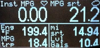

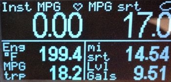

    Trip to work #1, jiggle valve at 2 o'clock:
    Trip home, jiggle valve at 2 o'clock:

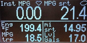

    Trip to work #2, jiggle valve at 2 o'clock:
    Trip to work #3, jiggle valve at 2 o'clock:

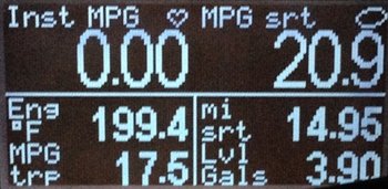

    Trip to work #4, jiggle valve at 2 o'clock:
    OK, so are you convinced that my truck runs at 199.4°F yet? I hope so. :)

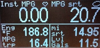

    Trip to work yesterday morning, jiggle valve at 6 o'clock:

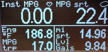

    Trip to work this morning, jiggle valve at 6 o'clock:
    What I think has been too much of a focus in the arguments regarding this is the jiggle valve itself. Is it really the jiggle valve that has anything to do with the difference in temperature? Or is it merely the position of the thermostat itself, and the jiggle valve just happens to be what the FSM uses as a reference to make it easy for the installer?
    Perhaps with the thermostat in this position, it creates the highest flow and the least turbulence as water rushes through, regardless of the jiggle valve.
