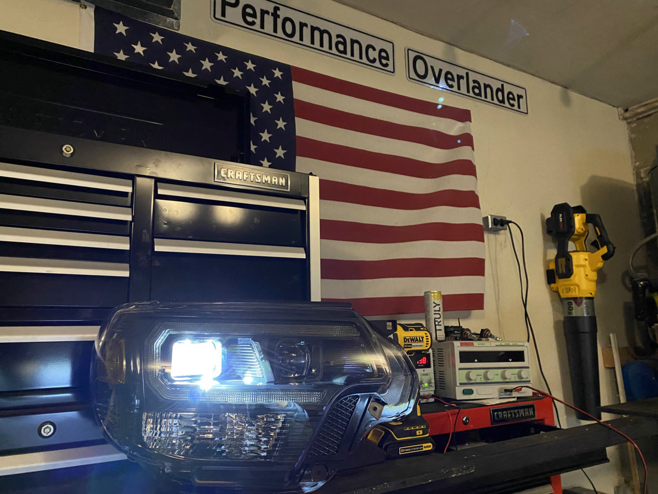

    Running lights
    Running light power draw
    Combined running light + corner marker pulls 3.3w.
    Ignore intensity as the distance is not standardized. But note color temp.

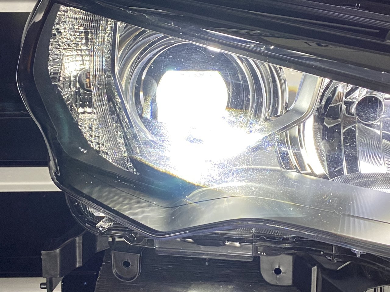

    The running light/DRLs are ~5500k like most Morimotos products, but unlike the headlight LEDs in these assemblies.
    Hard to photograph but the headlight output is definitely 7000k blue and does not match the 5500k DRLs.

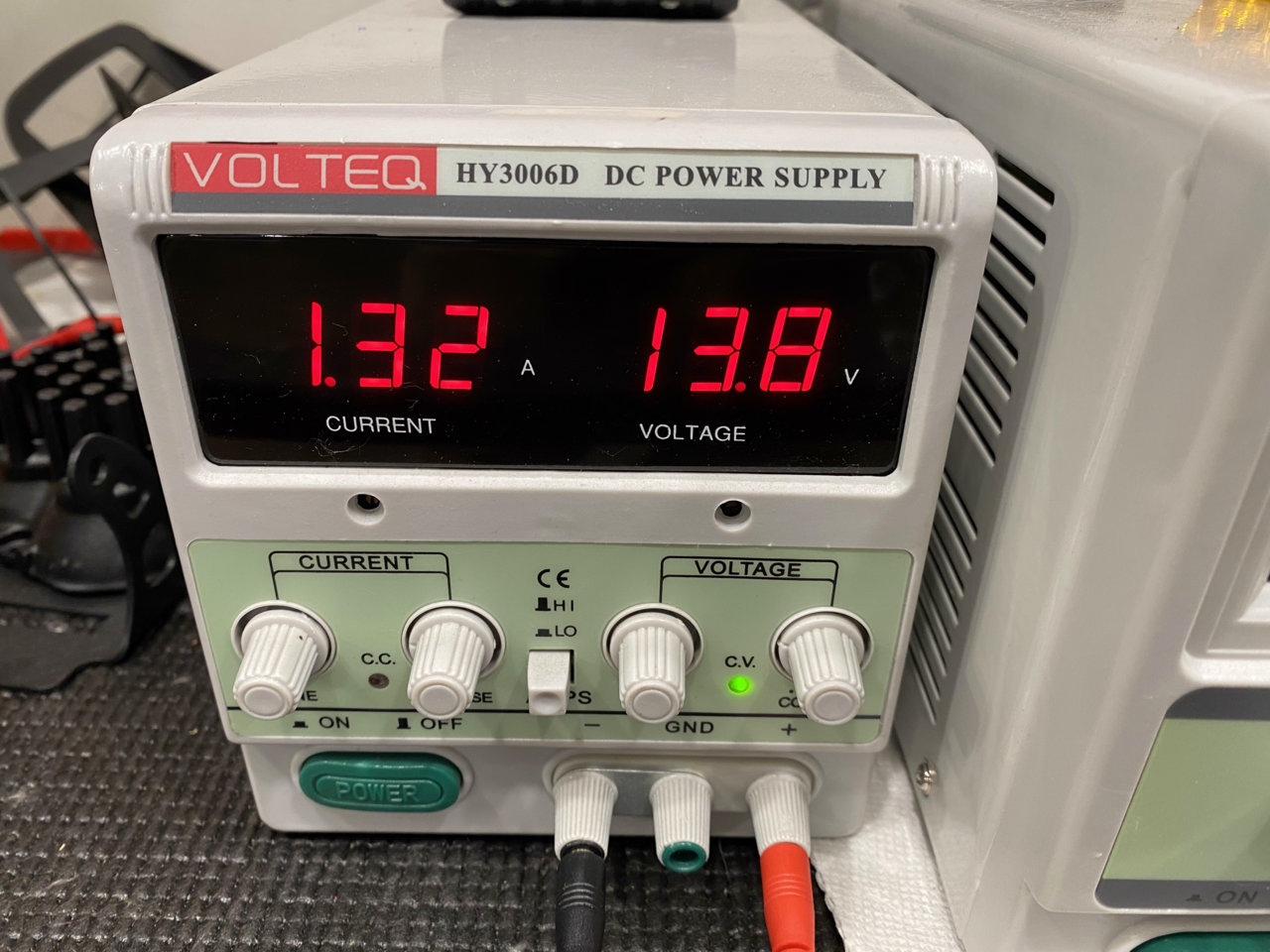

    The DRL pulls an impressive 26.8w. These are very bright. The camera was having issues with artifacts in the photo due to their intensity.

    DRLs
    Interestingly the corner marker is tied to the same circuit as the DRL.
    Combined DRL + corner marker pulls 3.3w. I don’t have a lot of data for DRLs, the JW Speaker J3 headlight DRLs I run pull 5.4w in DRL alone for comparison.
    The DRLs are ~5500k like most Morimotos products, but unlike the headlight LEDs in these assemblies.

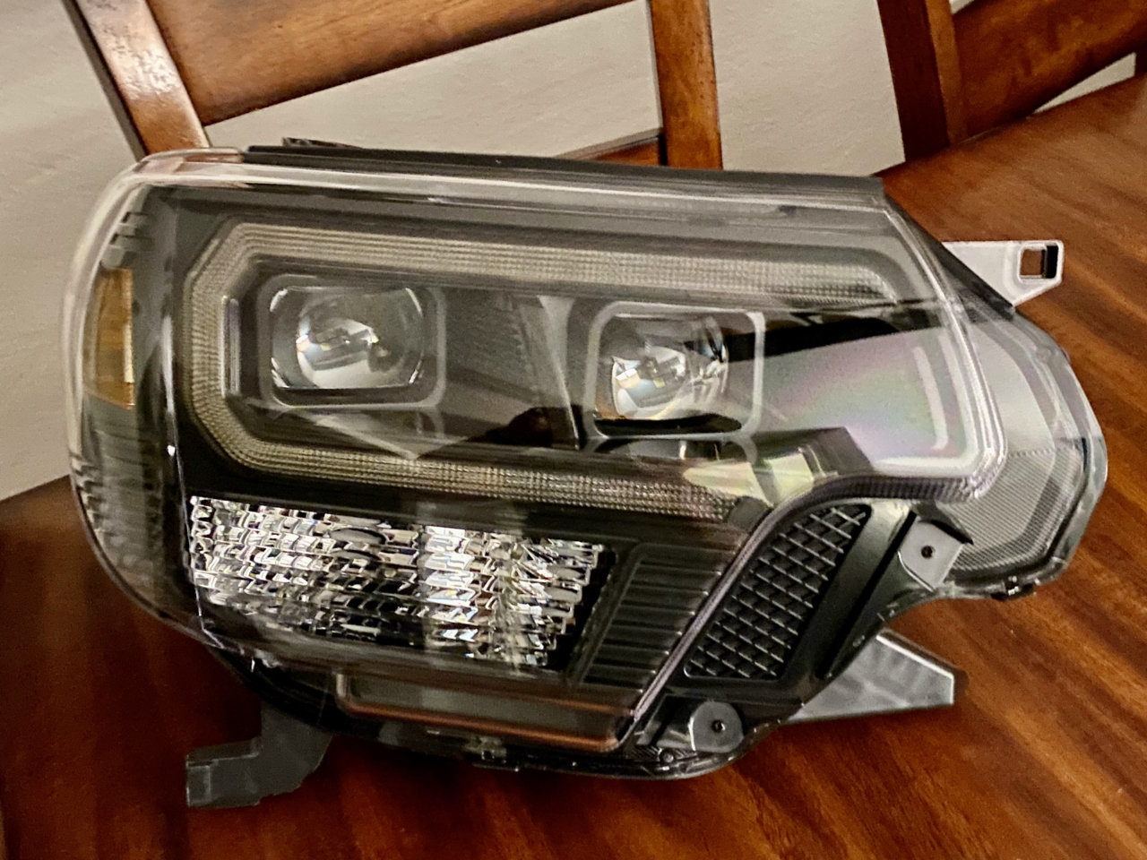

    I know this is a terrible pic, but my corner marker light is definitely not tied in to my DRL. Now maybe that is different on the amber version, not sure.

    Strange. These white units were in the first batch available, amber did come out a bit later. Hard to say if something changed or that is unique to amber. But on mine the side markers come on with the DRL.
