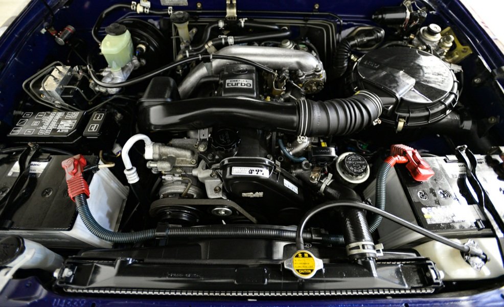

    1996 Toyota Hilux Surf SSR-G 5 speed manual (3rd gen)
    Motor is the 1KZ-TE 3.0l Turbo Diesel non intercooled with dual batteries
    Finished in stellar blue over grey two tone with 127,000 KM (~79,000 miles)
    Power windows, power locks, and even power mirrors which is all factory. Even comes with a rear retractable mirror from the spoiler before rear cameras were a thing. There's also an "Idle Up" button that raises the RPMs to about 2,000
    The interior is near spotless
    It's 4wd, however with a center locking diff can be switched to similar AWD, 4hi and 4lo
    Came stock with Bridgestone wheels (yes wheels, didn't know they made wheels) and Wild Peak H/T tires.

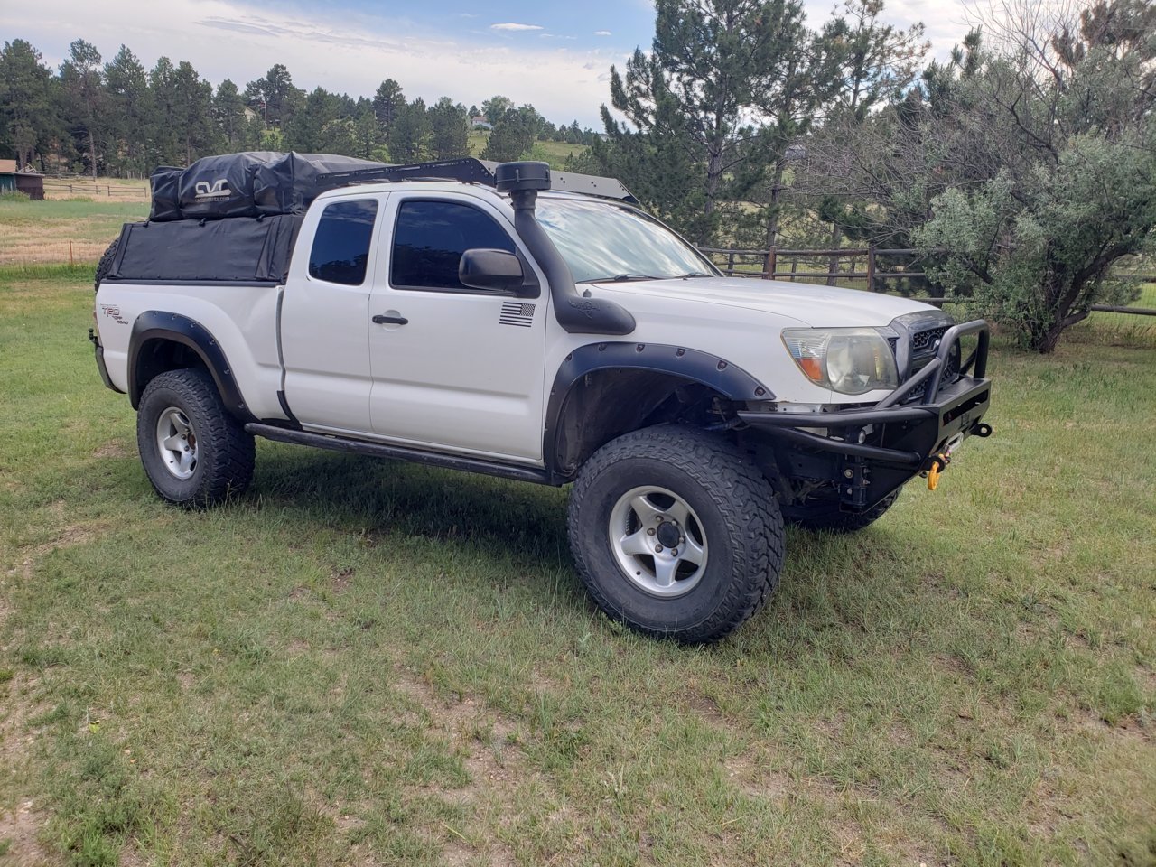

    First thing I did was swap my original non replica TRD Trail Teams wheels from the Tacoma. Kept the tires with each other since the Tacoma was on 35s, they wouldn't come close to fitting on the Surf. Maybe one day I'll make that leap.
    Delivery day:
    Wheel/tire swap:
    The Tacoma looked hideous with those. She has since been sold :(

    Over the summer I test drove some long distance 70+ MPH drives. Noticed that after about 2 hours the temps would start to climb and the AC would auto shut off
    After some research, seems the viscous fan can lose silicon oil which causes the speed to of the fan to change and in turn doesn't keep the engine cool enough. Toyota makes replacement oil, however only available overseas for $30 bucks a tube which would require 3, plus the pricey shipping
    I was a bit skeptical this would solve the issue being this is a non-intercooled engine
    So I found some 10000 CST oil used for differentials in R/C cars for about 7 bucks
    I pulled the fan and shroud out and took the hub apart using an impact screwdriver to loosen the bolts. The inside was pretty dry. Filled it up with the silicon oil and sure enough, after a few drives there was no more overheating issues.
    Future plans is to throw in a larger radiator, and possibly find the intercooler for this engine.
