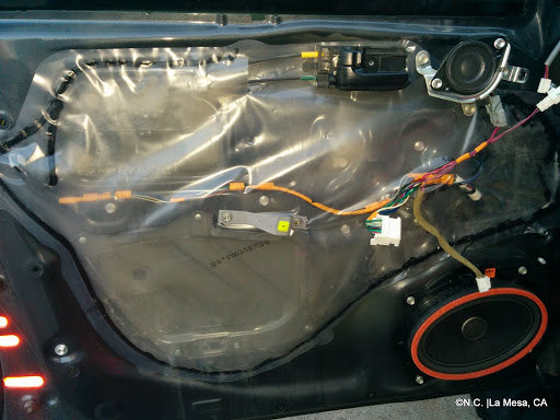

    My next few objectives with the truck are to:
    1. Fix my manual door lock in the drivers door .
    2. Install sound deadner / blocker in drivers door.
    3. Finish installing sound deadner / blocker rear cab back wall.
    4. Hard mount ARB Air compressor behind pass seat.

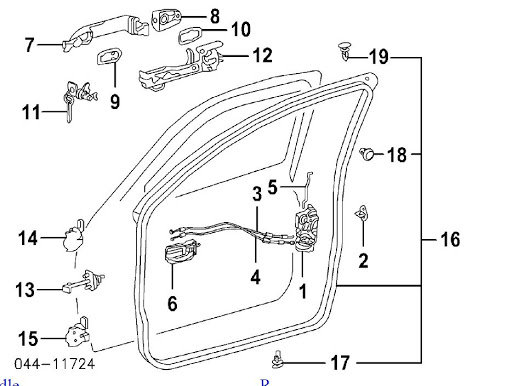

    Last night I took my drivers side door apart. So easy now. :D Took less than 5 minutes with my kids with me in the drivers seat. :)
    When inspecting the manual door lock switch, it appears to work normal. For example: when the switch is moved, the cable (yellow), still attached moves with it. This must mean that the cable has detached from the latch mechanism, or the cable itself has gone bad. :(
    Items of interest.
    • Item 1, Latch Door, 69320-04040 - $86
    • Item 6, Handle Inside, 69205-02100-B1 - $27
    • Item 3 Cable, Inside Locking, 69750-04020 - $18

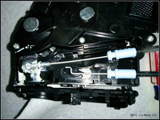

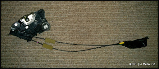

    Repairing the Tacoma Door Actuator
    If your plan is to own the Tacoma long term, this repair may be in your future. Here is how I fixed mine. :)
    I was lucky and was able to fix mine for no out of pocket costs. In my case the door lock switch cable separated internally from the actuator. The solution was to compleletly remove items 1,3,4,5,6, from the door, repair on work bench and reinstall everything.
    • Item 5 handle rod connector

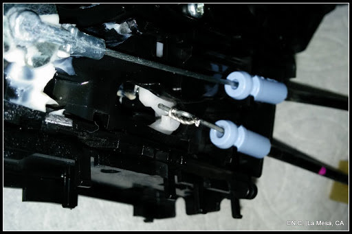

    Here it is all removed from the door.
    Swing open hinged service door, the cable on the bottom is not attached and needs to reattach to restore manual door lock switch.
    Solution: Wire wrapped cable to white plastic.
    Close hinged service door, and test manual lock switch. Test confirmed good. Reinstall the whole assembly into door.
    I was under a ton of pressure to fix this in 30 minutes. I had to remove it, fix it and reinstall the whole thing as fast as possible, so I did what I thought was best given my time constraints. There may be a better way to fix this. Hopefully mine will last a long time.

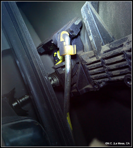

    How to remove door actuator for replacement or service. (will add pictures soon)
    As far as I know this isn't written up anywhere on TW. The best I found was a redirect to a Rav4 forum where someone posted pics of how to work on the door actuator.
    This writeup is for me as much as everyone else as I think I'll to repeat this procedure for the other doors in the future.
    Open door
    Remove interior panel
    Cut plastic weather barrier
    Unplug electrical plug from door actuator

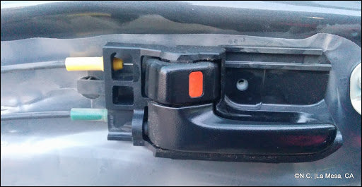

    Remove inside door handle by popping black molded plastic piece out of hole and slide handle backwards towards rear of truck (it's between the yellow and green below)
    Remove plastic shoe (service cover) from door edge.

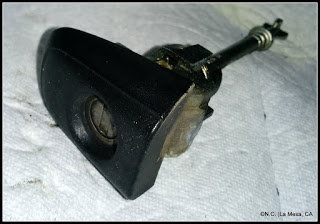

    Remove screw that holds lock into place.

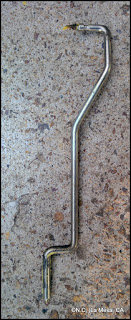

    Remove lock from outside of door.

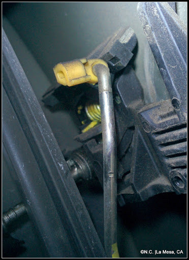

    Remove door handle connecting rod from inside door. Two part process!!!
    First, unlock the connecting rod by flipping up the yellow plastic connector.
    Second, Go back to service hole on door edge. Slip a long slot screwdriver into hole and rest screwdriver edge on rod, tap with dead blow hammer and rod will disengage.
    Remove door handle connecting rod from inside the door by pulling straight up and away from door actuator.
    Remove three screws from latch (door edge). The actuator will now be loose inside the door.
    Reach inside door and play a short game of tetris to remove door actuator assembly (with cables and inside handle) from door.
    Install in reverse order.

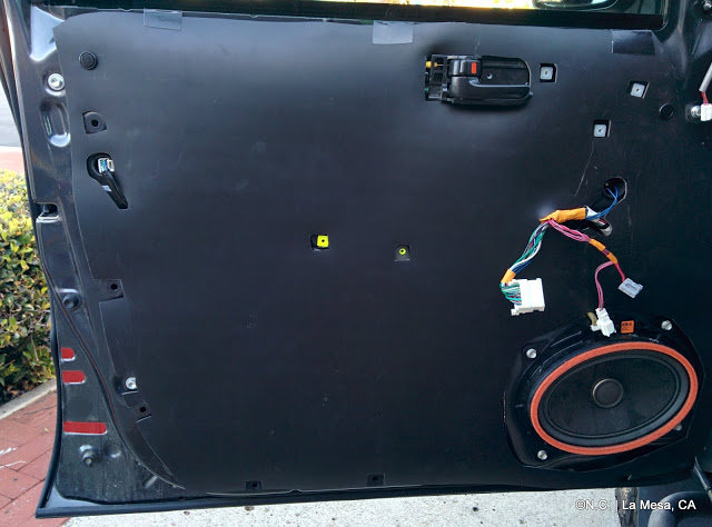

    Drivers door is finally done!
    I think I have six hours into it.
    After having done four doors, here is the process I like the most with the stated goal of blocking sound.
    1. Remove interior panel, trash plastic weather barrier.
    2. Clean the door skin with water, rubbing alcohol.
    3. Deaden outer skin with 100% coverage with butyl mat.
    4. Frost King duct insulation 100% coverage over the butyl mat on outer skin.
    5. Clean and grease window lift motor gears, (optional)
    6. Seal holes on inner skin,
    7. Add some deadner mat on inner skin
    8. Add some foam on inner skin
    9. Hang Mass Loaded Vinyl (MLV) sound barrier.
    10. Trim down Styrofoam on interior panel.
    11. Replace interior panel.
    12. Done.

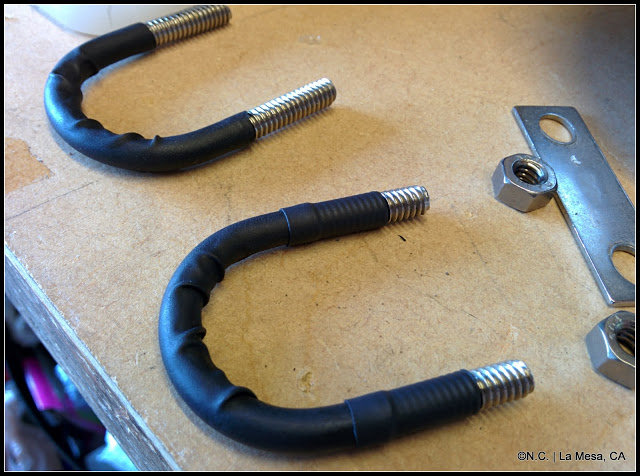

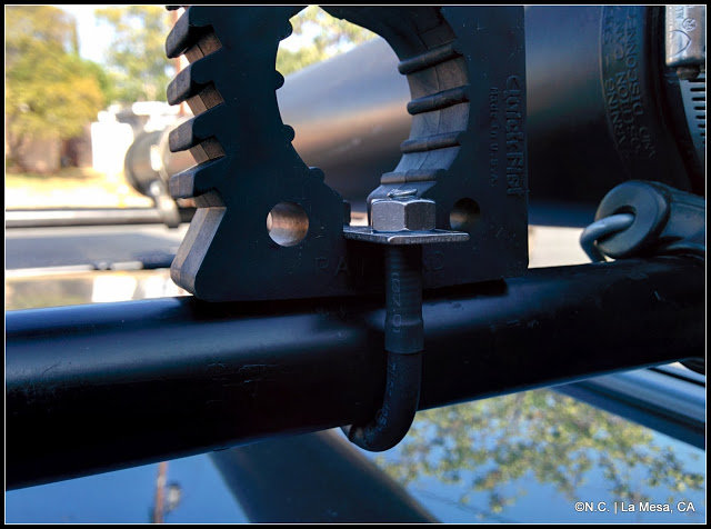

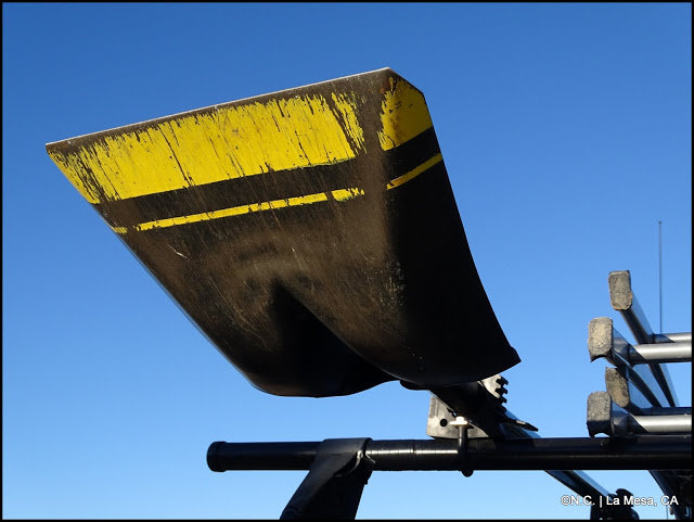

    Yakima roof rack crossbars, u-bolts, and quick-fists
    The argument for round bars vs. square bars rages on. The best argument I read in this debate is that in construction projects, whether commercial or residential, they use rectangular beams, and not round! lol How true!
    The two big names in roof rack Cargo systems are Yakima (round bars), and Thule (square bars).
    Since I ordered my shell from A.R.E., their package deal was with Yakima, so that's what I have, Yakima track system with round bars.
    The Yakima cargo bars are a specialty item, proprietary dimensions, no doubt, by design. I put a slide caliper on them and I measured:
    • Inside diameter of Yakima crossbar pipe is 21.8 millimeters .85 inches
    • Outside diameter of Yakima crossbar pipe is 1.12 inches or 28.5 millimeters
    Mounting objects to round bars is not always easy, but it's manageable.
    I found these stainless steel u-bolts that fit the bars pretty well.
    • Stanley Hardware V2193 1/4 x 1-1/8 x 3-1/2 U Bolt w/Plate & Hex Nuts in Stainless Steel, Model: S838-169
      • Metric 6mm x 29mm x 89mm
    What I do to make them look at fit nice is I put a bit of heat shrink tubing on them and then I measure them to the height I want, mark them, thread the nut all the way on, cut the bolt and then thread the nut off, which will correct the threads if they got a little messed up during cutting. It's a cheater way, but it has always worked. :)
    I use the u-bolts on hold on quick fists for mounting shovels, pry bar, etc.
    The Yakima crossbars themselves are hot dipped in vinyl at the factory. Yakima will tell you that the vinyl coating will break down in sunlight and wont last forever. I had one bar's coating split on me during the first year of ownership. I emailed them pics, and they shipped me new bars (warranty replacement). I set them in my garage and forgot about them. I just wrapped the cracks in the vinyl with electrical tape which has held up perfectly (zero maintenance fix). Two years later I found the warranty replacement bars in the unopened box from Yakima. I opened them up and the vinyl was split! Made overseas! :facepalm: lol
    Here is a link to a pic for you.
    I'm using a typical heavy duty rubber tarp strap. It goes around the ABS pipe, around the Yakima bars and then wraps around and secures behind the tarp strap itself with s-hooks. Similar to a hitch knot.
    The trap strap is backed up by stainless steel hose clamps. It's been on the truck for over 3-years, and only once did I have to maintenance it, and that was just tightening the screws on the hose clamps and squirting some thread locker into them.
